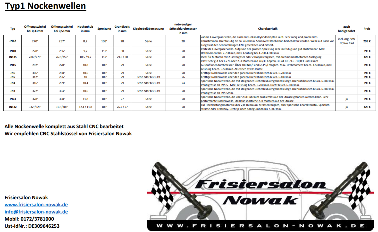

JN6
Total Duration: 306
LSA: 108
Lift at cam: .417
Duration at .050: 288
Lift with 1.1:1: .459
Lift with 1.3:1: .543
If you want more strip than street...go with the JN4

Not to be argumentative, but according to the chart at https://frisiersalon-nowak.de/produkte/nockenwellen/typ1, the lift on the JN6 at .51mm is 288 deg. .51mm is .020". It can't be 288 deg at both .020" and .050".
The JN5 measures 296 deg at .51mm and 258 deg at 1.27 mm (.050") according to the chart you posted.
I would assume that the JN6 has quite a bit less duration at 050" (1.27 mm).

I looked at the wrong column on the spreadsheet Shocked
261 at .050
288 at .020
237 at .100
136 at .300
txoval
Joined: January 23, 2004
Posts: 3838
Location: The Woodlands, TX
txoval is offline
PostPosted: Tue Dec 03, 2024 10:38 am    Post subject: Re: CNC Billet Steel Cam - Jurgen Nowak Reply with quote
JN5
312 total
296 at .020
258 at .050
226 at .100
120 at .300
58 Plastic Tub
Joined: September 03, 2007
Posts: 473
Location: Nowhere, USA
58 Plastic Tub is offline
PostPosted: Tue Dec 03, 2024 10:51 am    Post subject: Re: CNC Billet Steel Cam - Jurgen Nowak Reply with quote
Thanks.
Looks like the JN6 has faster ramps, but they still look a bit slower (45 deg difference between advertised and .050" duration) than the cams everybody likes (86b, etc.). An 86b has 38 deg difference between advertised and .050" duration, it's 54 deg on the JN5. Deviations like that always make me perk up -- they're curious to me.
... but I know just enough to be dangerous. I'm interested in some real-world feedback, and you gave us some on the JN5.
One of the reasons why Nowak cams need less spring pressure.

His cams are precise…no variation between lobes and numbers match as advertised.
Per his sheet, the JN5 and JN6 can be used with single HD springs. Oteva or just the outer VW650 spring
