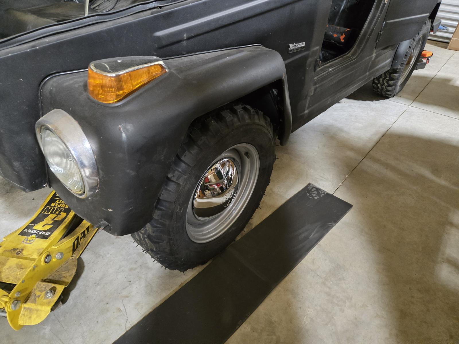

It's hard to tell from the photos but are these wheel nuts a cone seat or ball seat? (they appear to be cone seat type)
VW stock wheels use ball seat wheel nuts. Cone seat will 'sort of' work but be careful.
Those are not stock wheels.
Edit: I went back and looked. The spare had 45° but close examination appear that someone may have modded them. The rest are ball as you pointed out. Evil or Very Mad I ordered another set. I guess I will use these on my Toyota. Thanks for the reminder and to make me check.
Thanks to @germansupplyscott for seeing the obvious.
I relplaced the new nuts with the proper ball nuts.

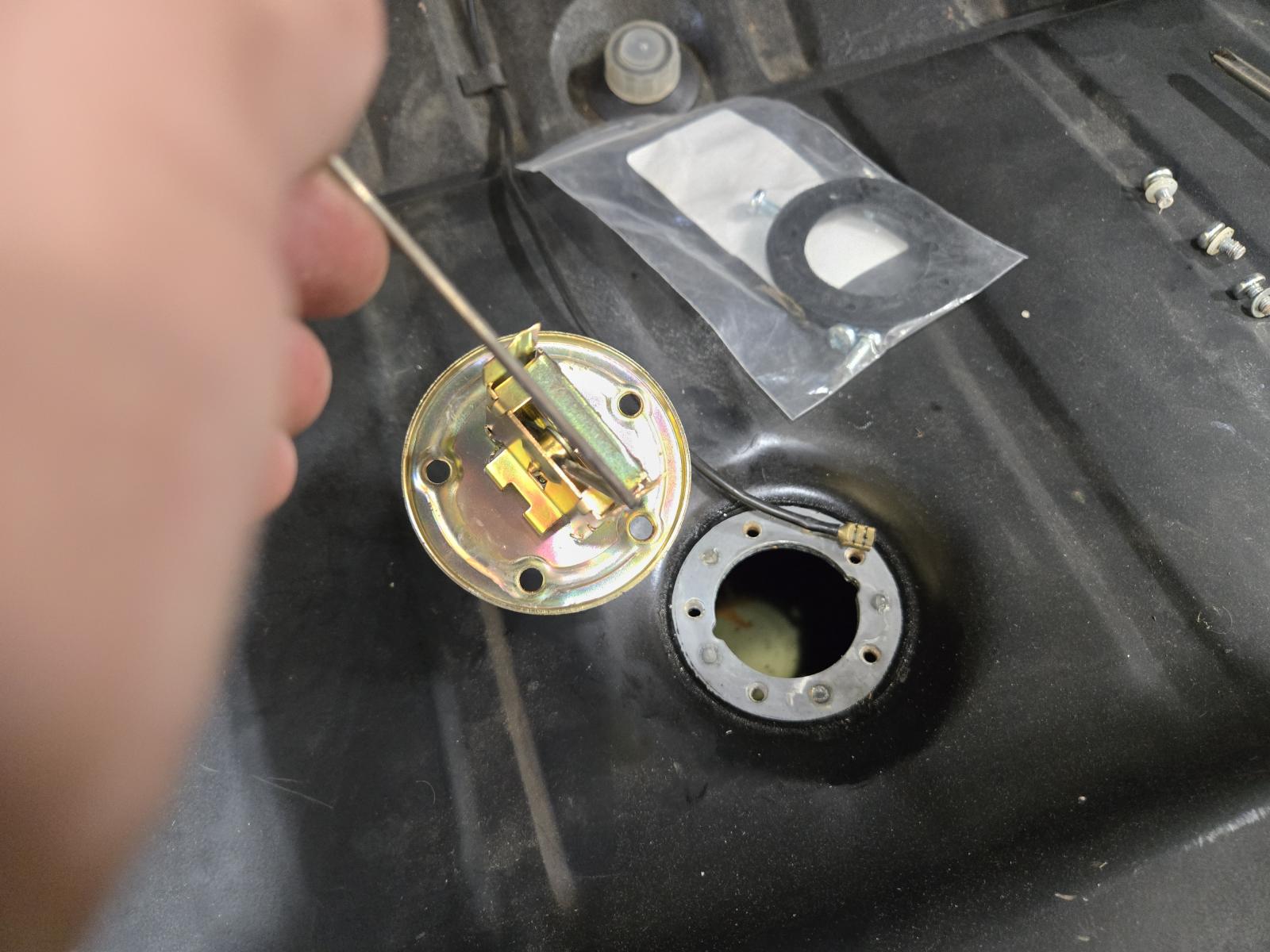

Replaced my electric fuel pump with a Holley with far less uga-duggas. Seems to have helped.
And I was smelling has in the frunk and had replaced all the fuel lines and filler. So Impulled the sender. Yeah - no gasket. Lol.
Fixed.

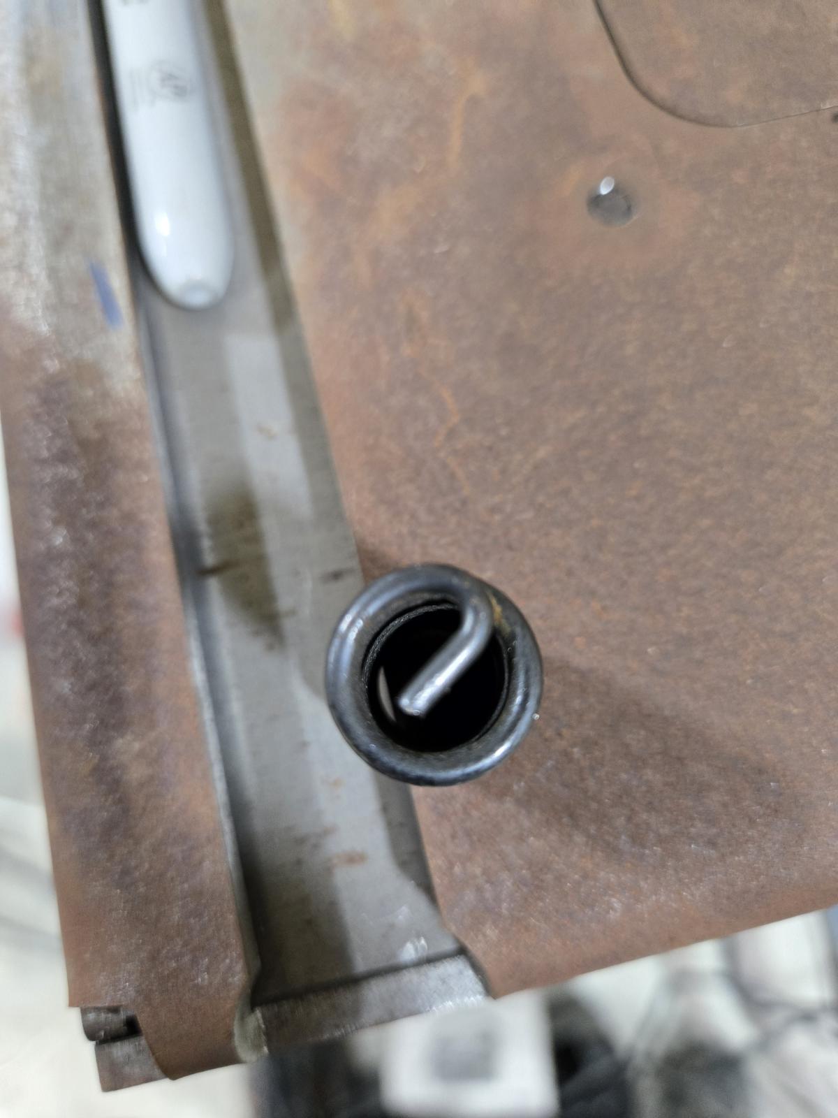

Now this looks like a PITA. I got seat rails but they for sure don't want to be where I need them to go. I am going to have to do some serious improvising here.
And although I have the passenger seat figured out, I can not find a spring that will do what I need it to. McMaster Carr does not have what I need. I.made one from a compression spring but discovered it would need to be twisted opposite the tension spring to work. I am going to go back to Ace armed with the compression spring I just made and see if theynhave any thatbhave a reverse twist.

Finished up the seat bottom today:
Got some black spray paint on there and will.let it get cured before I put them back together.
And also got these fine Ebay specials:
So now to get the seat slides mounted in the car which will need serious moding. Then get back to trying to get the carbs and timing tuned in.

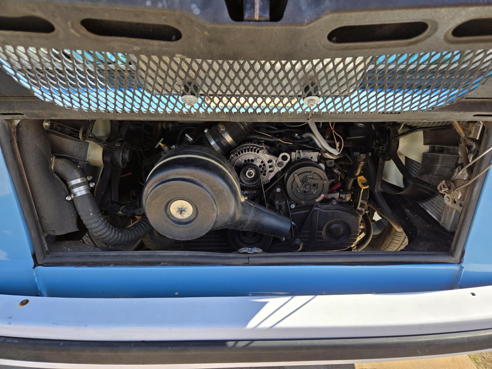

Howdy from the Wilmington, NC Brew Fest.
Sunboy had their '78 Type 2 powered by a 94 subaru.
