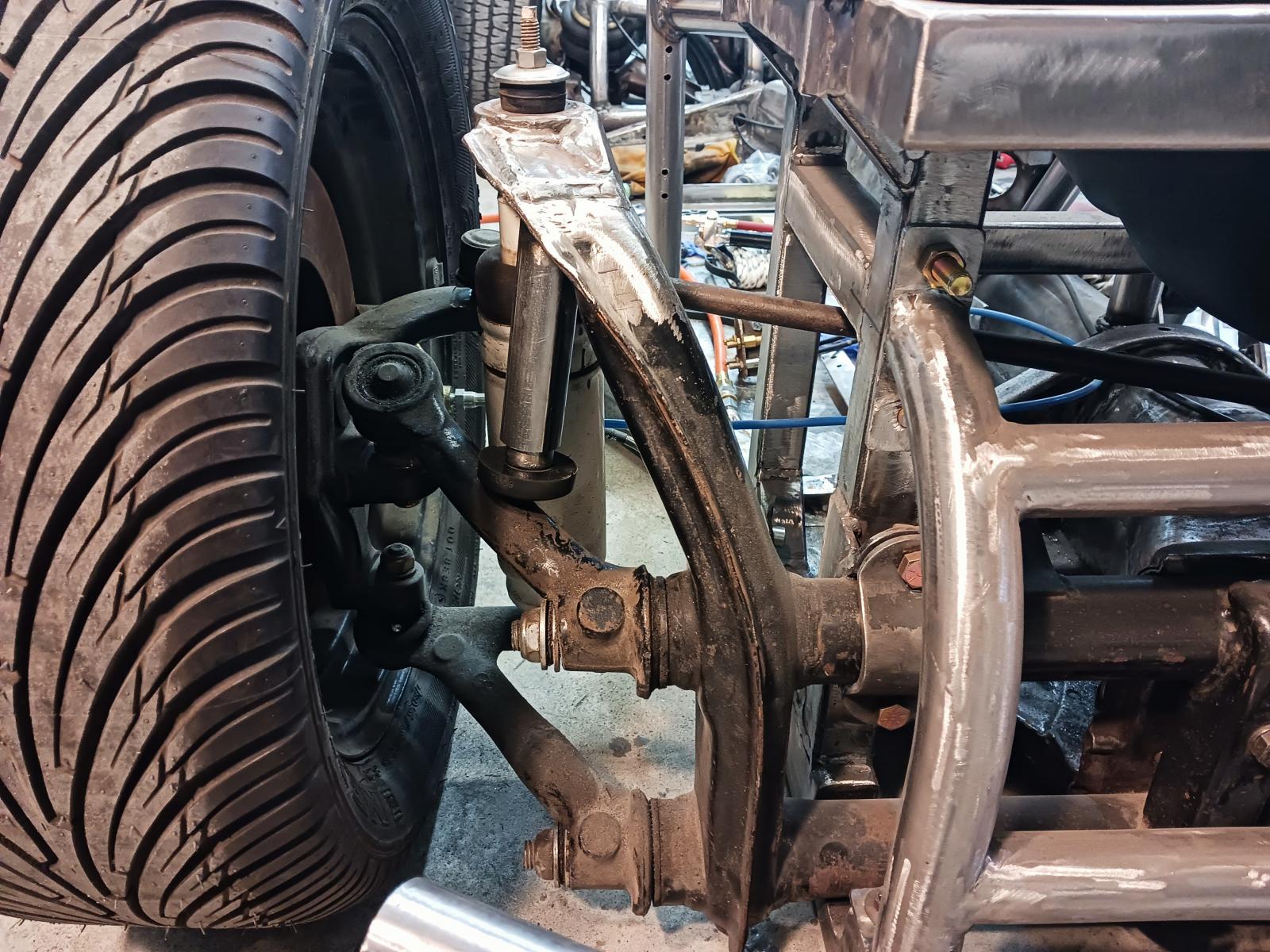

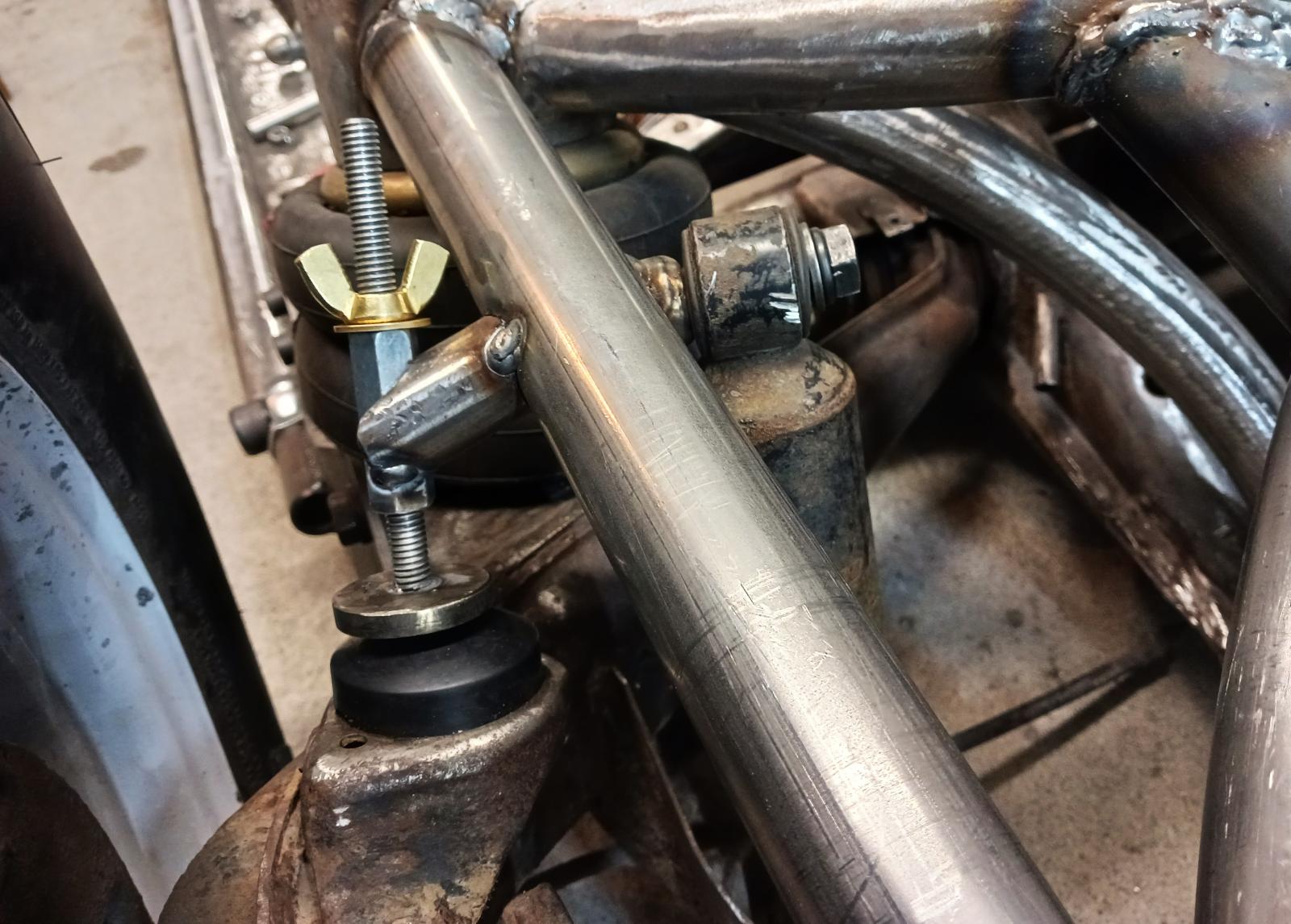

Here's the first of the adjustable bump stops from concept to completion. Next up will be the right side for shock mount and bump stop. I'm confident the car would have failed safety inspection if it couldn't have shown lockable road clearence of a couple of inches. With the pads dialed back it still lays on the ground. Picked up a set of Allen bolts for the spring plate deletes to match the huge one in the centre of the heim joint.

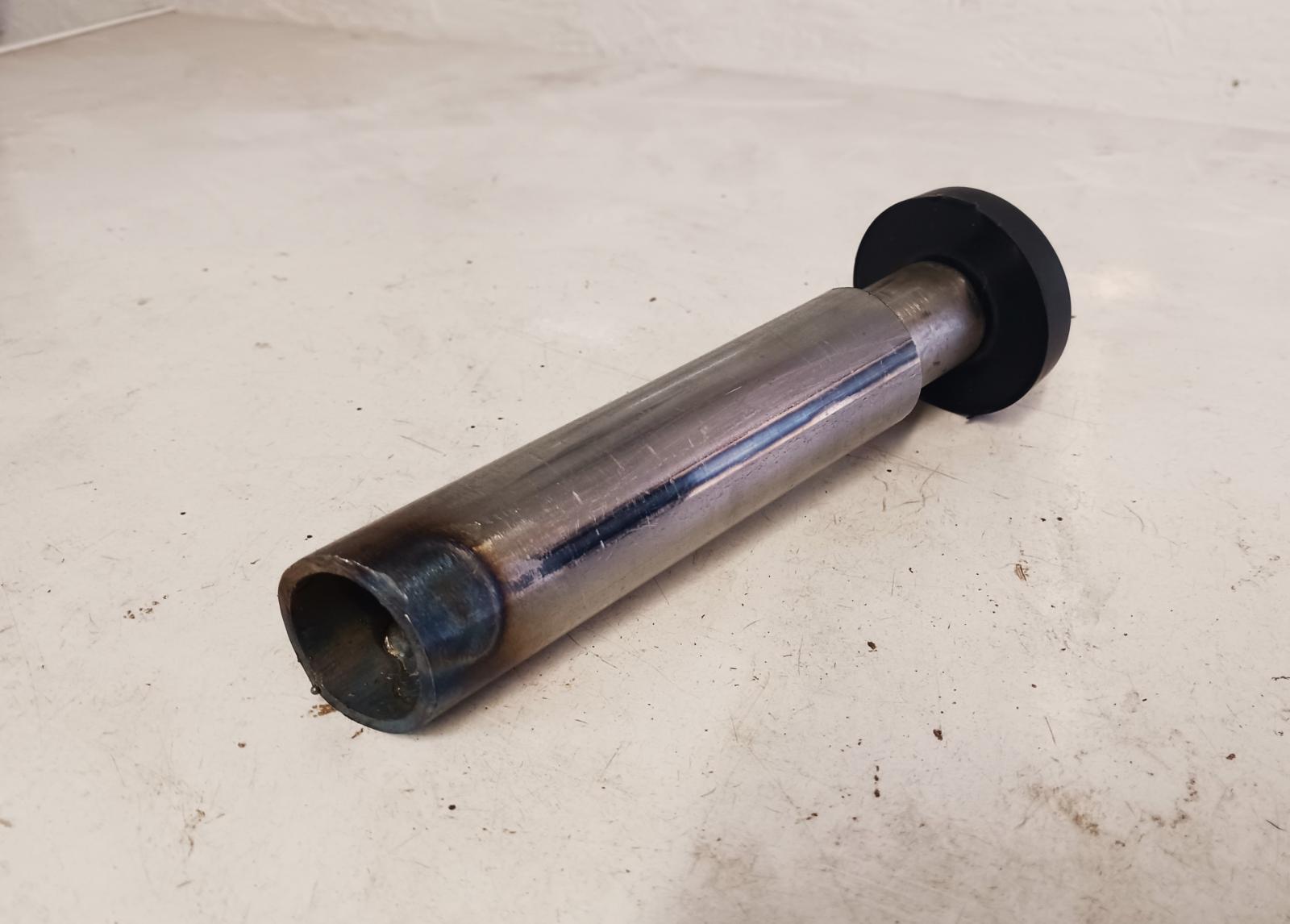

PostPosted: Sat Oct 19, 2024 3:43 pm    Post subject: Re: Low down Hillbilly Reply with quote
Adjustable bump stops for the front are in progress. There's an internal nyloc that should keep it in place without needing tools, just unscrew by hand to change the setting. Bracing to the beam will be added and once both sides are tacked together I'll pull the beam off and finish the rest. Next sub-project is to build a mini-rotisserie to finish off the work on the chassis. I'll have a much easier time grinding, welding and painting all over, not just the bottom. Finally, after much WD-40 & patience, I managed to get the rear trailing arm inner pivot bolts to free up and so will be redoing the arms and pressing in new bushings once the chassis has been elevated.
Soon, it'll be easy to dial in how much (if any) ground clearance I need, from zero to about 2"+.

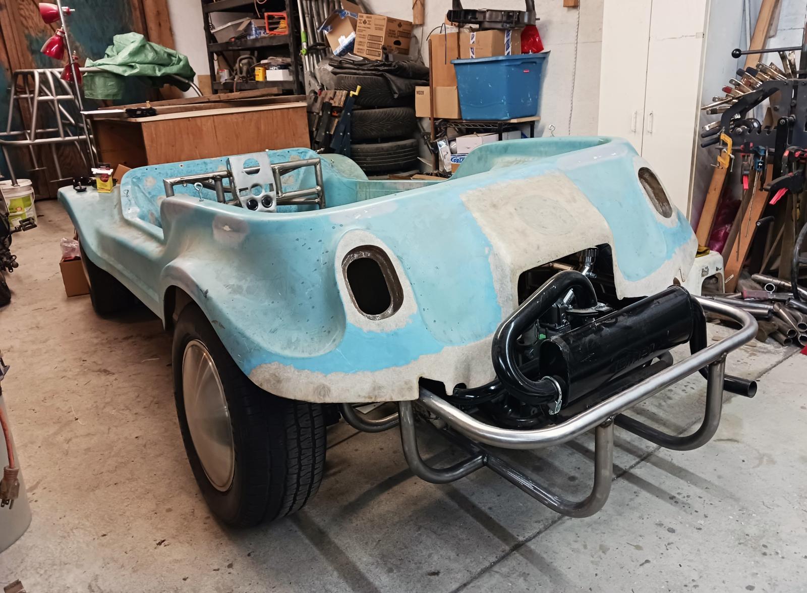

PostPosted: Sun Oct 27, 2024 4:07 pm    Post subject: Re: Low down Hillbilly Reply with quote
I dropped the body on to check the fit now that the rear bumper is mostly done and it looks like everything clears, no problems. The bumper lines up with the old cut outs, which could now be largely filled back in. The rear, lower section will receive a pair of cross bars and some further trimming of the body around the exhaust will be required.

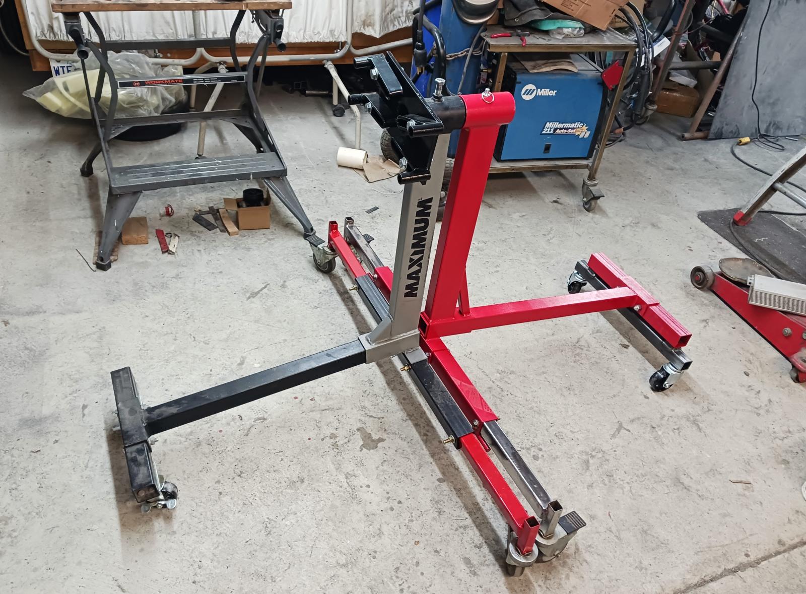

PostPosted: Mon Nov 18, 2024 10:54 pm    Post subject: Re: Low down Hillbilly Reply with quote
I adjusted the height of both engine stands until their heads were level/square and widened their stance to match the width of the beetle pan. This set-up will make a lot of the remaining work much easier, wish I'd done it earlier in the build. So far the chassis seems well balanced and very stable while mounted in the rottiserie. Apart from a piece of 3/8" plate for the rear frame horns, the only additional adaptation I had to make was shortening the rotating mounts on one stand so the front beam mounting bolts fit.

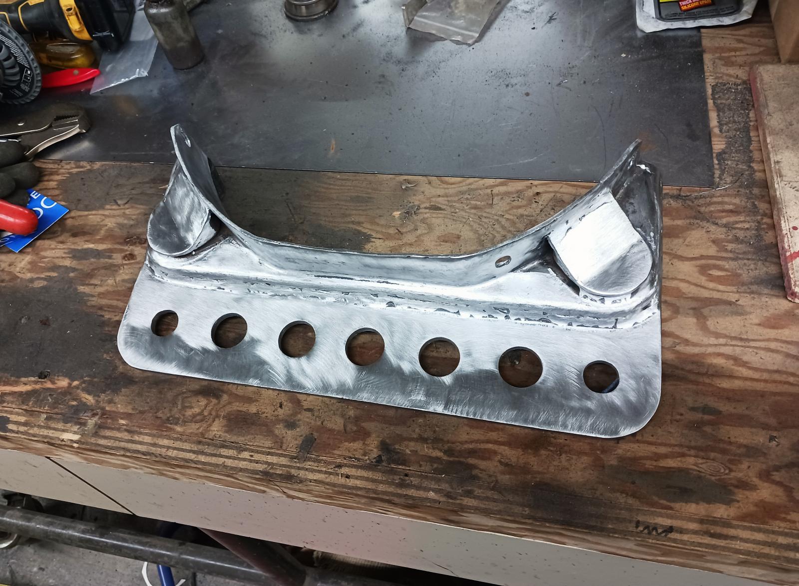

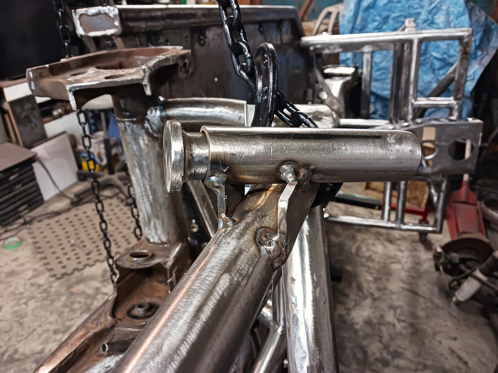

PostPosted: Tue Nov 19, 2024 6:18 pm    Post subject: Re: Low down Hillbilly Reply with quote
Today I finished the 3" motor raise. The inner cradle has an added layer of 16ga mild steel welded in for support, plus the old mount holes are now covered.

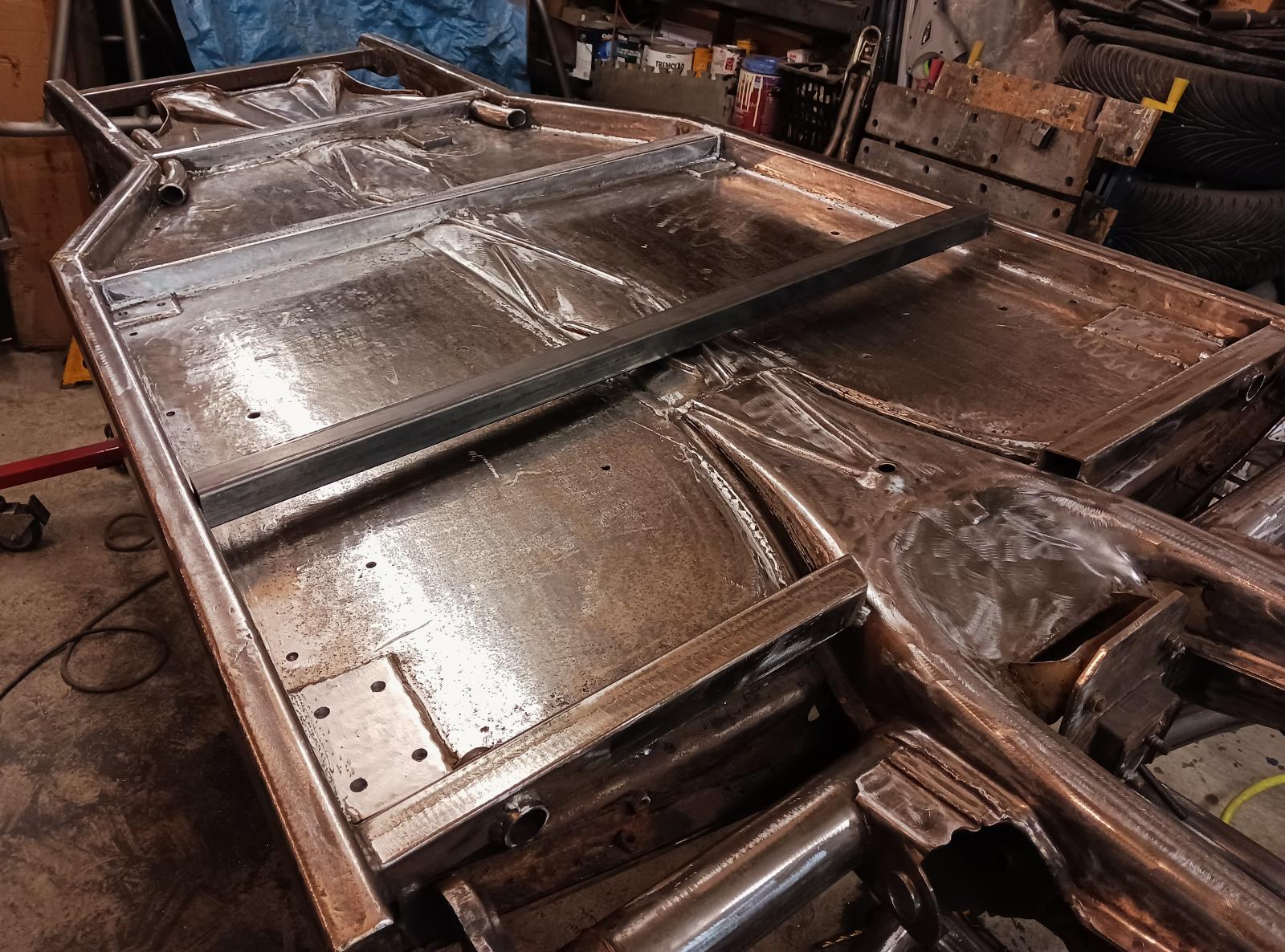

PostPosted: Thu Dec 05, 2024 10:15 pm    Post subject: Re: Low down Hillbilly Reply with quote
The floor perimeter is now welded on the bottom side as well, 3/16" plates were welded to the floor/outer frame rails to secure the corners of the roll cage and the first of two crossmembers is complete. The second crossmember has been angle-cut to width, with plans to notch it, weld it in and clean up the area this weekend. Most of the welds and general underside have also been freshened up with an angle grinder and are ready for paint after some sandblasting in the corners and crevices. The major fabrication is nearly done.

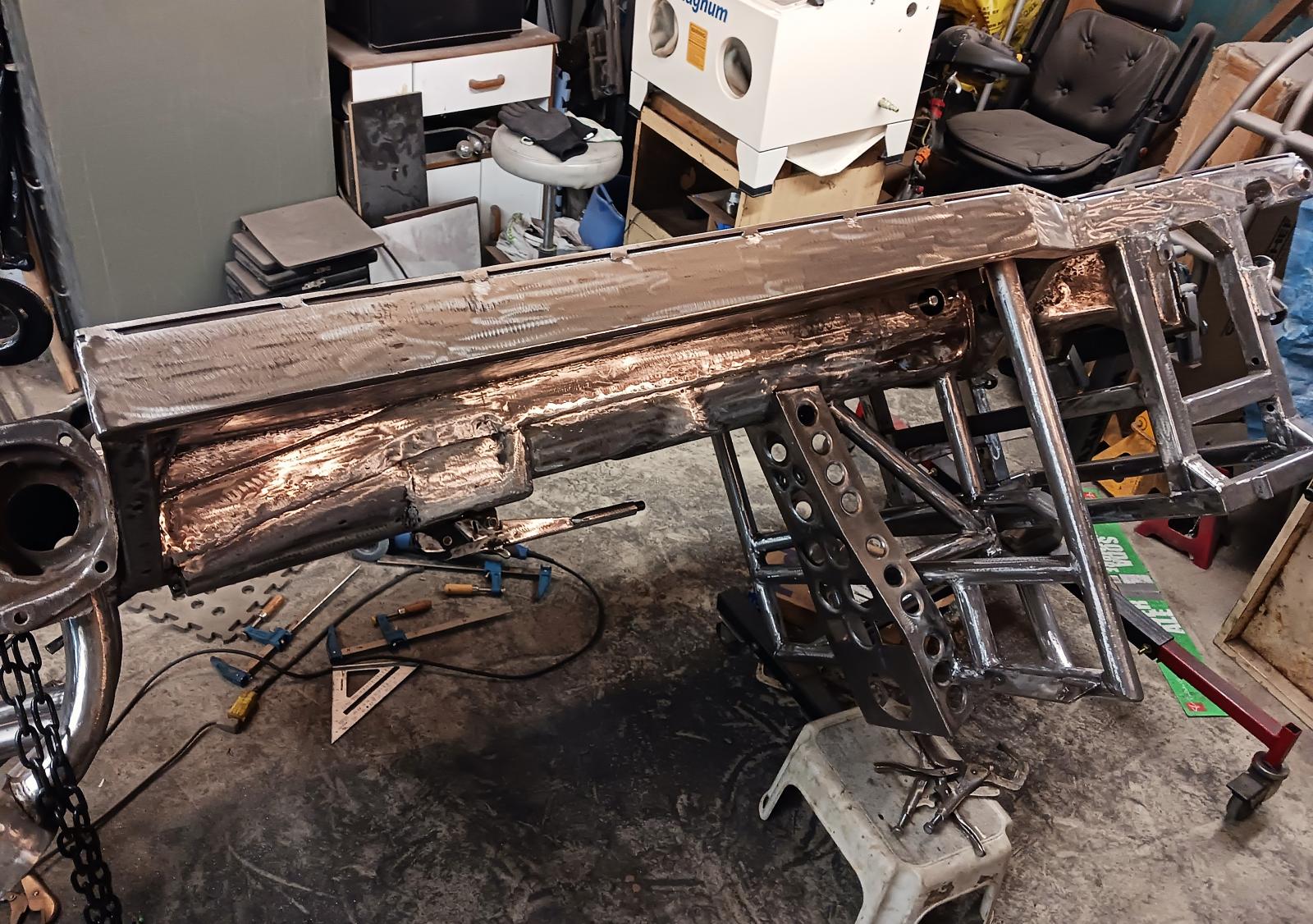

PostPosted: Mon Dec 23, 2024 7:28 pm    Post subject: Re: Low down Hillbilly Reply with quote
Today's effort: I added some 3/16 x 1.5" bar stock along the full length of the chassis as skid plates to protect the frame. This way, when the metal is worn thin it can be cut off and replaced without damage to the actual frame rails. Left to do: There are a couple of rusty strips at the rear of the pan to repair, a pair of tubes to be capped under the gas tank area, the mounts for the air tank need to be welded on and a holder fabbed for the water trap/compressor relay. I'm trying to use my Christmas holidays to my best advantage. Hoping to have a coat of paint on it before New Year.

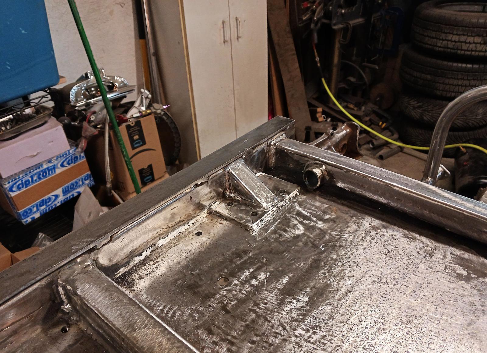

PostPosted: Thu Dec 26, 2024 10:28 pm    Post subject: Re: Low down Hillbilly Reply with quote
I believe the fab work on the chassis may finally be complete. Today I was able to double up on the rear bump stop mounts, fab additional supports for the rear roll cage pads, add four 3/8" body mounting holes to the rear of the pan and fill in a missing piece of pan near the front axle. Additionally, I made a mount for the air line manifold and fuse block/wiring harness behind the dash/console on the passenger side. After another going over, a little more clean up and some sand blasting in the hard to reach areas, I'll be ready for paint.
