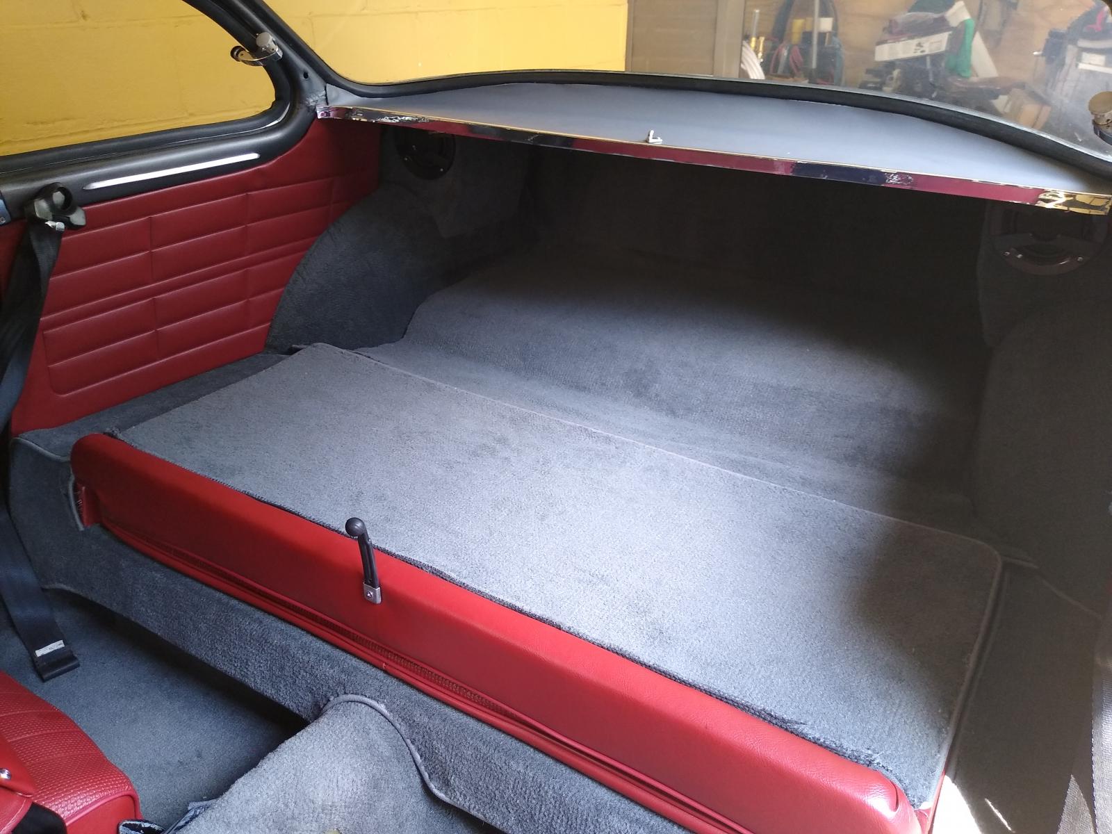

The rear seat (both backrest and seat sections) should be upholstery material over foam padding mounted to a plywood base.
Pics from the gallery of a reupholstered rear seat in a '64 coupe. A '67 would look the same.

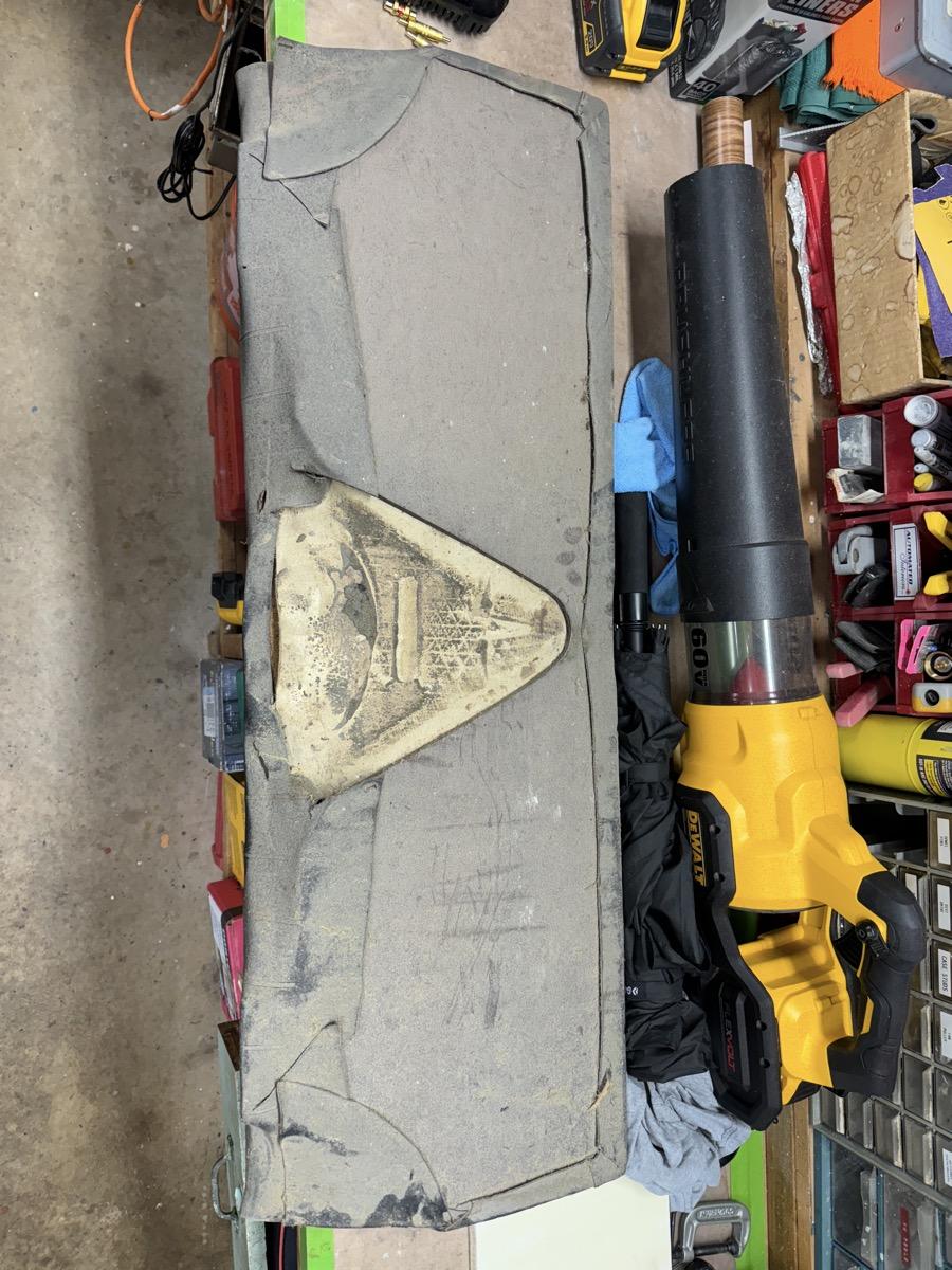

This is the bottom of my ‘70 seat. It has some contours for the tunnel.
I’ve never seen the bottom of a ’67 but I’d bet it’s similar.

The rear seat base also has the metal arch in the center that creates the center bump contour, as seen here.
https://airheadparts.com/vw-part/rear-seat-bottom-half-coupe-143-885-031/
They're out of stock at KGPR, but I'm pretty sure I've seen new bases for sale somewhere else as well.
