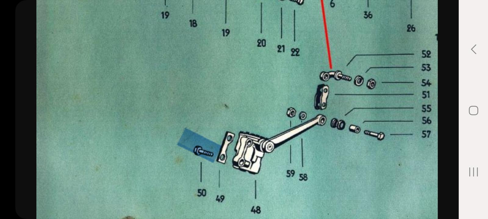

Hi, I'm looking for the specs of the lever shock mount bolts, no 50 in the image, can anyone help.
Posts: 71954
PostPosted: Sat Dec 14, 2024 5:59 pm    Post subject: Re: Lever shock mount bolts Reply with quote
Here's the parts book page to match that image:
Is this what you need or ?
M12 x 1.5 pitch x 40mm long
DIN 960 description with some specs
https://www.fasteners.eu/standards/din/960/

To add to EBs post….Kamax, 19mm head, M12, 48mm length total including head, 23mm of thread
Part number N10140a
For those that seek original, I have these Kamax bolts that can be used with slight trimming:
https://www.thesamba.com/vw/classifieds/detail.php?id=2651893
I used these for 3 of my bolts, as I only had one…hard to find.
Mark carries the lock plates (item 49):
https://www.thesamba.com/vw/classifieds/detail.php?id=2718683
