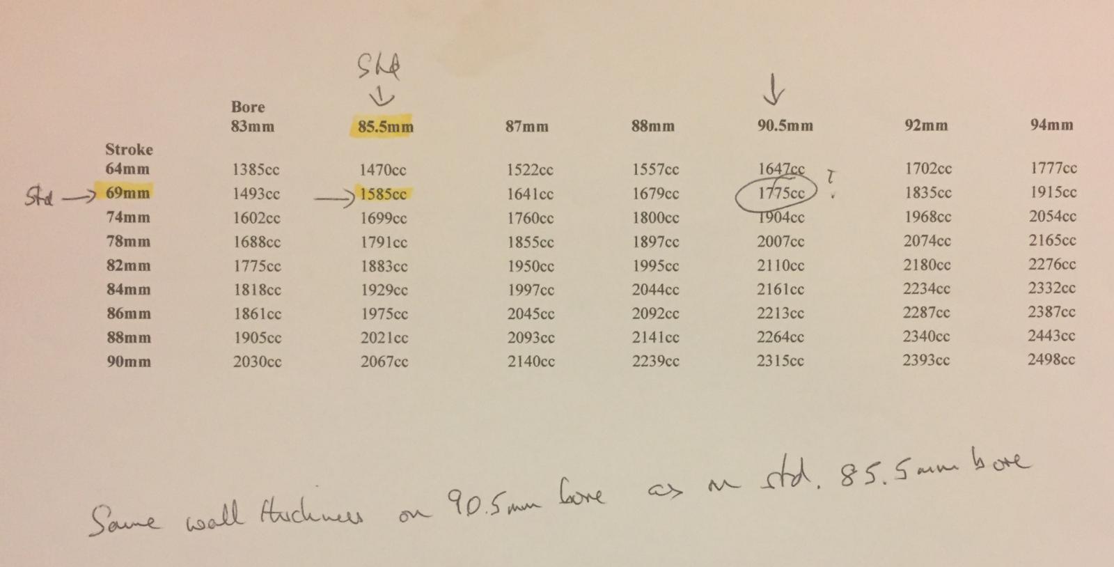

Lot's of factors. Piston sets are typically made for either 69 mm or 82 mm strokes. In between sizes require extra work. AFAIK, 74mm stroke is the largest you can use without clearancing the inside of the case. 1776, 1835, 1914 are the "easy" builds because there is (theoretically) less fitting to do as they are based on the stock 69mm stroke. Of course if you buy a complete engine kit from say, CB Performance, I guess those would already be clearanced.
I thought that until I installed a EMPI 69mm CW crank and found that it hit the case.

Don't make the same mistake I made.
I had to tear a new engine apart to clearance the case because I assumed.
