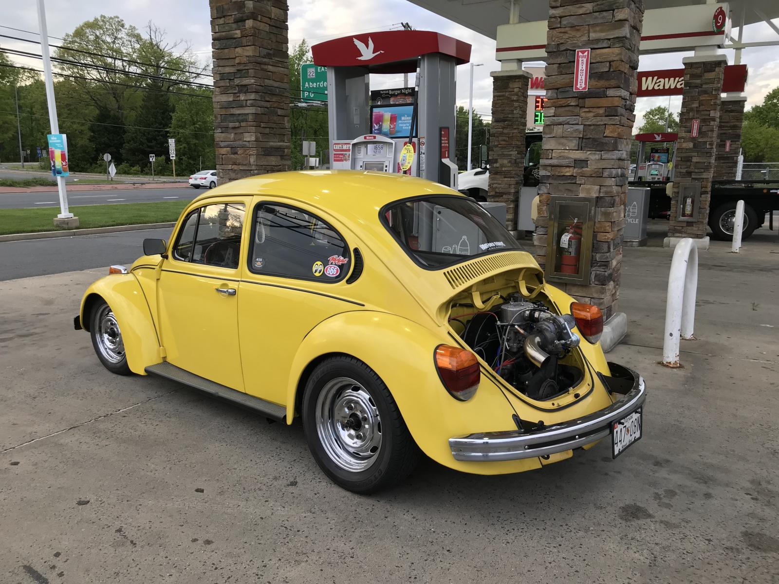

I have 145/15 fronts on a 4.5” rim. Looking to upgrade to something wider. Haven’t decided on a size, yet. Here’s a pic of 205/60r15’s on the rear on my bug.
