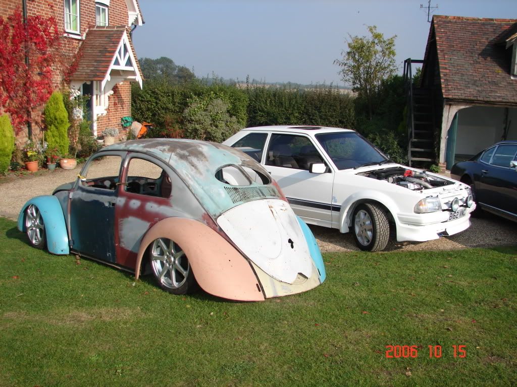

Pic 1, is when i got the car. looks more like a vw polo harlequin model!
thats my 1985 ford rs turbo, which took me 3.5 years to restore from a wreck with no front end! Sold it to fund the 49', so i know about regret!
you may also catch the Aston martin, i've also been restoring this, its now back in its original factory red colour.
this has fooled many people but the 49 is not actually on a chassis there, id just put some wheels under it to see what it looked like. this was before i chose the stock route!

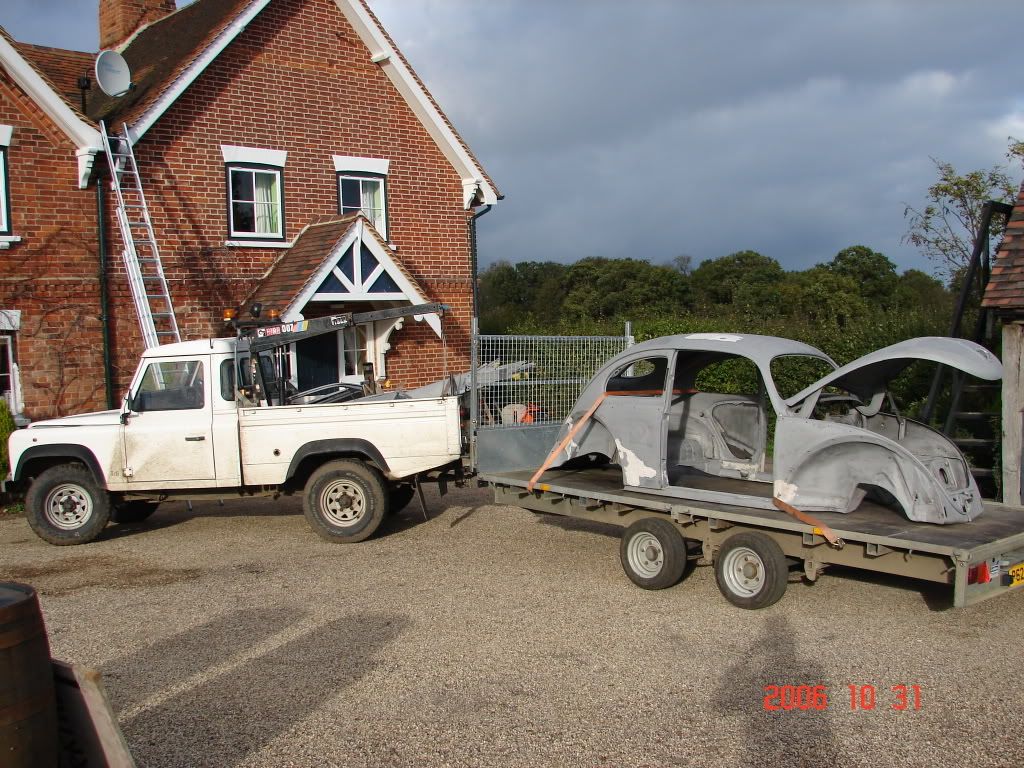

Pic 2 back from sandblasting, you can just make out the chassis in the back of my pickup. i couldnt believe how solid the car was, was very lucky with this one. on the rs turbo when it was sandblasted you could see through the car!!!

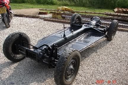

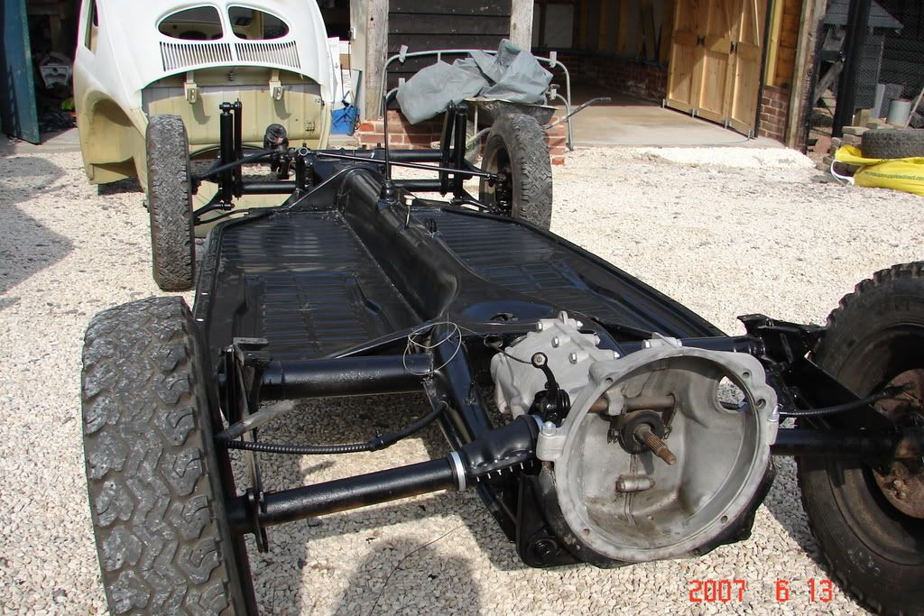

pic 3 heres my chassis after many months of blood and sweat. just need to change the rear drums back to the cables.

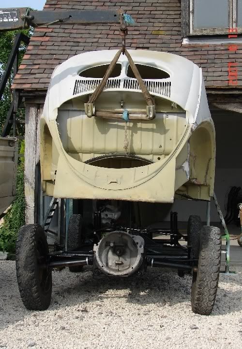

pics 4/5 are mounting the body to the chassis. my hiab came in handy, as no one was around to help!

Lee, It looks like your 49 is a deluxe with cable brakes as it appears to have holes for the body moulding. Is this the case? This is what my October 49 is (body number 75755) also.
I know you said it was a standard, but not all cable brake cars of this year were standards and I have always thought of a standard as one with no holes for the body moulding. Just wondering.
Yes, that is why I asked if his birth certificate really says "standard".
All 49 cars came with cable brakes but the bordeaux red and the trim holes say "deluxe model".

Hi all. no it is a standard. the holes were put in buy a previous owner. theyre welded up now!! Very Happy
also it doesnt have the extra clips inside the roof for the deluxe headlinning. vin no is 1-0-132 757
