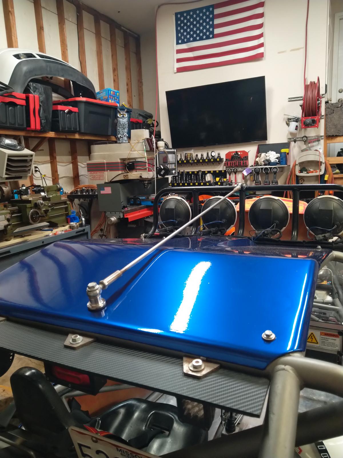

I got my carb protector panels trimmed, sanded, primed and painted with 2k single stage paint and now they're quick-release with DZUS fasteners. I perfectly matched the horrible orange peel on my other stuff I painted too, since I'm an expert. Embarassed The gold heat tape actually works really well that close to the exhaust, and now I finally get to do the art project! Graphics and sticker time! I got some name stickers with the flag, but they're kinda small. Sad I also designed some little filler brackets to secure the firewall out of .060" SS and printed prototypes. (See the yellow bits) I am going to have them dimple-died which I think will look tasteful.
Next I pushed forward on the hood which is a horrible incredibly time-consuming task. Laughing

Thanks man! I had a sample of Vvivid Neptune Blue Pearl vinyl wrap from a vendor booth sample at the Diode Dynamics open house 2 years ago. I tried poorly to teach myself how to do this real quick. No doubt the workmanship is rough but I'm in love with the color. Blue it is for the whole car. I'm not joking, I'm 100% sold on this. Already ordered more wrap.

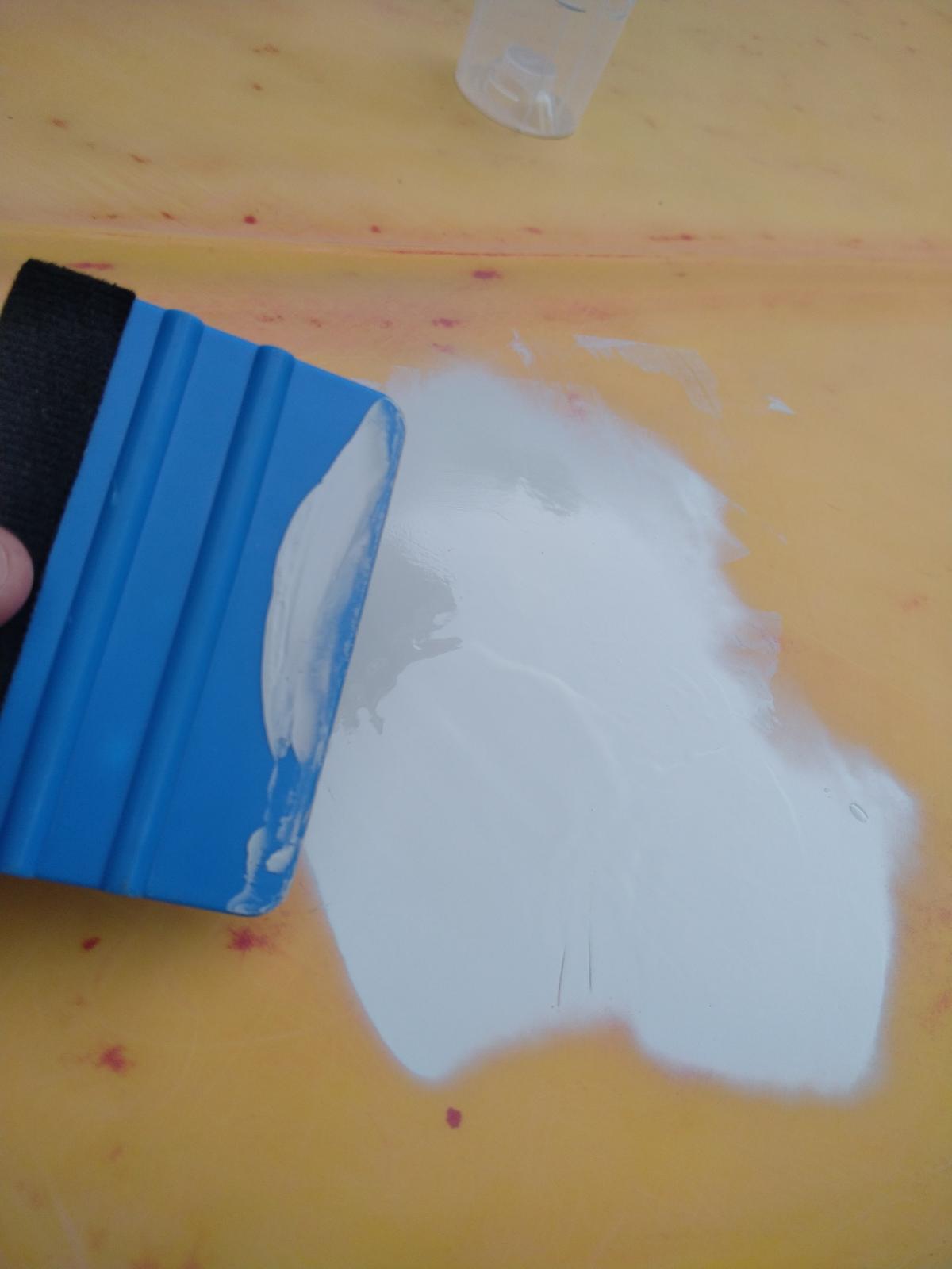

Good progress on the wrap! Everything I know at this point is from the experience pictured, or the Canadian guy I found on YouTube. All things considered it's going well. Everything but the hood is done and on the car!

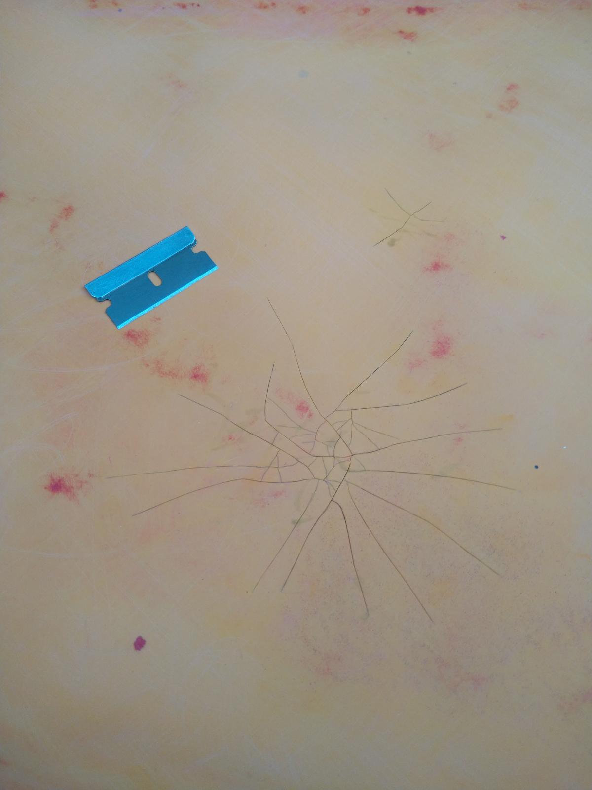

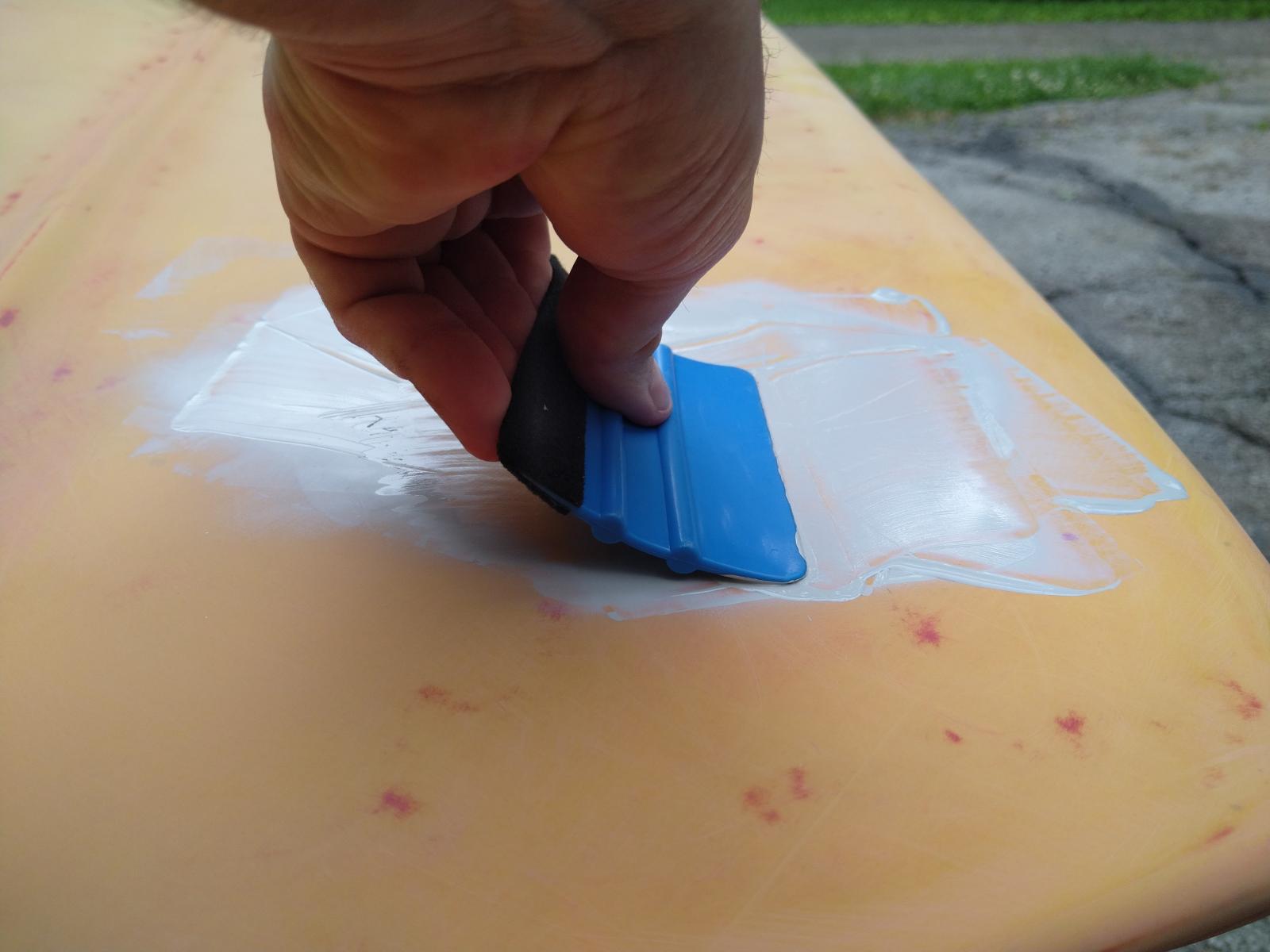

Next I thought to try to attack the spider crack on my hood without sanding out all the gelcoat like you're supposed to. Laughing I really hate bodywork and I had this feeling I was setting up to make something worse than it already was. So, I gouged out the cracks with a razor, and vacuum-extracted them with this lil pneumatic vacuum generator thing I had from a few jobs ago. Then I sprayed some 2K epoxy primer on WAY thick, and started using the vinyl squeegee to smash it down into the cracks. It purged the cracks full and eventually stopped taking any more. Then I let it cure, sanded it, and primed the hood! You almost can't see it. Very Happy

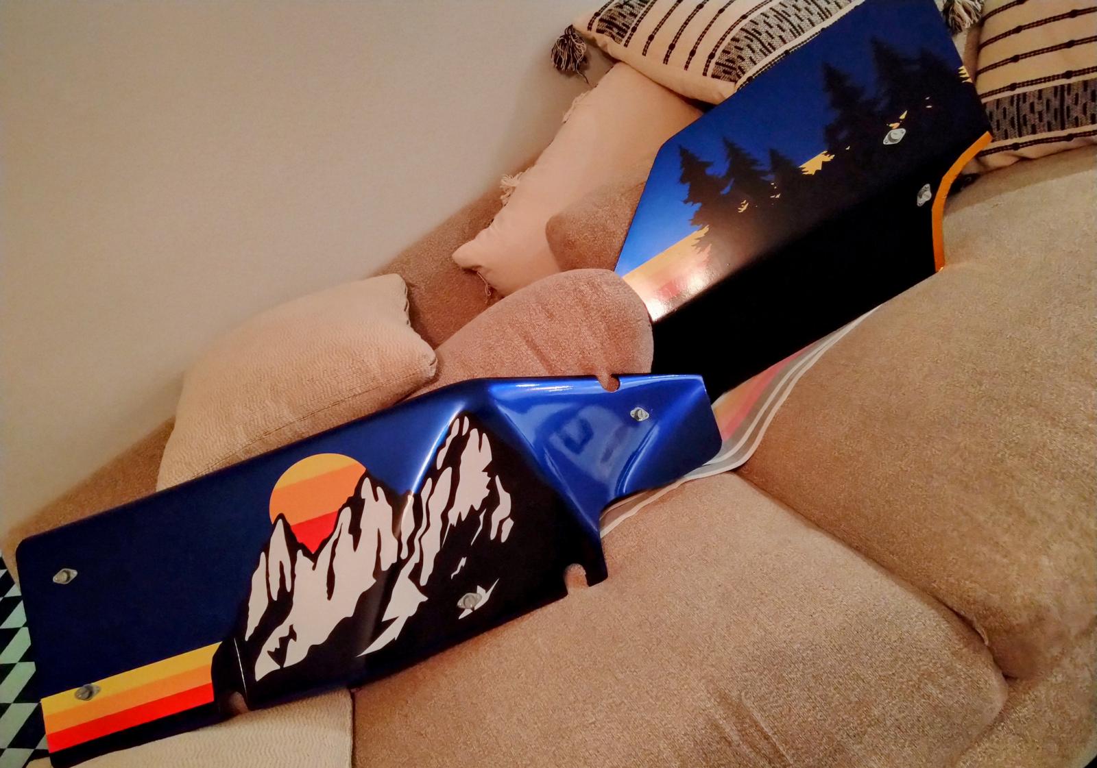

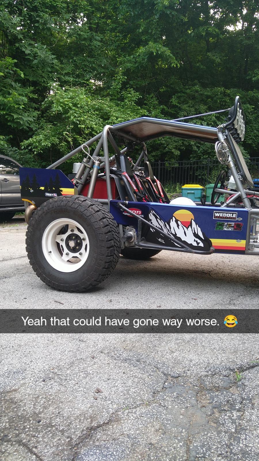

Thanks! I finally got around to ordering any applying some Old Skool Kool graphics that I think were originally designed for a Jeep Gladiator. I really am digging this look, it adds character to the car for sure. I also designed and had SendCutSend make me these little dimple die tie-in brackets to keep the firewall from chattering on the highway.

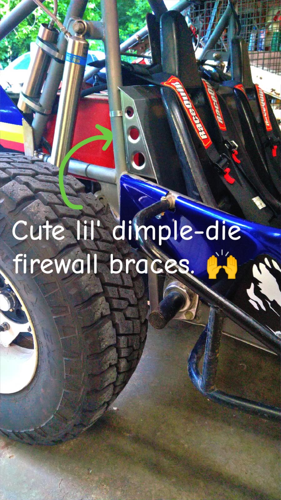

I dig the graphics.
What did SendCutSend charge for the brackets? I have a press and dimple dies here if you want to use them in the future. I have 1/2", 3/4", and 1", but I've been meaning to either buy or turn larger sets; just haven't had reason to yet.
I did this air cleaner mount a while back with them.

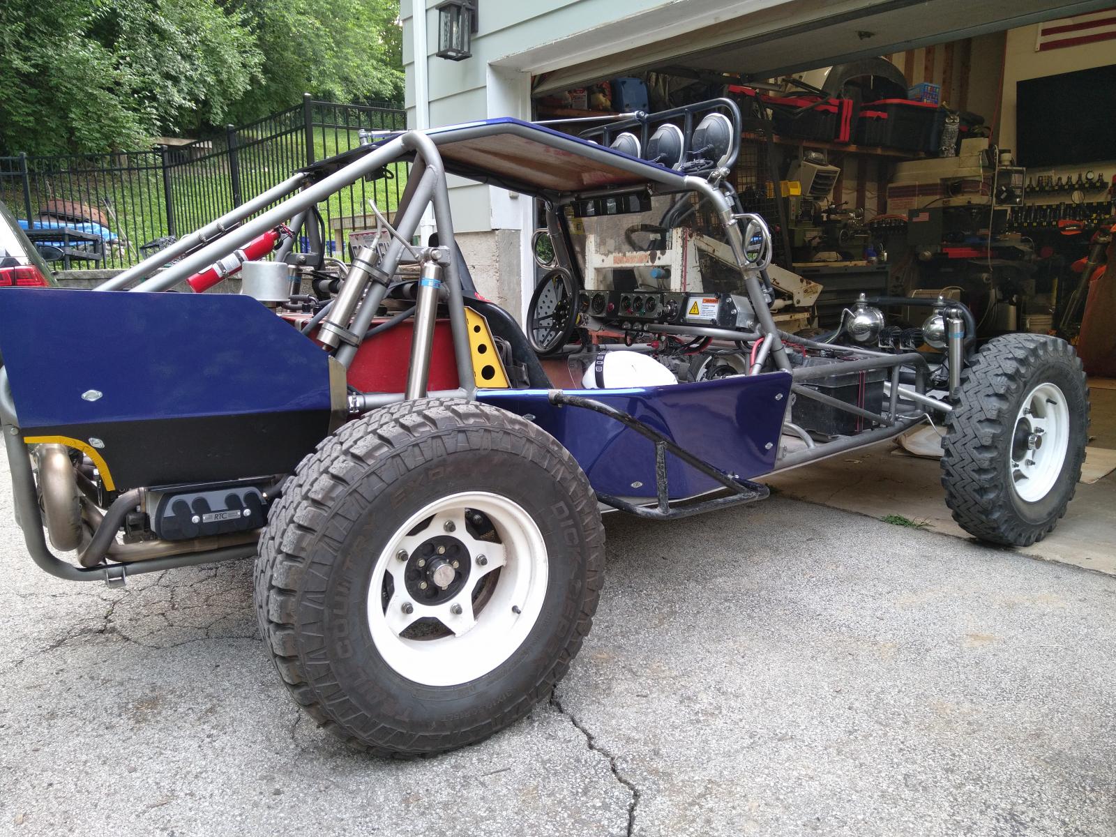

As my high school spanish teacher would say "Jesus, Maria and Jose" - that buggy looks cool and the details you are adding are amazing.
Are those genuine jackman wheels or something else? They look great.

Thanks guys! And I'll hit you up for those dimples if I need 'em. That would be great. SendCutSend got $34 each for those brackets. It was a bummer because the flat pattern is the same for both sides, but they don't give you a discount because the parts are mirrored so the bends and dimple directions are flipped, so you don't get the quantity discount.
Those are real Jackmans, which I like! There is a weird concentration of them in St. Louis actually, because the midwest's distributor for them at the time they were popular was in Earth City, MO, about 20 mins northwest of downtown StL. In the local classifieds it is extremely common to find old rusty buggies with a full set of Jackmans on them because they were so readily available when buggies were popular around here. I have 4 on my car, 6 in my driveway, and 2 in the shed, in various states of rusty.
