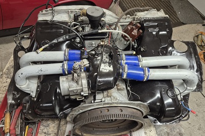

Howdy all! I've owned a '72 Super Beetle for a long time but have been dreaming of finding a decent 412. Yes, it's a weird dream car to aspire to but here it is.
Since I live in California and want a manual that leaves me with a '73 coupe which I believe only came with a 1.7 engine. I also have a 2L long block from a 914 which I squirreled away just in case I find one. So my question is: how hard would be to convert that wheezy 1.7 into a 2.0? From what I gather I will need to split the block and basically swap internals. Just wanted to check if this is correct? Also, would the fact that the engine is located 180 degrees from original placement in a 914 play a role? Thanks!

There are a few things that will be hurdles. Typically it's an easy swap. You would take the sheet metal and exhaust manifolds from the 1.7L and pretty much everything else swaps over into the same places as they are both D-jet.
In the rest of the 49 states, the 1.7L is not "wheezy". It's 82hp and with some careful tuning it can put out 90+ .....which will be as much or more than a California version of the 2.0 from the 914 (if they had one).
I am assuming you are wanting to make this "look" like a 1.7L under the hood. The issue you will have is that the 1.7L in the 412 will have to have the smog pump, egr that went to the left end of the muffler.
And, the 2.0 will need the 2.0 intake runners and center manifold and vertical TB to work properly. It has larger runners and TB. Even with the smog pump and EGR you will not pass visual inspection from the intake runners alone.
Personally, I would build the 1.7L into a 1.8 with better compression than the 1.8L with L-jet. You can get away with tuning the D-jet to run well with that. A slightly better than stock cam....either the 914 2.0 euro spec cam from Web cam or something similar from Raby like the 9590.....and that would spank a California spec 2.0.
The other issue that you will run into is tuning to pass emissions. It can be done but it's some work. Ray

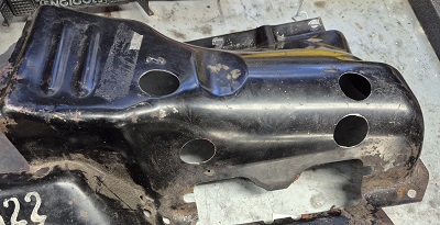

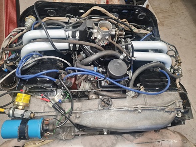

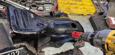

I recently did about the same operation, put a 914 2.0 engine in my 1.7 Coupe.
You need to use all oft the engine tin from the 1.7 since the 914 2.0 tin is made to fit a totally different surrounding (same as the early Porsche 2.0 six).
Just drill new holes for the spark plugs and block the old holes.
I used rubber plugs on mine but welding them would look even better
I currently use trottle body and plenum from the 2.1 WBX....
...but have earlier used the 914 throttle body with good result.
Both plenums can easily be fitted to the stock air cleaner with a suitable flexible hose.
/lars S
Ah! Good reminder Lars!
Yes, the outer perimeter shape of the 1.7L engine tin along with the fit to heat risers etc....are needed to fit in the engine bay.
You can use the 2.0 upper sheet metal and not have the spark plug hole issue....but it's outer edges if memory serves are different than the 412.

PostPosted: Wed Jan 29, 2025 6:45 am    Post subject: Re: Converting a 412 to a 2L engine Reply with quote

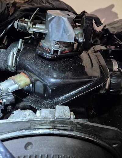

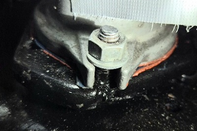

Synchromesh wrote:
very good stuff, thanks! Yes, if you could please post the throttle wire setup. It would help a lot. Just to be sure, the original setup 1.7 won't work?
This is how I made the 914 2.0 throttle body (TB) fit to the 412 gas wire orientation.
I rotated the TB on the plenum about 110(?) degrees clockwise so that the wire angle matched the wire fitting point at the TB.
I welded two M8 studs at the right positions, maybe it can be done easier with just two bolts and nuts under the edge of flange...the nuts may have to be filed a bit to get under there...
/Lars S

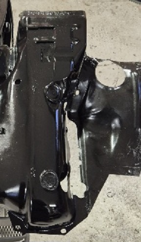

PostPosted: Wed Jan 29, 2025 6:55 am    Post subject: Re: Converting a 412 to a 2L engine Reply with quote
This is why the 914 cooling tin will not fit in a 411/412 engine bay, its made to fit a totally different surrounding namely the same surrounding as for an early porsche 2.0 six.
I cant think of any of the tin pieses that will fit a 411/412...possibly the small inbetween cylinder pieces under the barrels.
pics showing a 914 1.7 but my comments apply to all 914 engine sizes
