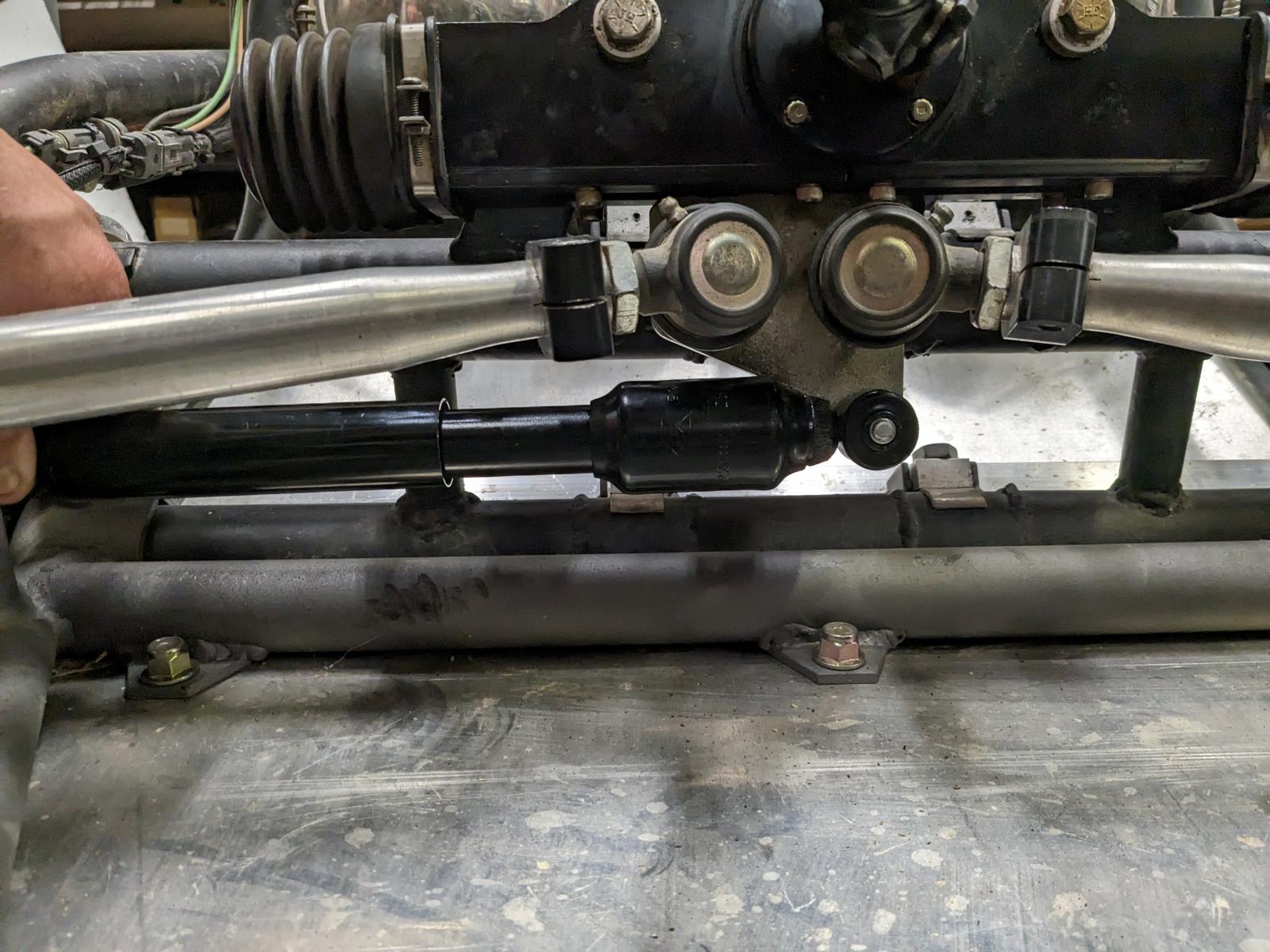

For sure! I started driving it as soon as it warmed up, and that motivated me to tidy up the panels and get some at least mediocre paint on them. I am looking to get back to St. Joe's now that I have carburetor shielding and a steering stabilizer - my two issues from last time. It didn't stop me from launching the car 4 feet in the air, and I aim to do it again. I have one bus stabilizer on the hydraulic assist tab of the rack now, and I have the mounting provision for another one on the other side of the tab if I need it. We'll see how one does first.

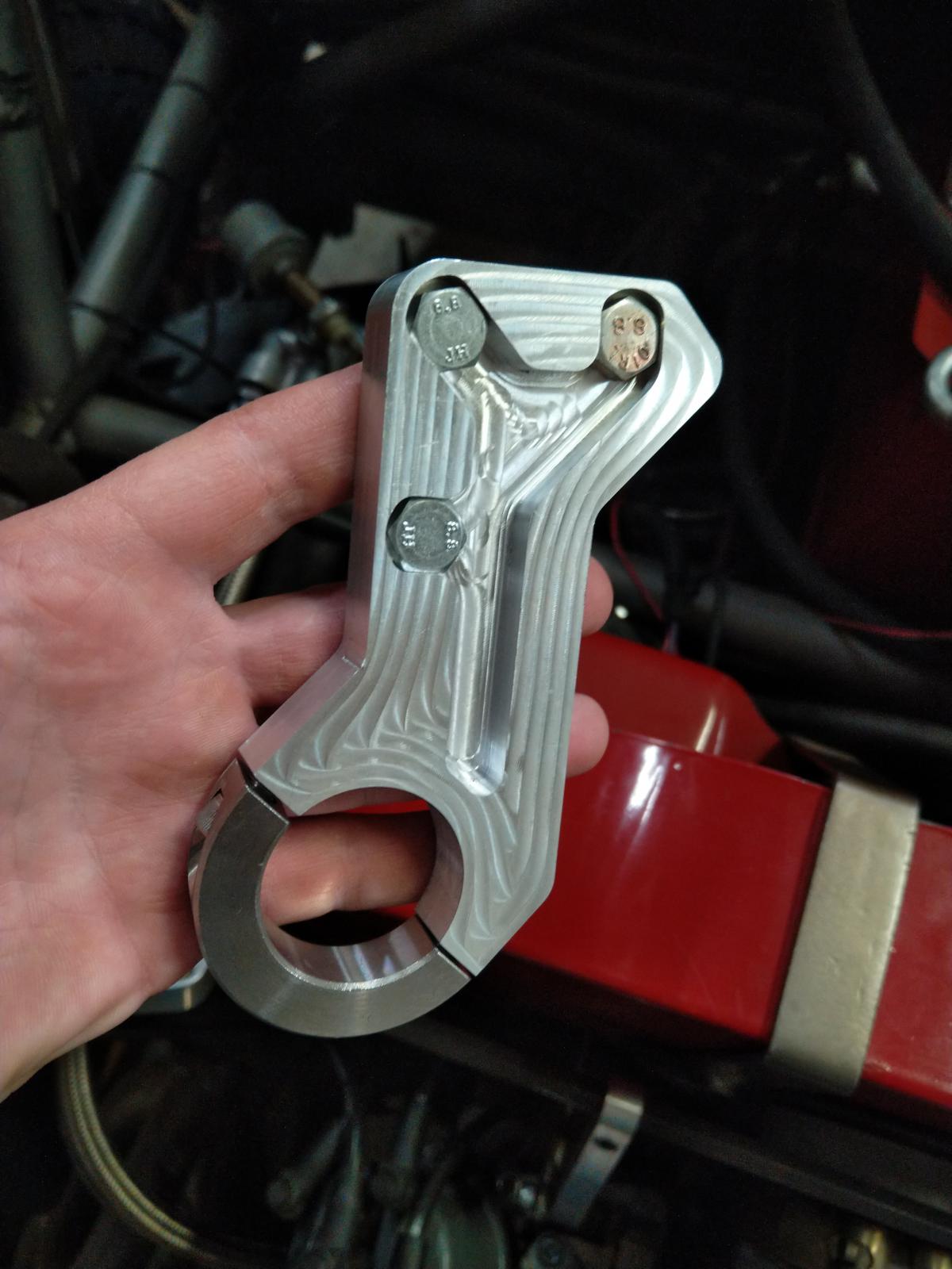

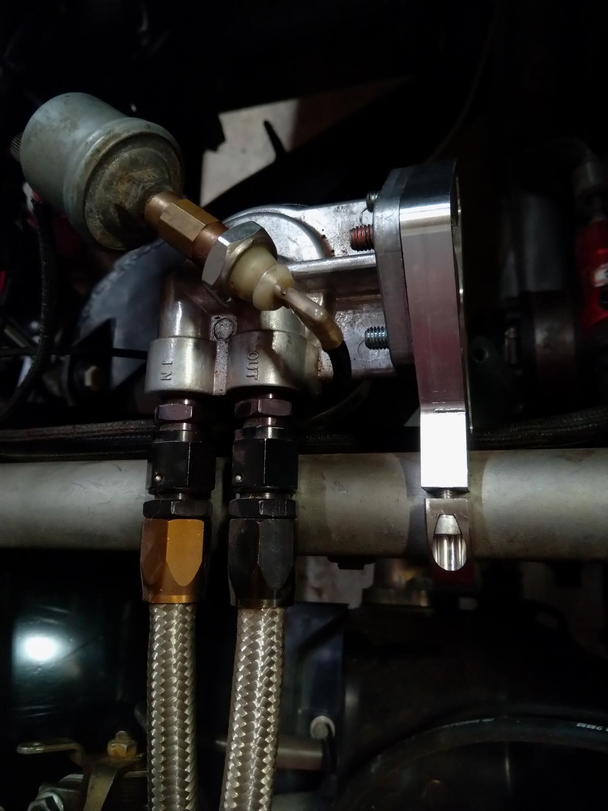

Finally getting a chance to attack some lingering quickie-fixes on the car. The oil filter mount was scabbed onto the trans brace tab and was pretty scary. I sorta forgot about it, until I didn't. Embarassed
Oil filter mount machining:
Cute little milled out weight reduction doubling as bolt head locks so you only need a 13mm to unbolt it! Proud of that little innovation. Sorry it's dark, the Costco LED lights above my car died and it's midnight here.

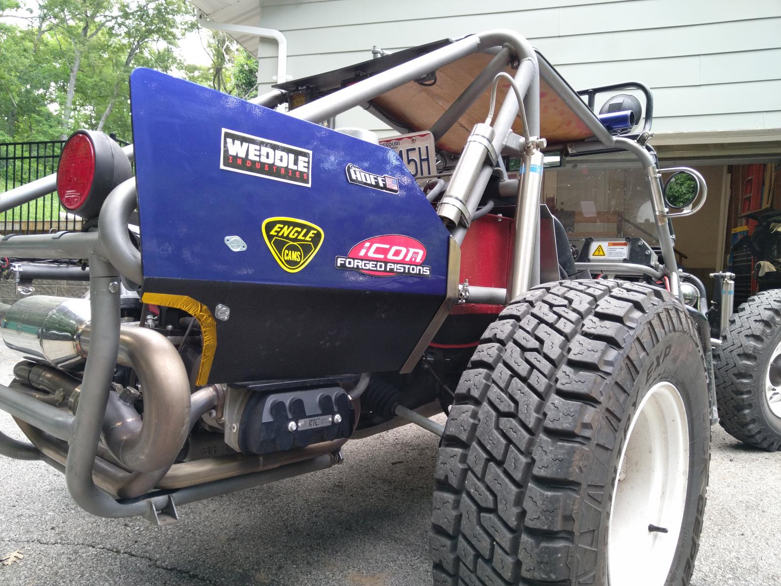

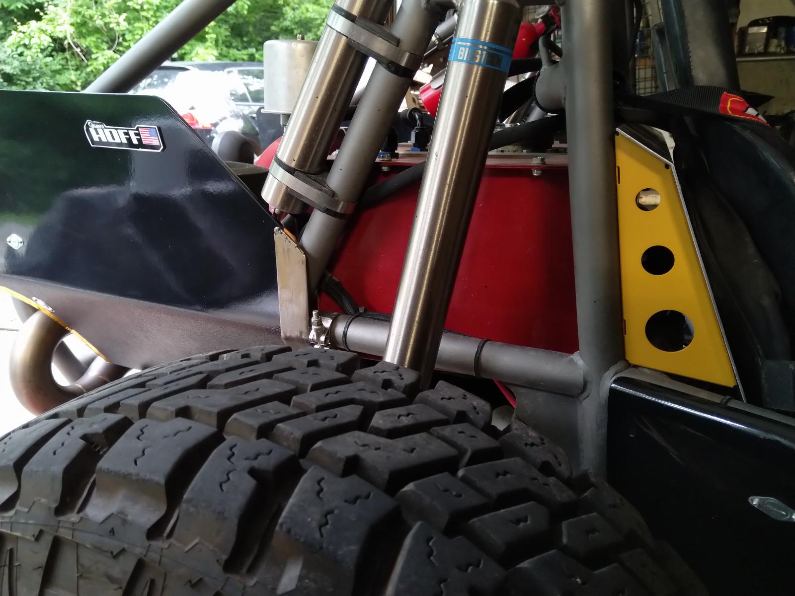

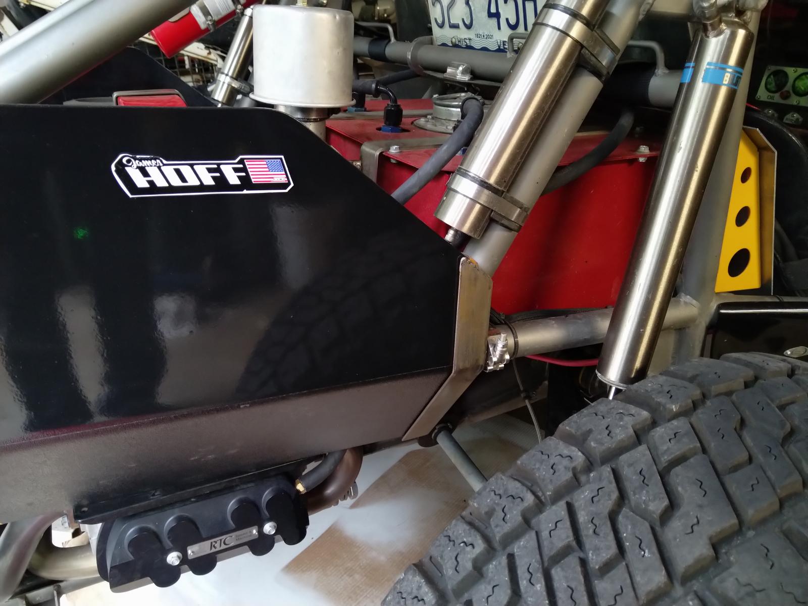

I got my carb protector panels trimmed, sanded, primed and painted with 2k single stage paint and now they're quick-release with DZUS fasteners. I perfectly matched the horrible orange peel on my other stuff I painted too, since I'm an expert. Embarassed The gold heat tape actually works really well that close to the exhaust, and now I finally get to do the art project! Graphics and sticker time! I got some name stickers with the flag, but they're kinda small. Sad I also designed some little filler brackets to secure the firewall out of .060" SS and printed prototypes. (See the yellow bits) I am going to have them dimple-died which I think will look tasteful.

They look really good! That hood should keep you a bit drier next time you take it out in the rain.

Thanks man! I had a sample of Vvivid Neptune Blue Pearl vinyl wrap from a vendor booth sample at the Diode Dynamics open house 2 years ago. I tried poorly to teach myself how to do this real quick. No doubt the workmanship is rough but I'm in love with the color. Blue it is for the whole car. I'm not joking, I'm 100% sold on this. Already ordered more wrap.
