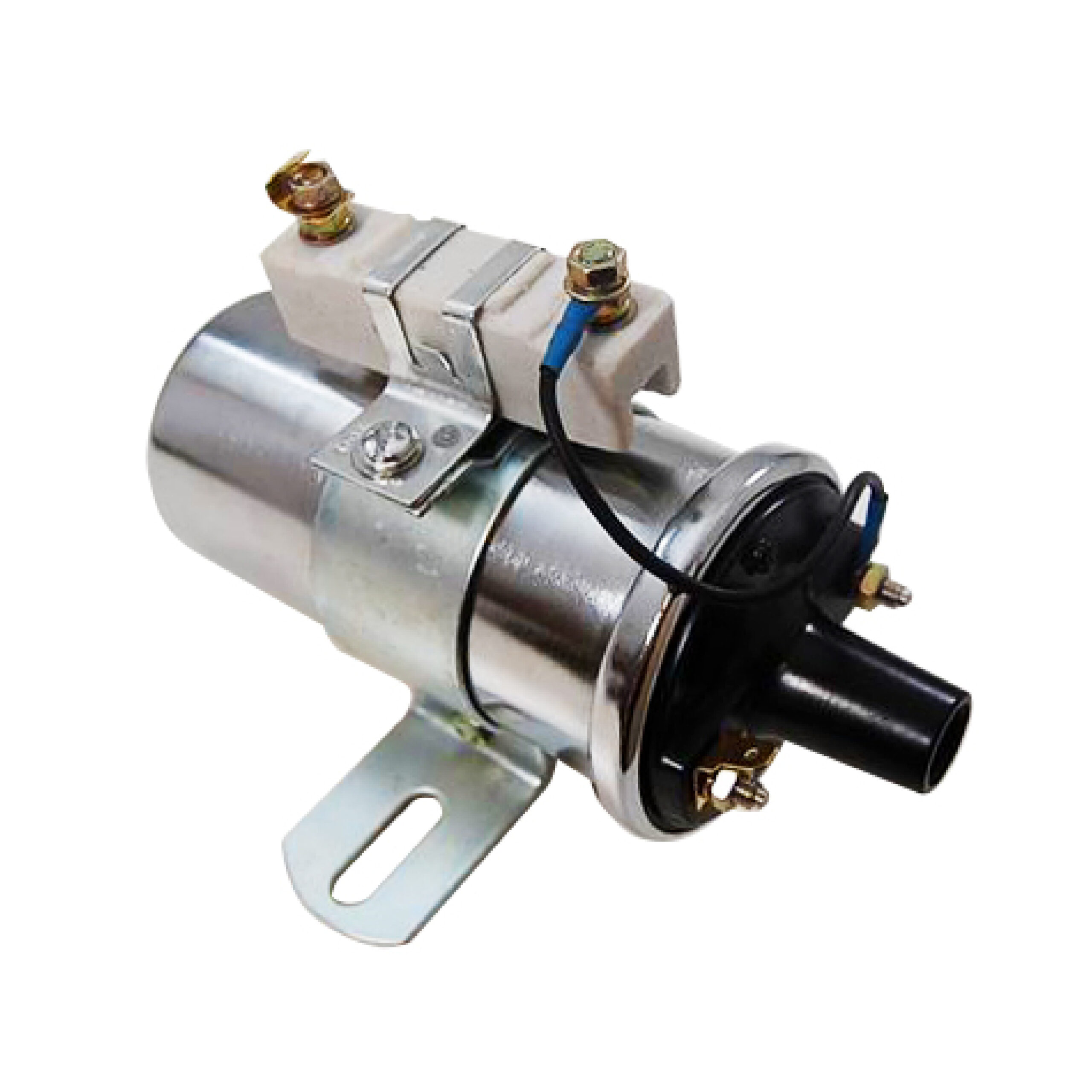

Pertronix Ignitor I = 3.0~4.0 ohm resistance in the primary coil winding. If you have less than this in the internal coil you should be able to add an external ballast resistor in series to increase the total resistance to bring it into the proper range.
Here is a pic showing a canister ignition coil with an external ballast resistor:
By adding resistors between the 12v power source and the electronic points module you reduce the current that makes it to the module; reducing the chance of burning it out due to too much current flowing thru the module. The same applies to stock points.
