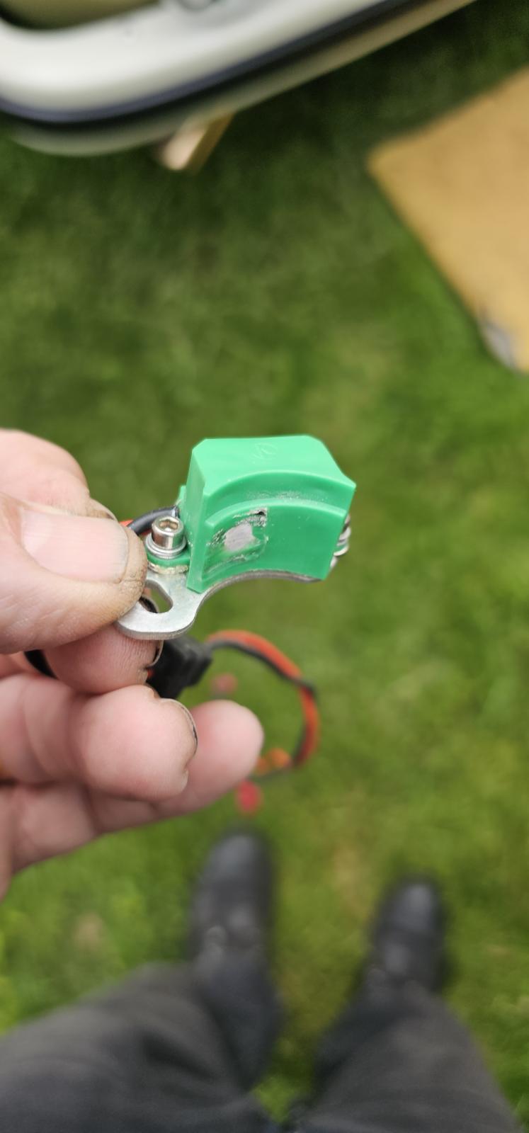

I was gald I had an EDIS system the other day, one of the wires to the ECU disconnected so the EDIS-4 modulen just sat there running at 10 degrees advance. At the time I had gone into Winchester which had one medieval bridge over the river on my route and emergency roadworks blocking access. So I ended up in gridlock and then out on narrow country lanes, unaware it was broken. It was only whenI got home I noticed the timing advance dial on the dash display was stuck..
Being more used to modern electronic modules, I assumed it was electronics so I swapped out all the electronics then found a bad wire.
Anyway here is a picture of a random electronic module that melted itself. The engine was still running, just not very well. The owner had driven some distance to the Techenders technical camp-out here in the UK.
