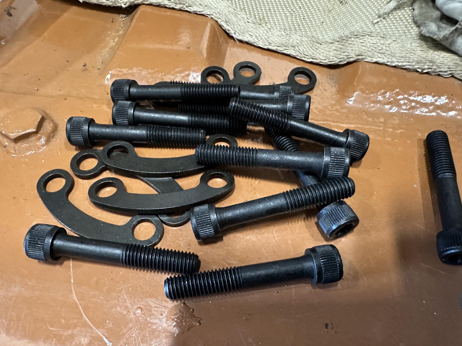

Got my new “cheap” axles they look good.
Decided to clean up some surface rust and paint before I install them.
Had to clock one of the axle, otherwise everything looks good and the length is the same as the old axles.
Here are some pictures:
