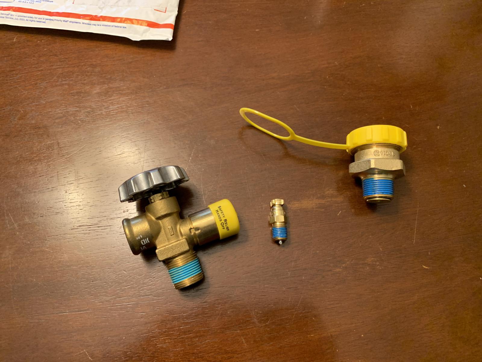

Just finished replacing the service valve, fill valve, and bleeder on my propane tank. I didn't replace the two stage regulator, as I had already replaced that about two years prior. I didn't bother with cleaning or painting the tank, just scraped off some of the larger scale rust. As far as I can tell, it was all original. Purchased the parts from Nash Fuel.
https://store.nashfuel.com/products/service-valve-...psi-relief
https://store.nashfuel.com/products/propane-cylind...pt-bleeder
I sprayed all of the parts down with some penetrating oil a few days prior to removal. Luckily all of the parts came out without much of a fight. Installation of the new parts was quick and simple. I opted to reuse the original fill valve protective cap, for the sake of trying to keep the original look (or maybe because I forgot to install the new cap tether around the fill valve before I screwed it into the tank) Took the tank to my local RV store and got it filled and then reinstalled to the van. Now I can open and close my service valve without propane spewing everywhere Very Happy
