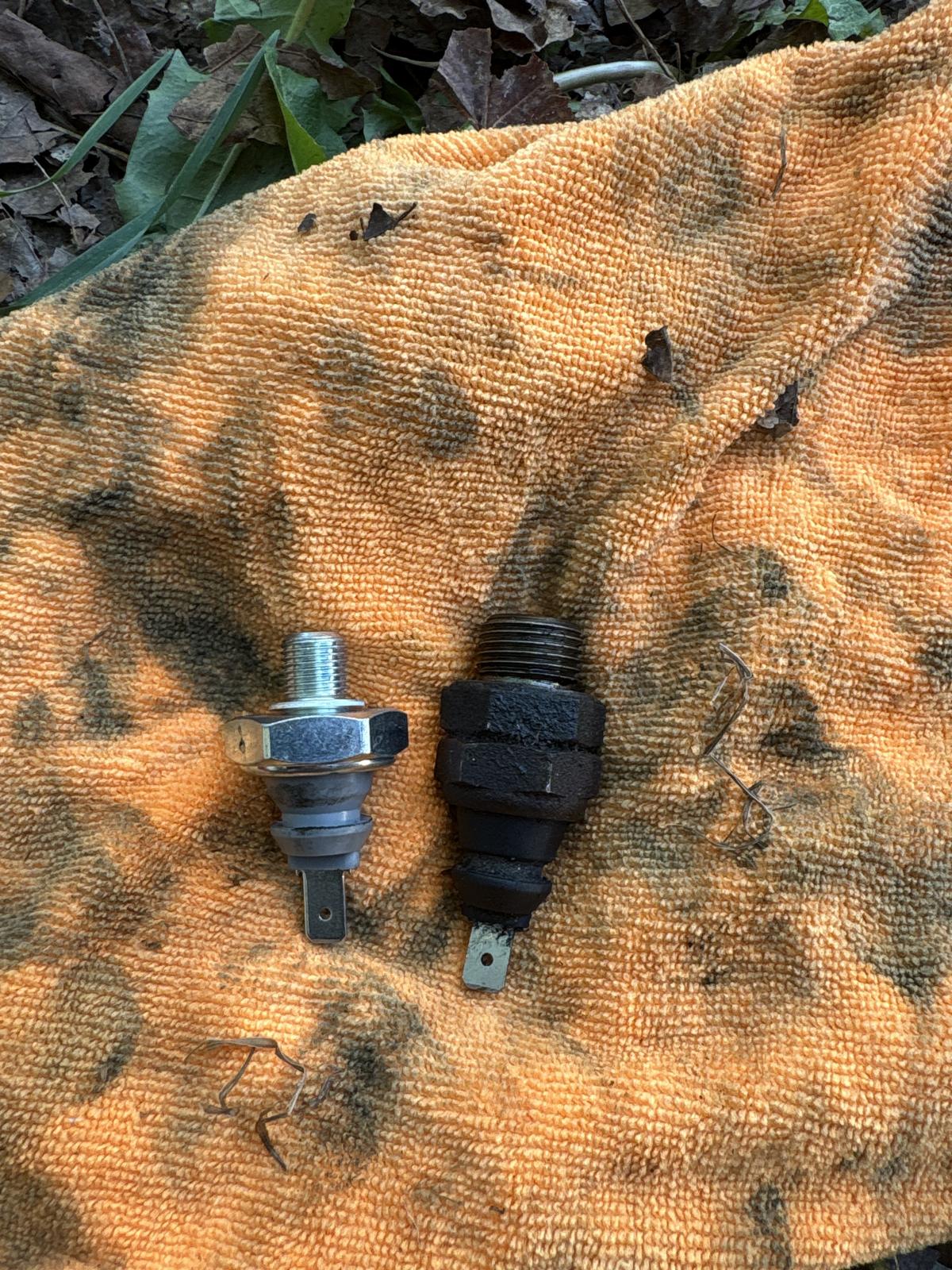

So I’m a little late getting back to this as I just got back from school. The advice about using a tap on the low pressure switch (lower on the engine block) seemed to work. I now have the new low pressure switch in. My trouble now comes with the replacement for the high pressure switch (around the pulleys). The old one came out pretty easily with a 24mm socket, but is much larger than the 10Mx1.0 sensor I got to replace it. The old sensor also has an additional nut on it. Since my oil warning lights always came at high rpm, which I think means it was a problem with the low pressure sensor, I was thinking of possibly just putting the old high pressure sensor back in. This wasn’t my plan originally, and I wanted to replace both sensors for peace of mind, but I’m wondering if it’s worth the hassle to find a replacement part for the high pressure switch that is the same size as the old one. Thanks
Well I think I answered my own question. It looks like I took out a part that was part of the block itself Laughing . I’m working on getting the two pieces unstuck but it looks like the replacement part I got will work after all
