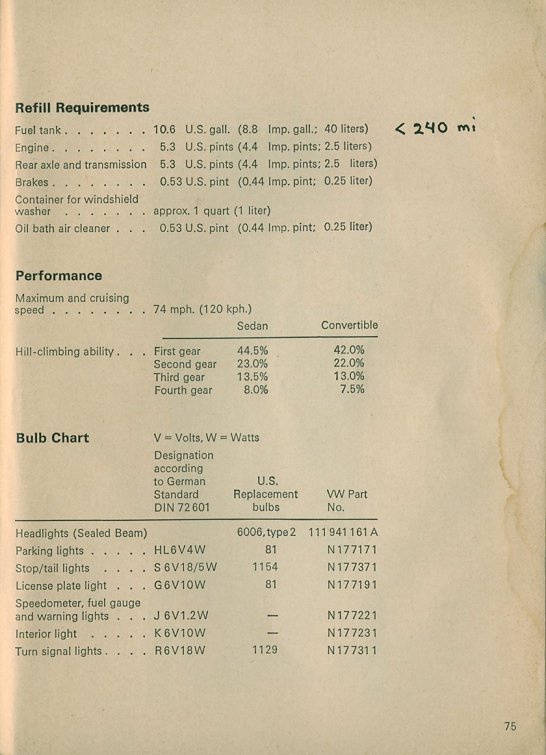

You can put anything in it, but VW recommended a certain weight, they could have given a wide range of lube weight, but they didnt. If 90 to 140 weight was ok, then I am pretty sure VW would have specified that. A tranny can be expensive to rebuild, why risk ruining it by putting in the wrong stuff?
The owners manual is very clear, 90 weight, except for arctic conditions, in which case 80 weight.
Refill is 5.3 US pints per below owners book... ( the prior post that mentions 6.3 US pints if for a dry tranny, since about one pint stays in a drained tranny, the refill volume is less, which is listed as 5.3 US pints. )***
https://www.thesamba.com/vw/archives/manuals/aug65bug/page75.jpg
And the factory recommended lube type here...
https://www.thesamba.com/vw/archives/manuals/aug65bug/page77.jpg
*** Proper fill level is when fluid level is to the bottom of the filler hole, it should be about 5.3 pints for a change after draining always drain when oil is hot after driving to assure the most gunk gets drained out. if it is a fresh build tranny that has zero oil in it, then 6.3 pints is required
