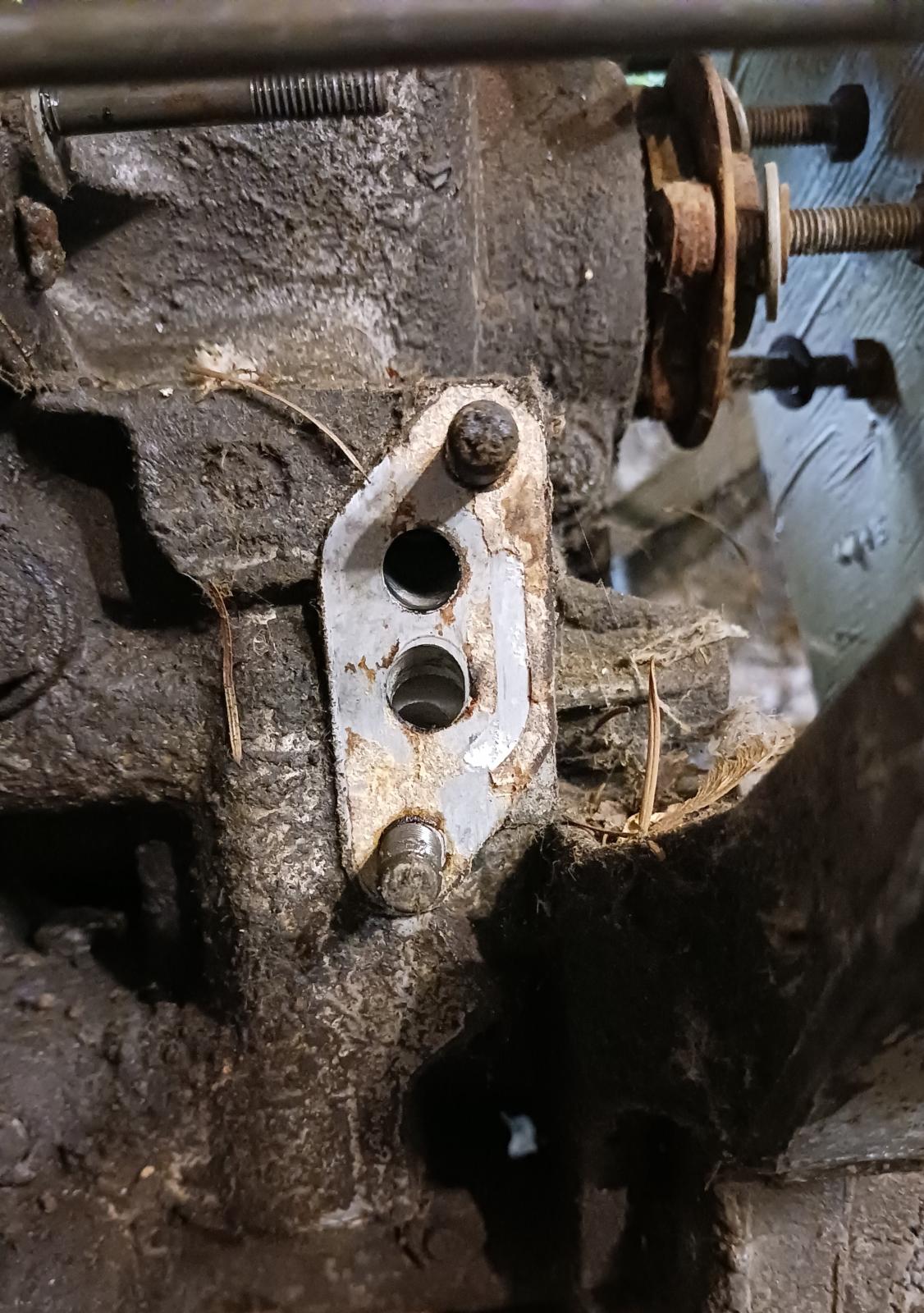

I have a Vanagon block in the pile in the back of the shed that likely still has the filter adapter on it. Will see what it takes to get to it.
Wildthings
Joined: March 13, 2005
Posts: 52739
Wildthings is offline
PostPosted: Sun May 11, 2025 7:18 pm    Post subject: Re: Oil Filter Mount Gasket 021-115-359A Reply with quote
Just a thought here, most don't have a problem using sealant on the cover of a Type 1 oil pump if using the gasket causes too much endplay in the gears. Gluing the Type 4 oil filter adapter to the block should work similarly, with there being far less force trying to lift the adapter away from the block than what is seen with the oil pump cover.
Wildthings
Posts: 52739
PostPosted: Sun May 11, 2025 9:25 pm    Post subject: Re: Oil Filter Mount Gasket 021-115-359A Reply with quote
Wildthings wrote:
raygreenwood wrote:
Does anyone know any series of cases like later model bus or Porsche 912 that has a corresponding slot in the case that would require a slotted gasket?
Ray
The Vanagon engine that I have does not have any extra hole or other visible reason to need the slot. The gasket that it has is quite thin and well adhered to the block and the adapter split into two plies as I took the adapter off. No clue on the history of this engine, don't even remember where I came by it anymore, think maybe someone just asked me to take it off their hands.

Just one short info about range of VIN and engine numbers. My L 60 B Peru green type 41, shifter, prod date stamp in original german "KFZ Brief" 29.05.1969 has VIN 419 039 04x and engine V 0 040 19x (still matching). A spare V-engine is also here, but for the number, still I have to look.
EDIT:
my spare engine is # V - 0 020 947 # In 1969 there were still only type 41 and 42, but no 46. The # V-engines # had a special tube for oil level dipstick and a separate tube for oil filling. (later only for type 46)
In case of interest, I can take pics. Fan schroud is off.

BUT.....the other item: There WAS a different part number filter mount used with the earlier gasket on early 411 V engines.
Intermediate flange- oil filter 021 115 353 was used UP TO eng # V 0 033 302
The later oil filter flange was 021 115 353 A and was used FROM eng # V 0 033 303.
There is a very vague memory from a LONG time ago when I had my first 411 that there may have been some breakage or angle issues with early 411 oil filter flanges. I will have to see if I have any V series oil filter flanges in my parts pile. I have come across maybe two V series engines in my life.
I can also ask in the 411/412 forum. It would be nice if someone has a V-series with the "non-A" series filter mount se we can see what the difference is and put this thing to rest.

Wagen19...what is also of interest if you have a V engine (and you were one of the few that I had remembered that posts in the 411/412 forum that had a V engine)......can you possibly take some pictures of the oil filter mount?
As I noted yesterday, there is a different part # of intermeidate filter mount on the early V engines that goes along with that early gasket. I would be interested to know what the differences are in the oil filter mounts.

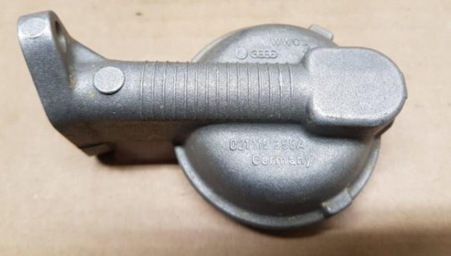

I believe, I have found the answer.
The old filter mounts tended to crack, the newer edition has a enforced housing and flange and came with a more elastic gasket with gap, as indicator for overtorque.
The filter mount in pic of SGKent, May 11 is clearly the early version for V-engines up to 0 033 302.
Compare with pics of 021 115 353 A
https://heritagestocks.com/product/021115353a-intermediate-flange-oil-filter/
Had also a look in "VW Reparaturleitfaden" Engine (1969 to 73) under chapter 5.1 2-6 there is the same pic of the old "weak and unsolid" filter mount version.
Please have (all) a look on the factory pic, SGKent has posted on May 11 and compare with the known newer mounts. The housing in pic is clearly the old and weak version of early filter mount.
I´m rather sure, the difference to the common later mounts is clearly visable.
OK, yes, after I had compared the pic in "VW-Leitfaden" and the filter mount on my V-engine, I can say, there is a visual difference, recognizable from outside view.

I believe, I have found the answer. The old filter mounts tended to crack, the newer edition has a enforced housing and flange and came with a more elastic gasket with gap, as indicator for over torque. ... "VW-Leitfaden" and the filter mount on my V-engine, I can say, there is a visual difference, recognizable from outside view.
wow. I am impressed by the ability to find that in print. Where did you find it?
So - in a nutshell, VW re-designed the mount, and VR provided a new gasket design that allowed greater crush. The mount of mine that cracked had the VW/Audi logo on it so I think it was a newer one. It was on a 1977 engine. The one I replaced it with is also marked with the VW/AUDI logo. I don't remember what year VW parts started having both logos. Both the ones I have are 021-115-355A, and I had to hunt for those that have the dual logo. Many used ones just have the VW logo cast into them. The fiche lists the same part number for all years 021-115-353A. The part is available new these days from Porsche and VW Classic in Europe for around $150 USD. It was not when I was looking for good used ones in 2013.
That said, the box in the link and the fiche show 021-115-353A but the actual part has 021-115-355A on it. Mine look like the one you linked at the Heritage Stocks link with the dual logo on it. https://heritagestocks.com/product/021115353a-intermediate-flange-oil-filter/
with VW/Audi logo - 15 ribs and oblong end
vw logo only - 21 ribs and round end
Original style shown in books. Intermediate flange- oil filter 021 115 353 was used UP TO eng # V 0 033 302 which is in 1969
Many thanks to you, SGKent for the pics here.
Maybe you can add a pic of old style filter mount from bentley in your post too.
On my V-0 020 947 engine, there is the new style (probably once replaced) "round end" filter mount, on my GB 003 517 (model 1973) is the "oblong end" (assumed to be original) filter mount affixed.
Sorry, I´ve still not counted the number of ribs.
