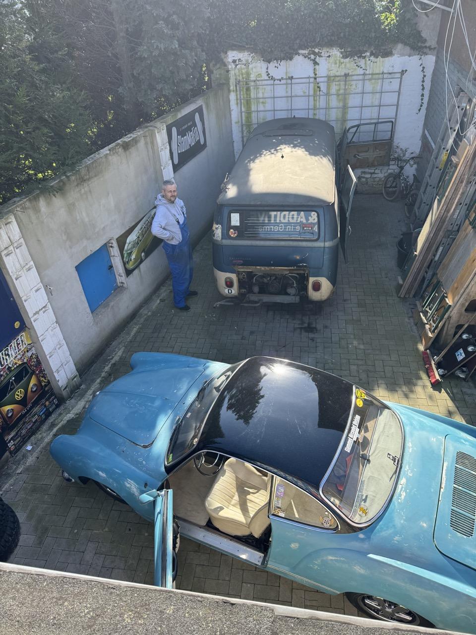

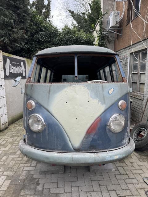

lets start with a bit of the story how i found the bus in the neighbourhood.
the bus was sitting around 50m from our workshop and was too cheap to not buy it.
So in march last year we pushed the car over an directly started to pull the engine out.

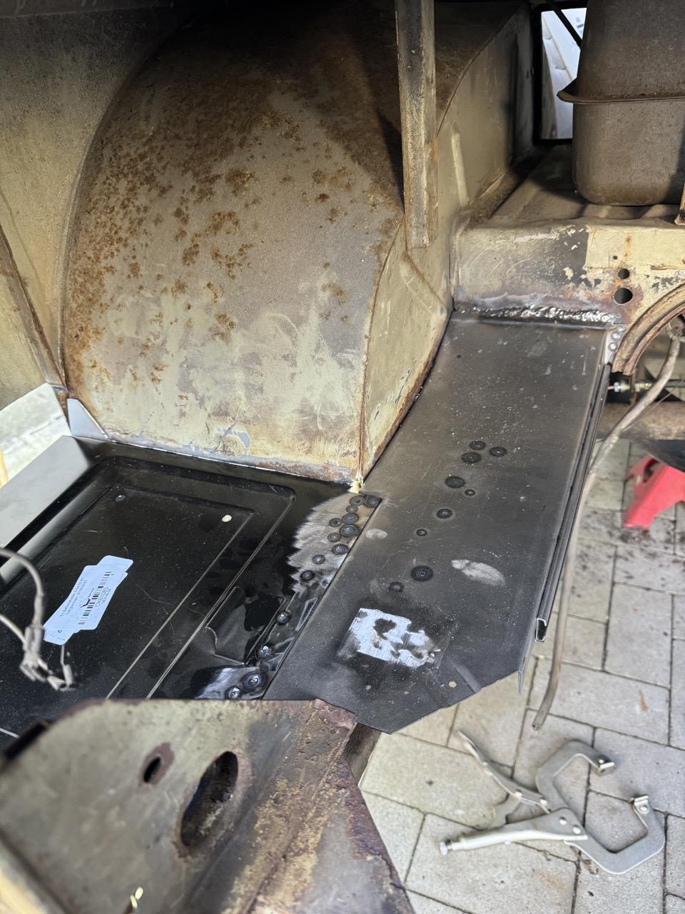

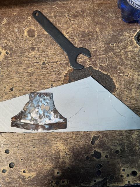

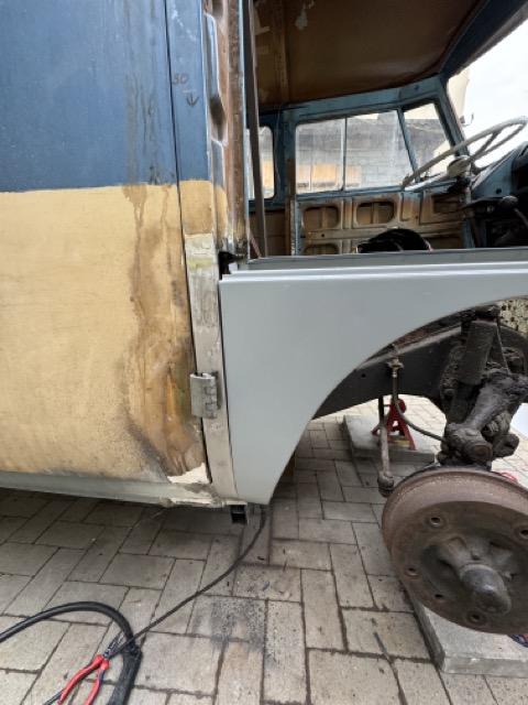

before we look at the welding pictures, i have to say that before the bus was pushed over to our place, i never had a weldingmachine in my hands.
the whole project was about learning as much as possible and to make it as affordable as possible.
Some of the welding i did at the beginning was not too pretty but i became better the more i did. (as always i believe)

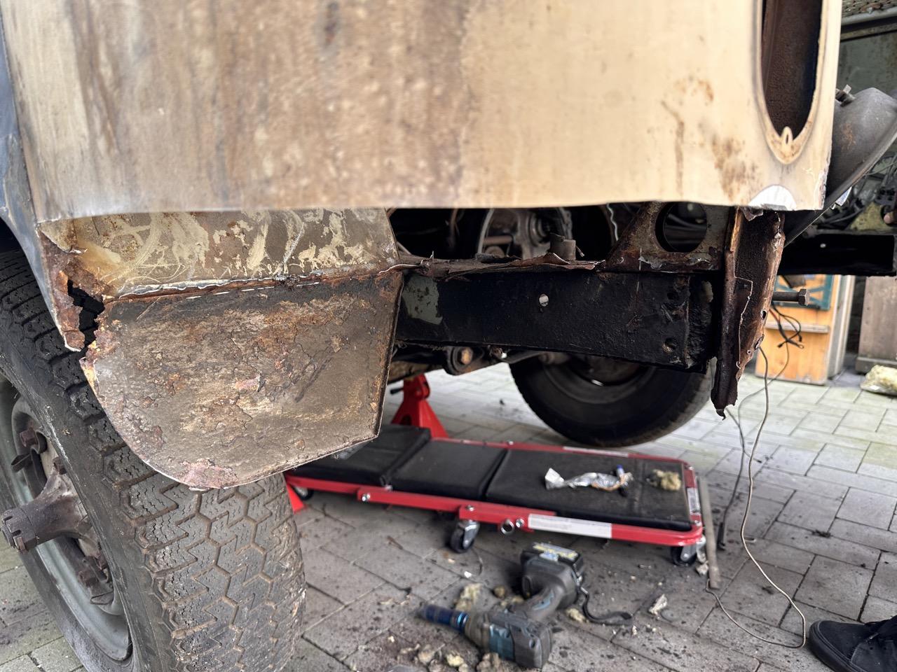

so, first things we welded in were the battery floor on the left and the left corner:
shoebird
Joined: September 15, 2021
Posts: 20
Location: Duisburg Germany
shoebird is offline
PostPosted: Thu May 15, 2025 3:41 am    Post subject: Re: 64 light grey bus from duisburg/germany Reply with quote

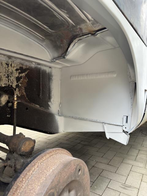

next steps:
wheelarches with tubs:
the jackpoints as well:

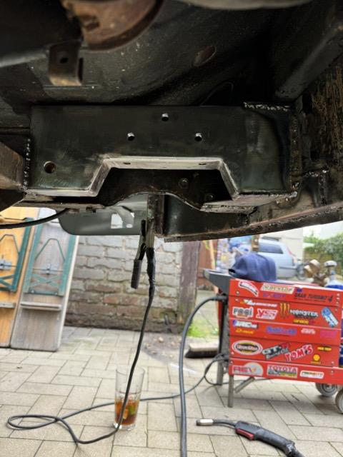

and parts of the frame:

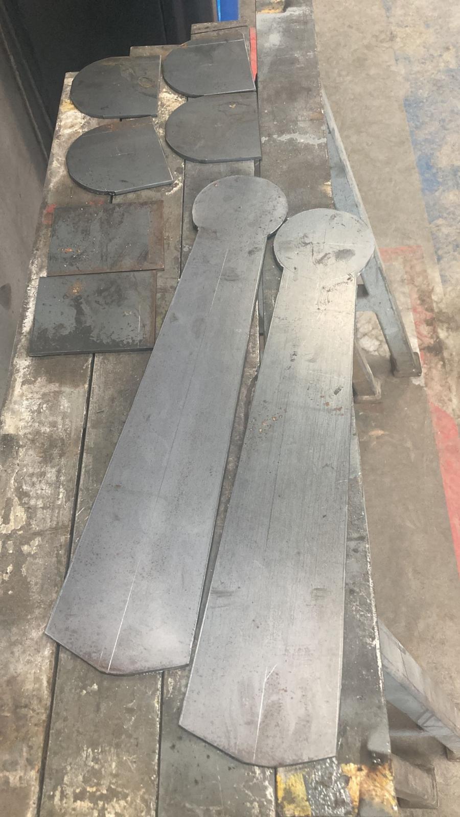

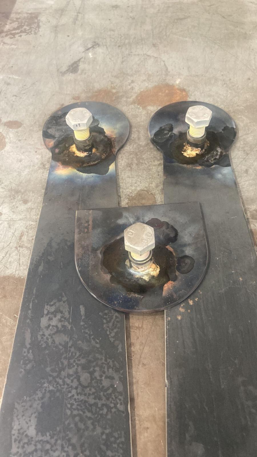

as you might noticed, the partition wall was missing when i got the car.
i think someone wanted to build a walkthrough until he noticed that there is the toolbox in the way. i already ordered a new wall but came to a (for me) better solution.

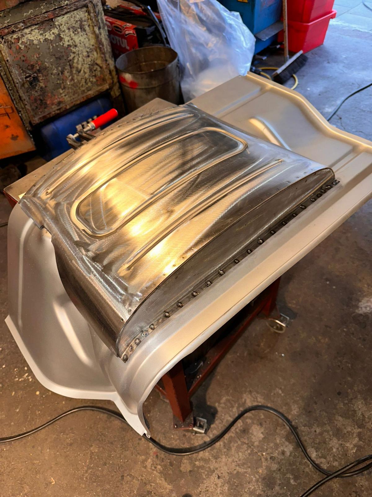

A flipseat!
but where the hell you find a flipseat?
so i decided to build it myself. how hard could it be? Very Happy

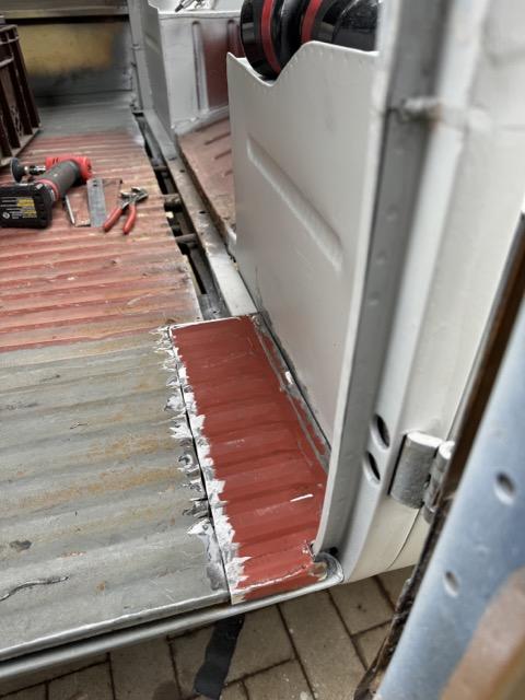

the floor was closed with some leftover parts from other repairs:

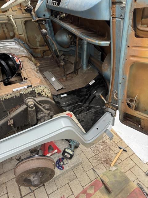

doglegs and floor was next:

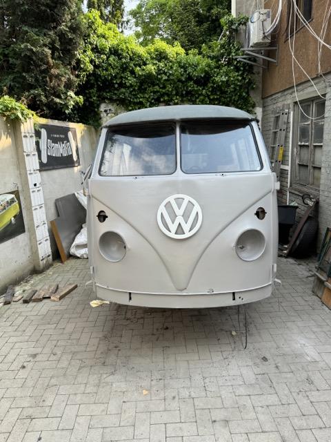

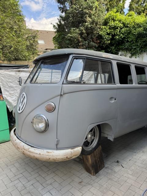

meanwhile i scored some sprintstars for way too cheap

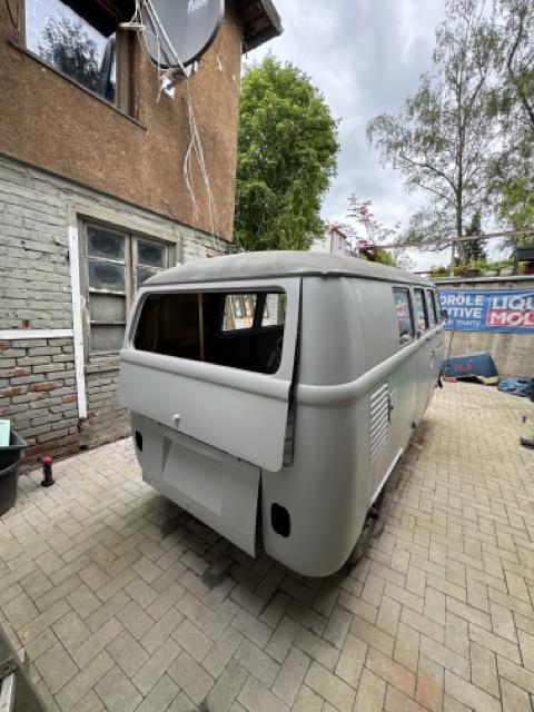

could not resist to sand the car a bit and primer it.
i decided to do some kind of "faux patina" because there was basicly no original paint left on the outside of the car. i believe somewhere in the bus´life they removed all the original paint and painted the car brown and some years later metallic blue Mad Mad
and a little mock up whith wheels and a bumper to keep the motivation high

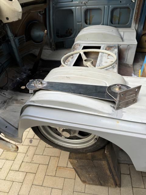

at the same time i made some progress with the flipseat:
and managed to weld in the riser for the steeringbox
