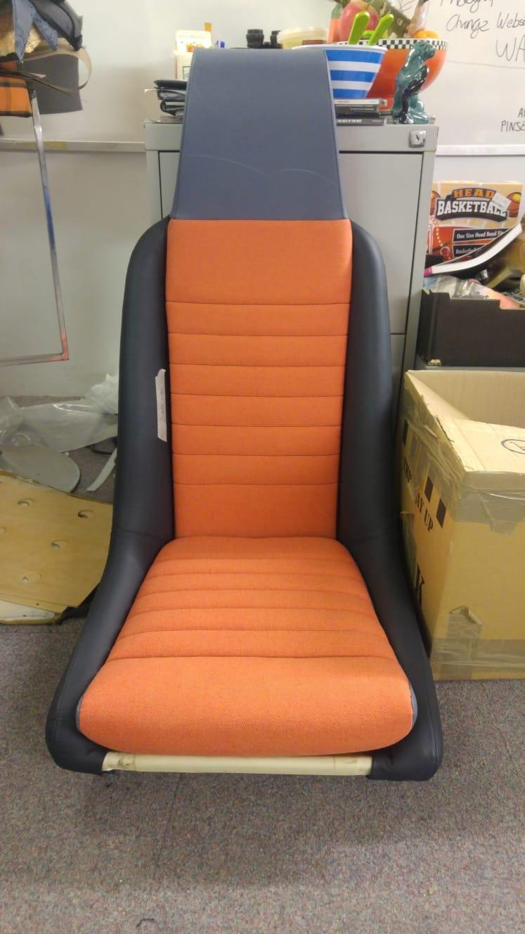

PostPosted: Thu May 29, 2025 5:55 am    Post subject: Re: Long running Custom Bay project - the Rebuild Reply with quote
So, a little sneak peak of the current rebuild and the start of the interior...
dpetteng
Joined: November 14, 2006
Posts: 389
dpetteng is offline
PostPosted: Thu May 29, 2025 6:20 am    Post subject: Re: Long running Custom Bay project - the Rebuild Reply with quote
and before people ask, the interior is templated... final colours to come!
