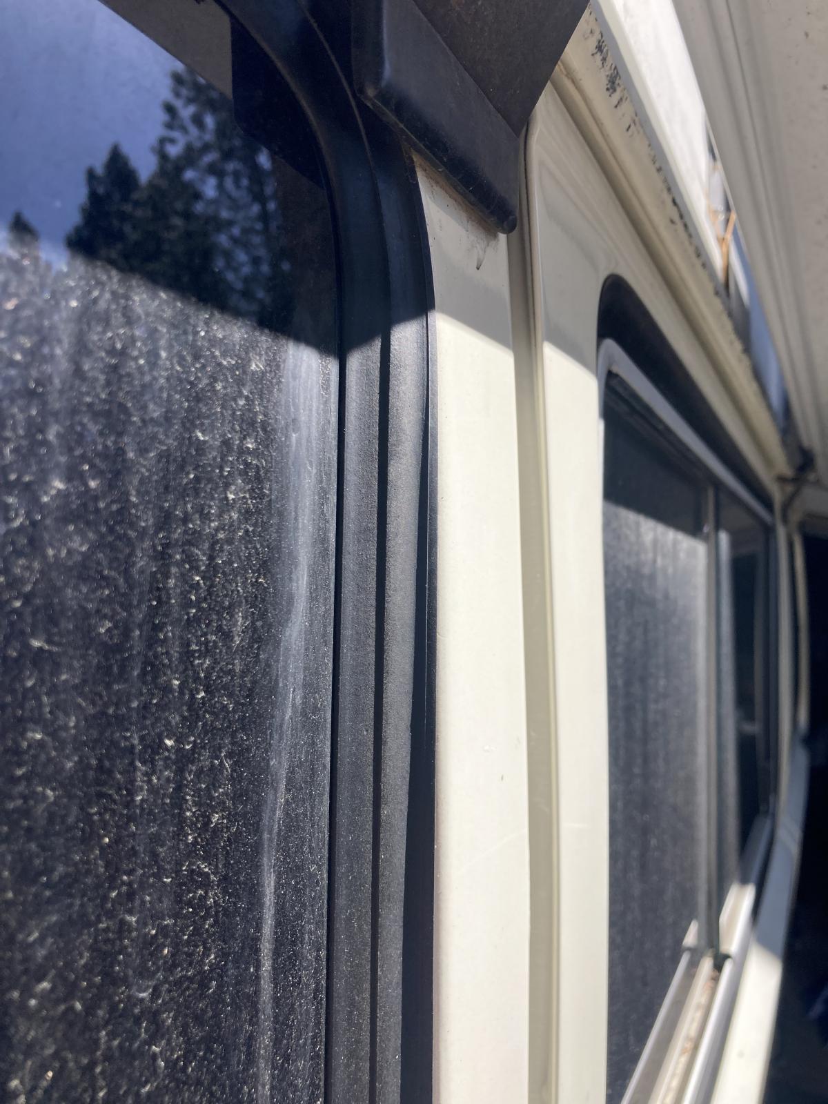

Trying to get my sliding door a bit happier. I replaced all of the rollers and latch springs. It feels good and closes nicely, except the rear upper corner sticks out away from the c pillar by about 8-9mm. All of my vertical gaps look pretty good(to me) and the bottom of that rear gap is flush with the body. Im not having any success pulling that corner in tighter, Ive consulted bentley and tried some adjustments but no luck. Thoughts or ideas?
When i got the van the door function and alignment were way off. It was so bad Im not sure I would of noticed what Im fighting now…

PostPosted: Tue Apr 15, 2025 1:29 pm    Post subject: Re: Official lazy person's stupid question thread Reply with quote
My slider does the same if not closed rather robustly. I usually put my left hand on the back end of the door and give a little push to help it along. Seems to do the trick. YMMV

PostPosted: Tue Apr 15, 2025 1:31 pm    Post subject: Re: Official lazy person's stupid question thread Reply with quote
^^^ similar option to add a pull handle on the inside ^^^
https://www.thesamba.com/vw/forum/viewtopic.php?p=6025278

PostPosted: Thu Apr 17, 2025 7:25 am    Post subject: Re: Official lazy person's stupid question thread Reply with quote
Just to be clear your top corner sticks out not the entire edge?
Ive tried a variety of door shutting speed/force and I cant get it flush. Im wondering if the arm is bent?? Possibly shim or replace. Dont really want to replace since i just paid for all the new rollers…

PostPosted: Thu Apr 17, 2025 7:50 am    Post subject: Re: Official lazy person's stupid question thread Reply with quote
Look at the gap between the lower left corner of the door and the quarter panel as compared to the gap up top. It's almost touching at the bottom and there is a .25" gap at the top. What's going on at the leading edge? It is touching at the top and a gap at the bottom? Is this an earth or post '85 model? They have different latch assemblies.

PostPosted: Thu Apr 17, 2025 9:21 am    Post subject: Re: Official lazy person's stupid question thread Reply with quote
[Just to be clear your top corner sticks out not the entire edge?]
No, sorry. Whole door sticks out evenly. Your door sounds like there is something bent or not aligned properly.

PostPosted: Thu Apr 17, 2025 10:06 am    Post subject: Re: Official lazy person's stupid question thread Reply with quote
Hans
I think the camera angle may have distorted the view of the gaps.
I just went and measured all four corner gaps in relation to the body pillars.
Front upper 5.30mm
Front lower 5.24mm
Rear upper 8.92mm
Rear lower 7.55mm
