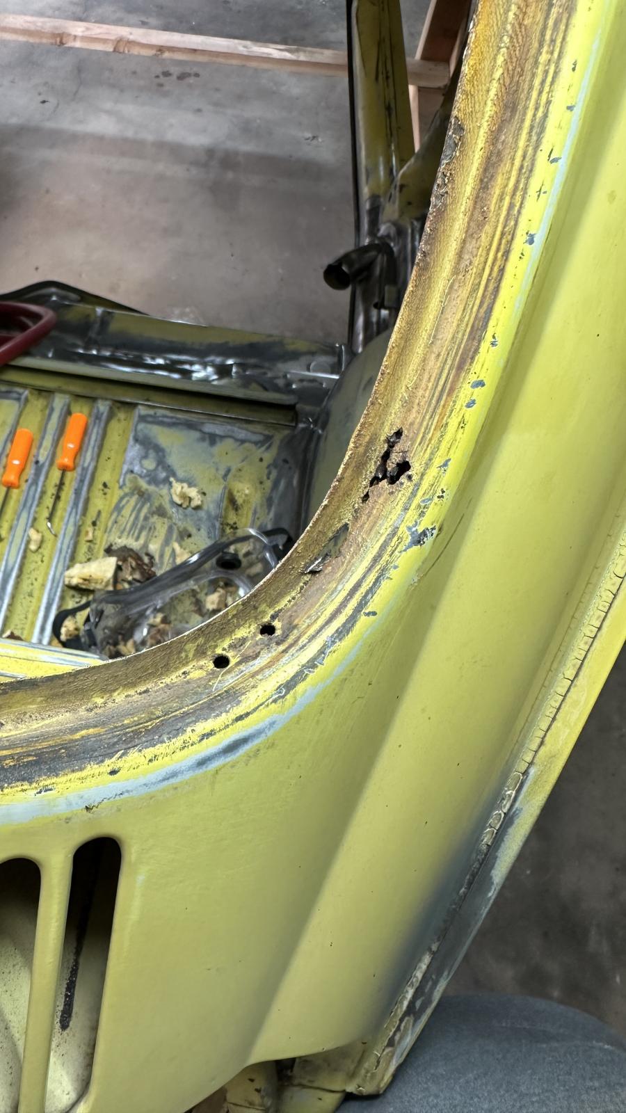

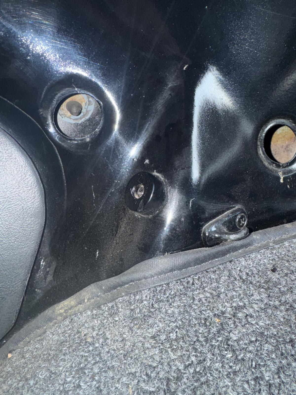

My wife has been pointing out for a while now that there is always a strong smell (to her) of exhaust fumes in the cabin of our car. I’ve been riding in and driving old cars since I was a kid so I don’t really notice it that much, but I feel I should try and get to the bottom of it.
My car has had the heating system removed so it’s definitely not anything to do with heat exchangers or anything like that. All of the holes under the rear seat appear to have been patched and sealed properly.
While checking around for the source of the fumes, I discovered 2 holes in the sheet metal on each side of the car, directly beside the rear seat back. They appear to be factory holes to allow access to something behind the metal, possibly the fasteners for the exterior trim piece. Could these holes be the source of the exhaust fumes being drawn back into the car? Are these holes supposed to be plugged and the PO didn’t bother replacing them after the car was painted?
I’ve attached some photos for reference.
Thank you.

Assure the engine bay pillows are installed. These go in the pillar openings on either side of engine bay, these will keep fumes out and reduce noise. see link
https://www.thesamba.com/vw/forum/viewtopic.php?t=734234&highlight=pillows
in our old Bugs the pillows were made of upholstery scraps, later bugs used expanding foam the expanding foam however tended to trap moisture between it and the sheet steel, resulting in bad rusting. The cloth pillows can breathe, and thus will not trap water. many late Bug has this area, right behind the rear quarter window rust thru completely do to the expanding foam.
use of pillows can prevent the smells from getting from engine bay to the cabin
check that yours is present.

There was someone selling reproduction pillows for the engine bay but I'm not finding them now. They were triangular shaped. Really any kind of fabric shoved in the cavity would work.

put the tool box on the floor. Front end collision will turn it into blunt trauma to the back of your wife's head.
As for your concerns over the holes, maybe fill the holes with expanding foam from a can.

No, foam can hold moisture against the body, and thus cause corrosion.
Them holes can be covered with tape. HVAC aluminum foil tape will work well on them there holes.

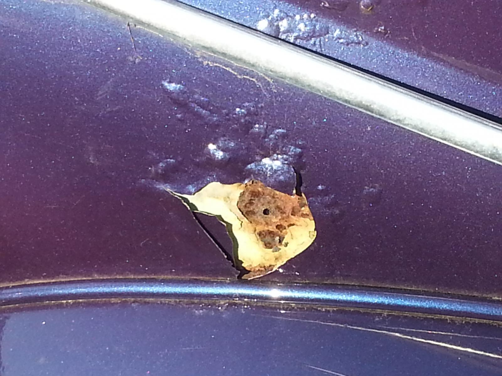

Water may enter via the window seals leaking as there is a pathway in the window channel. Water may wick in via the fender bolts. water may wick in at roof seam.
Water may enter from washing engjne bay. in cold humid conditions, condensation can also wet the foam by water dripping down the C channel from roof arch.
Note in the photo the drain holes in window seal channel, and caulking cracks at roof seam, two possible pathways for water to enter the death foam zone.
I highly advise against the use of the foam.
