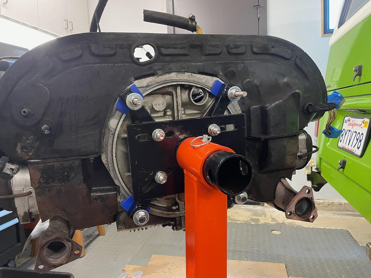

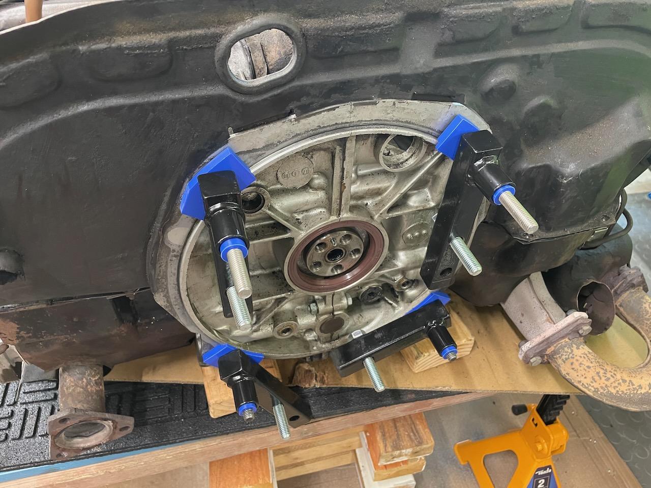

olafwagner wrote:
I purchased the 'Vevor' engine stand from Amazon. I got the 1300 lbs version, not because of its carrying capacity, but rather because this one specifically has the 'U-shaped' footprint, which allows me to put something directly underneath to catch oil/dirt etc.
This stand, however, doesn't fit well onto the VW engine as is. So I 3D printed some spacer tabs that fit perfectly onto the case, and over the protruding lip as well. (I printed these with basic PLA, but with 100% infill). (Yes, I can already feel many people on this forum's eyes rolling, but seriously under compression these parts are more than strong enough).
The next problem was that the holes in the black arms are much bigger than M10 bolts, so I 3D printed some sleeves to fill this space. (also in basic PLA with 100% infill).
The final piece was that with the original hole locations, the mounting arms were spread too far out, so I drilled a second set of holes more 'inward' on the mounting arms.
I purchased two M10x120mm bolts for the two upper holes, and use the existing M10 studs for the two lower holes, and mounted the engine. Everything is very sturdy.
Here are the pics...
Olaf has sent me the files to try.

PostPosted: Sat May 31, 2025 9:04 am    Post subject: Re: Question: What to look for when buying a used engine stand Reply with quote
I’m not digging that idea.
