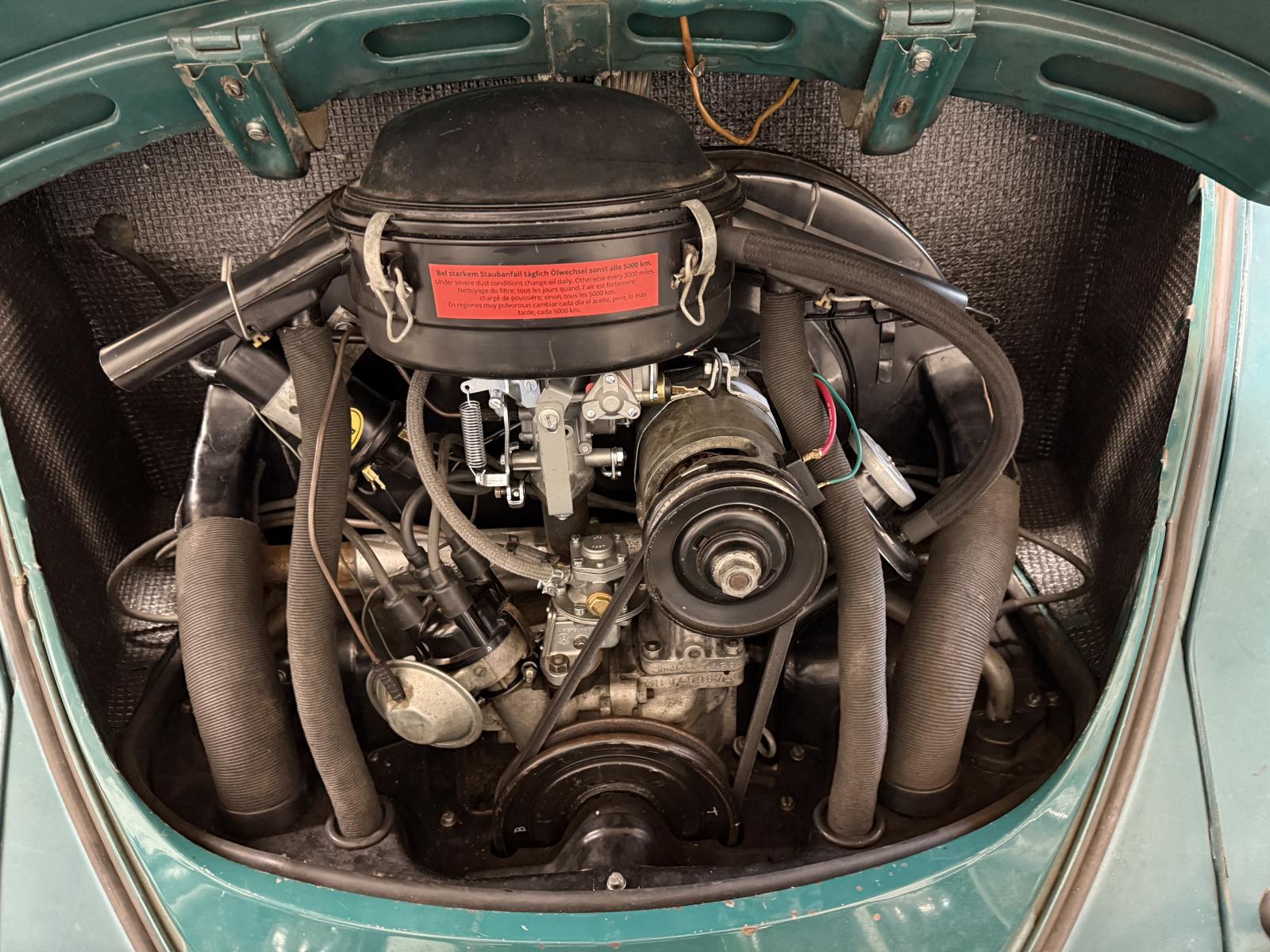

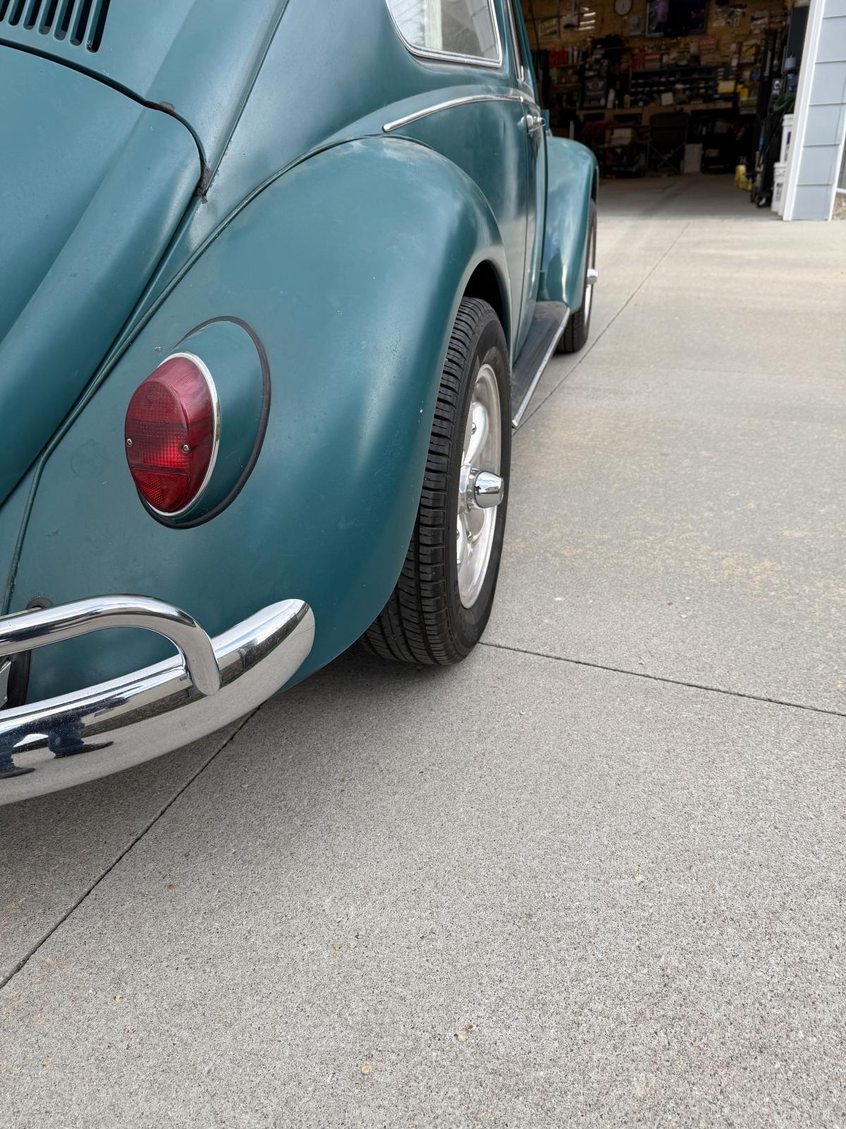

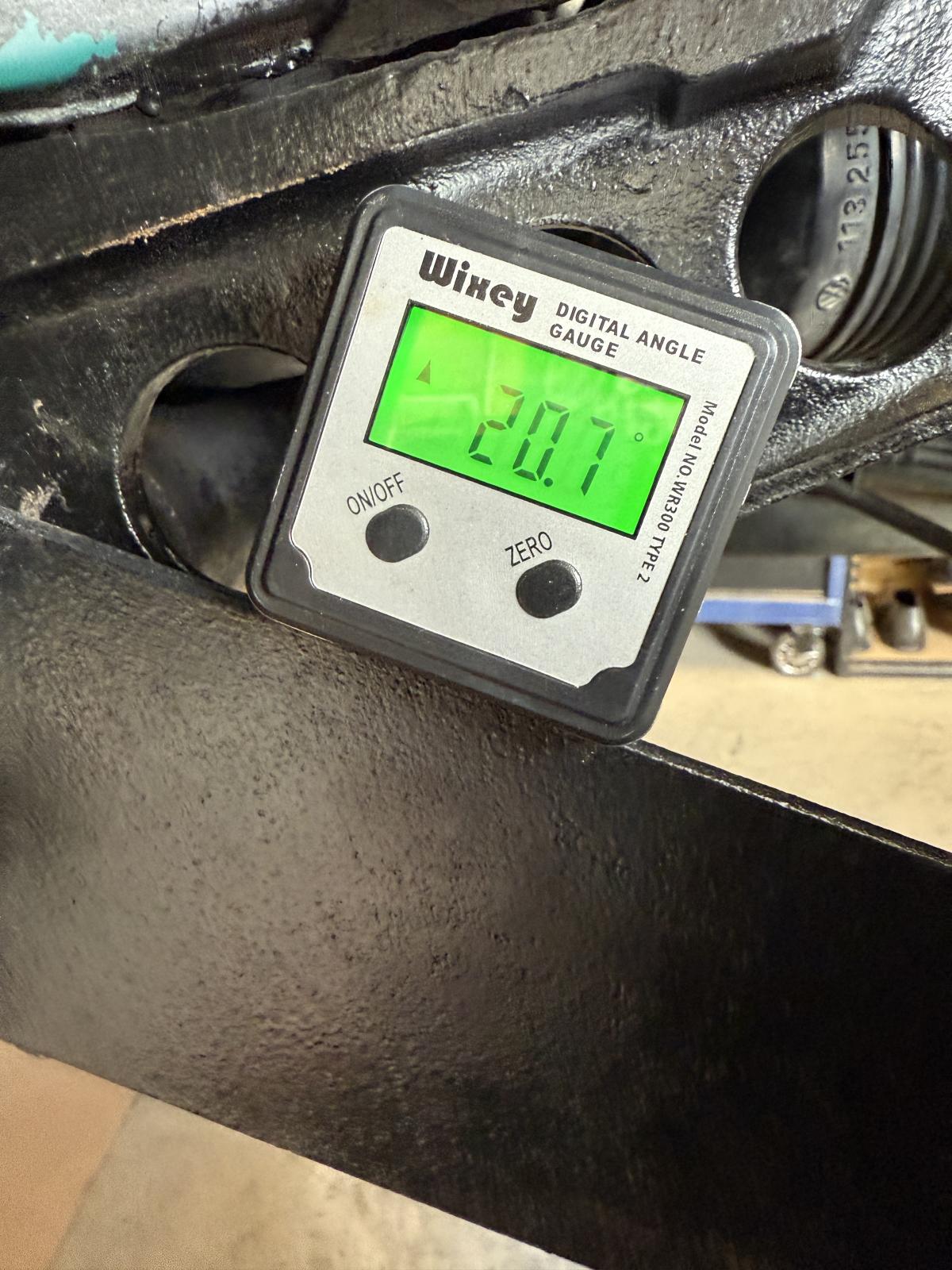

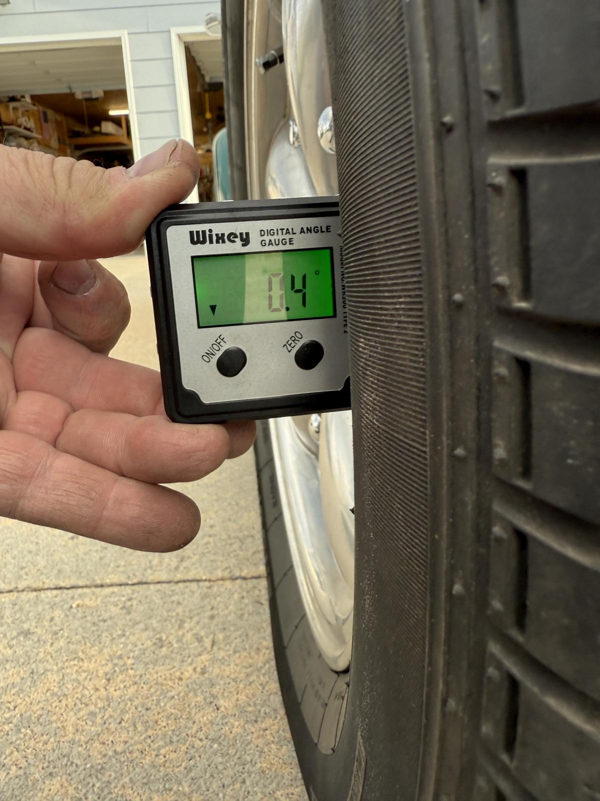

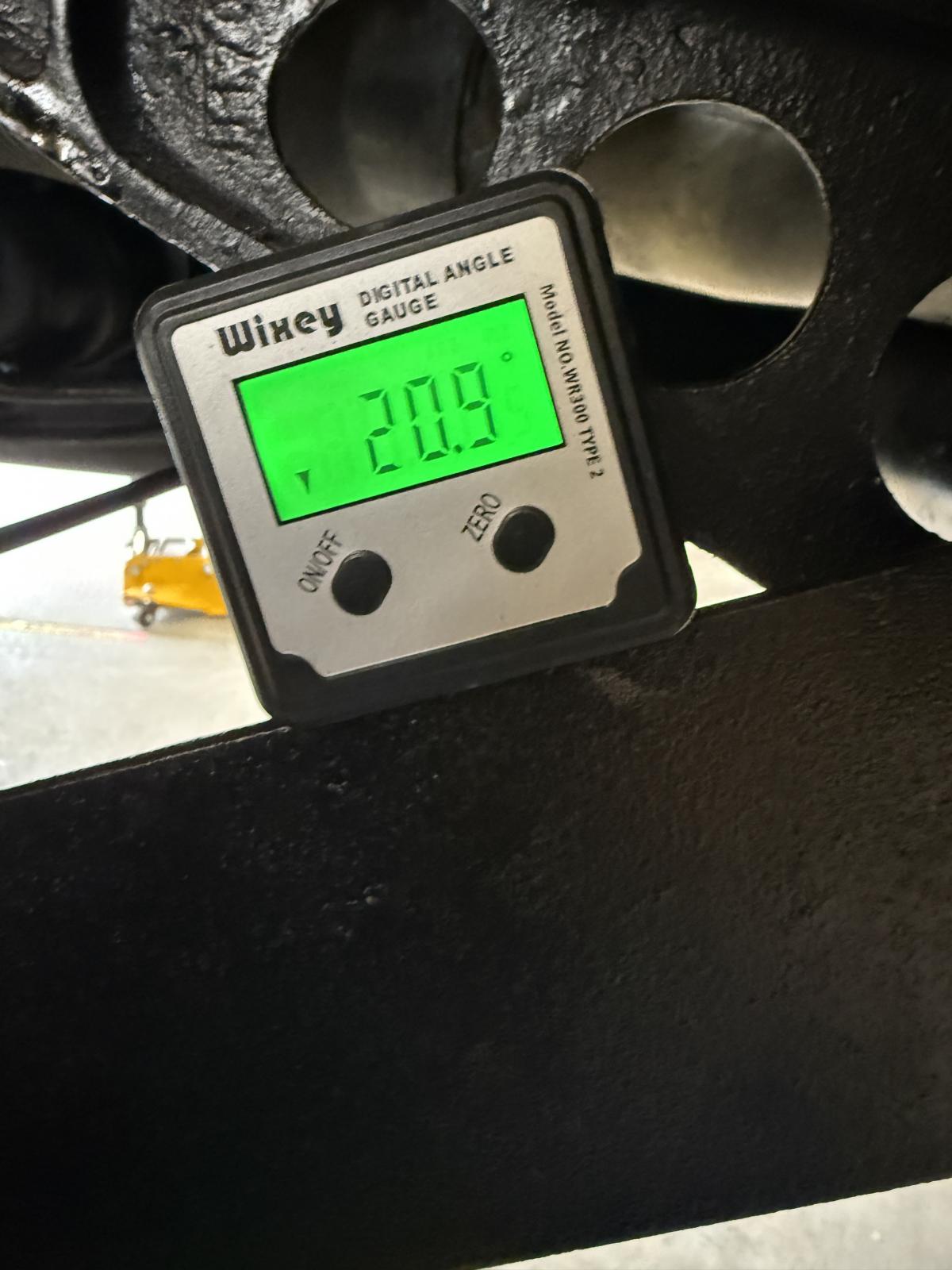

I re-indexed the rear torsion bars today. When I first got the car, the rear end was sagging badly. The untensioned angle of the spring plates was about 17-18 degrees. Bentley says it should be 20.833 degrees for a 1500 equipped with an equalizer spring, which mine has. So I reindexed the torsion bars and put it all back together. I thought I was being smart by over compensating for “tired” torsion bars, but I ended up with about 3 degrees of positive camber. Oops.
Today I tore it back apart and re-indexed the spring plates to the recommended 20.833 degrees (20 degrees, 50 minutes). It ended up as close to spec as possible I think.
Here are some pictures of the finished product. I still need to get an alignment, but that’s on the list!

Looks good. It’s always easier the second time! Laughing

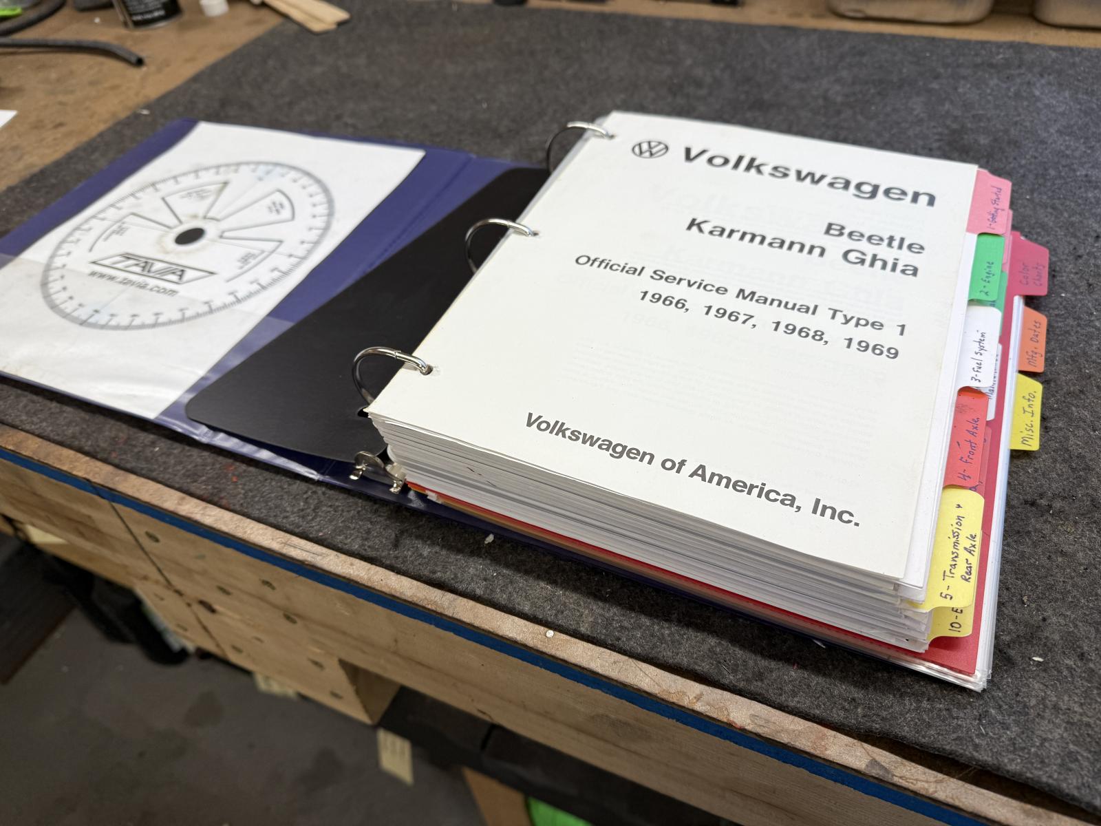

I’ve been meaning to post these pictures as a suggestion for anyone who finds it helpful. I bought a new Bentley manual because my old one is tattered and greasy. I took the new Bentley to a professional print shop and had them cut off the spine, scan the whole book as a high quality PDF, and then 3 hole punch the pages.
I’m in the process of bookmarking all of the chapters and subsections in the PDF for quicker reference. I’ve used the PDF a few times to print a page so I can lay it there without caring if it gets greasy or ripped when I’m working on something.
I put it together in a binder and I really like it. I’ve added a few of my own odds & ends pages at the back - stuff I came across and wanted to keep for reference.

Great idea! I had my green bus Bentley spiral bound at a shop years ago. The tech didn’t do a 100% job on it and the spiral binding went though the text on the margins in some places, so I was bummed about that. But the overall format was significantly easier to use as a mechanic. I really like the idea of scanning and printing soft copies. That’s what we do at the day job (well it’s night shift but whatever) with our manuals, print em and take them out to the job. I much prefer to throw out grubby paper vs leaving forever fingerprints on an important paragraph Smile
The binder format you did looks better than spiral bound to me.

I thought about spiral binding, but I liked the idea of being able to replace a smudged or torn page by printing a new one from the PDF, so I went this route.
They make stiff plastic 8.5x11” three ring divider pages, which I inserted between each chapter. Makes it easier to flip to the chapter I need without stressing the holes in the pages themselves. If I do get grease on a page in the binder, I can just print a replacement from the PDF.

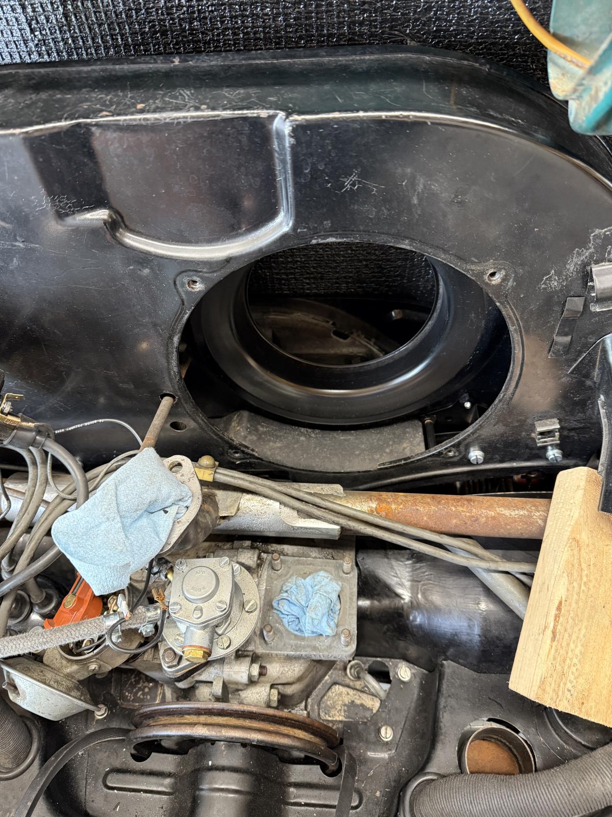

Here are a few more pictures. It’s running really good and I’ve been driving it around to give it some exercise.
Oil puddles under the crankcase breather tube led me to discover that the oil deflector at the base of the generator stand was missing. Turns out it was relatively painless to replace. Of course, I forgot to take a picture of the new one correctly installed, but oh well:
