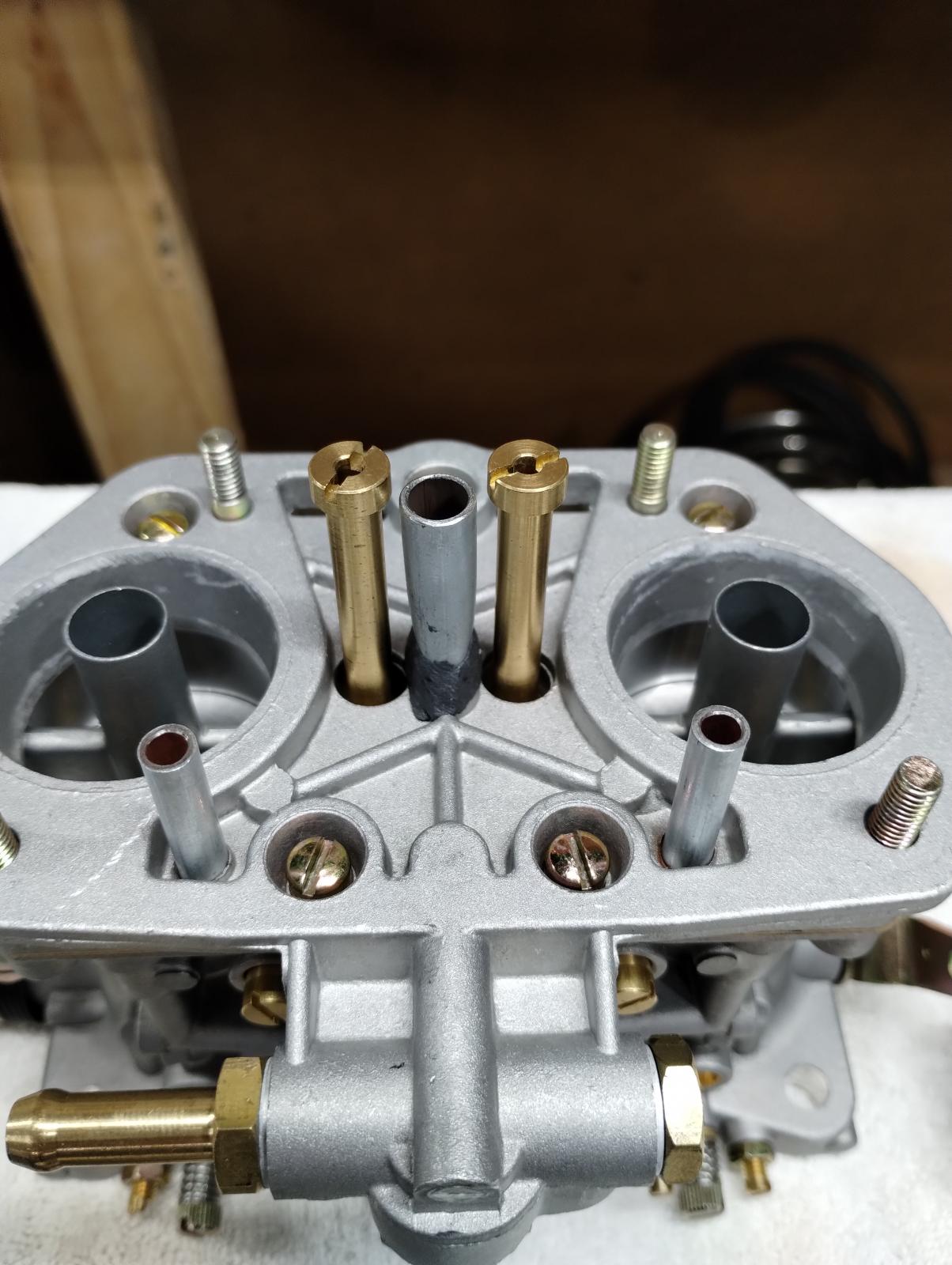

Next project will be to install "weber windows", so it will be easier to get to the idle jets, and to adjust idle mixture.

You don't need CB anything to make it work right build your own jet doctors and a vent tube extension. Its stupid simple use steel fuel line drill for a press fit done deal. For the vent extension JB steel stick
