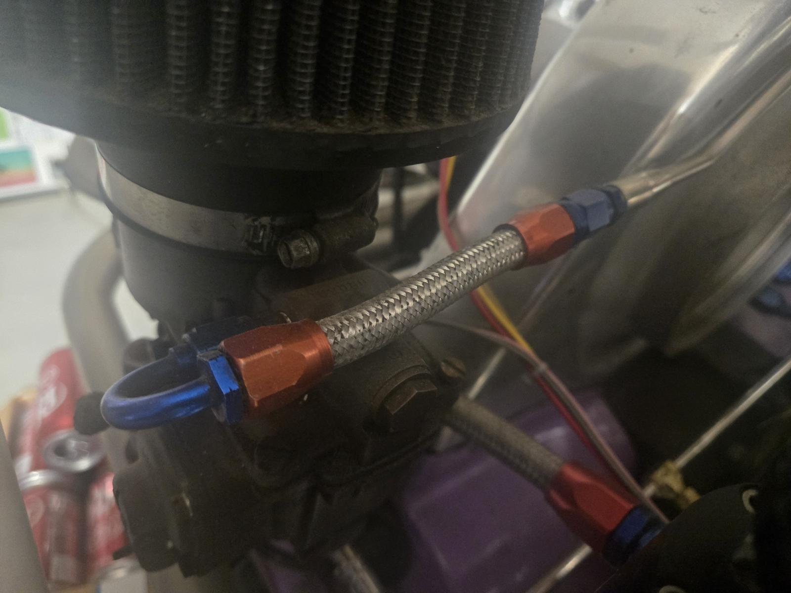

I'm currently in the process of doing it on mine too, I used -6.
What I am mainly concerned about with mine is the fittings on the carbs, as I don't have threaded fuel inlets, they are press in brass fittings.
(Ignore the leak... has be dealt with)

As long as uoi use a qualitÿ fitting and insrall it well, tgere is no problems using a compressuon fitting for your AN adapter. I had to use them a couple of times and have nevrr had a leak.
