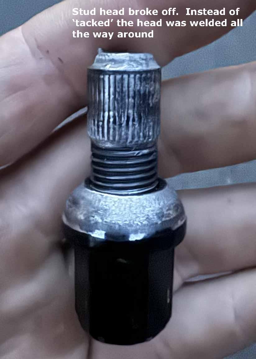

Agreed, wheel studs are frikkin' strong.
They are often heat-treated high-carbon steel, like a grade-8 bolt.
?Waldo? wrote:
Wheel studs don't just snap without something being significantly wrong. They were either defective,
the wrong studs for the wheels, or not torqued correctly.
If the studs serrations don't fit tight enough, sometimes they are tack-welded.
When you can, take a look at the stud heads, see if they have been welded.
Sometimes the wrong stud doesn't go ion tight enough,
and a common fix is to add a little 'tack weld' to prevent the stud head from spinning under torque.
If this option is chosen, the tack weld should be as small as possible, and just hot enough to achieve sufficient penetration.
All this weld has to do - is prevent the stud from spinning, a task similar to the press-fit of the serrations.
The little tack weld weld should be done with the stud "tight".
Studs are often high-carbon steel and as such are not considered "weldable".
If welded all around, a high-carbon steel stud head could crack near the weld upon cooling
and of course it's ready to break off.
Here is a pic of a broken stud, ---->the head was welded all around.
I heard the towing bill was more than $1000 for this incident. Shocked

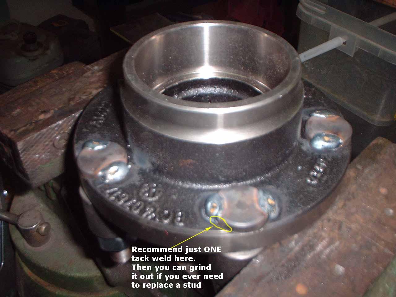

Here's a pic I found on TheSamba of tack-welded studs.
This is significantly better than welding all-around the head.
But IMHO this is still too much welding on a high-carbon steel bolt.
I'd just put one good tack,
AND|.... in a location where a cutoff-wheel can get to the weld in case you ever need to change the stud.
