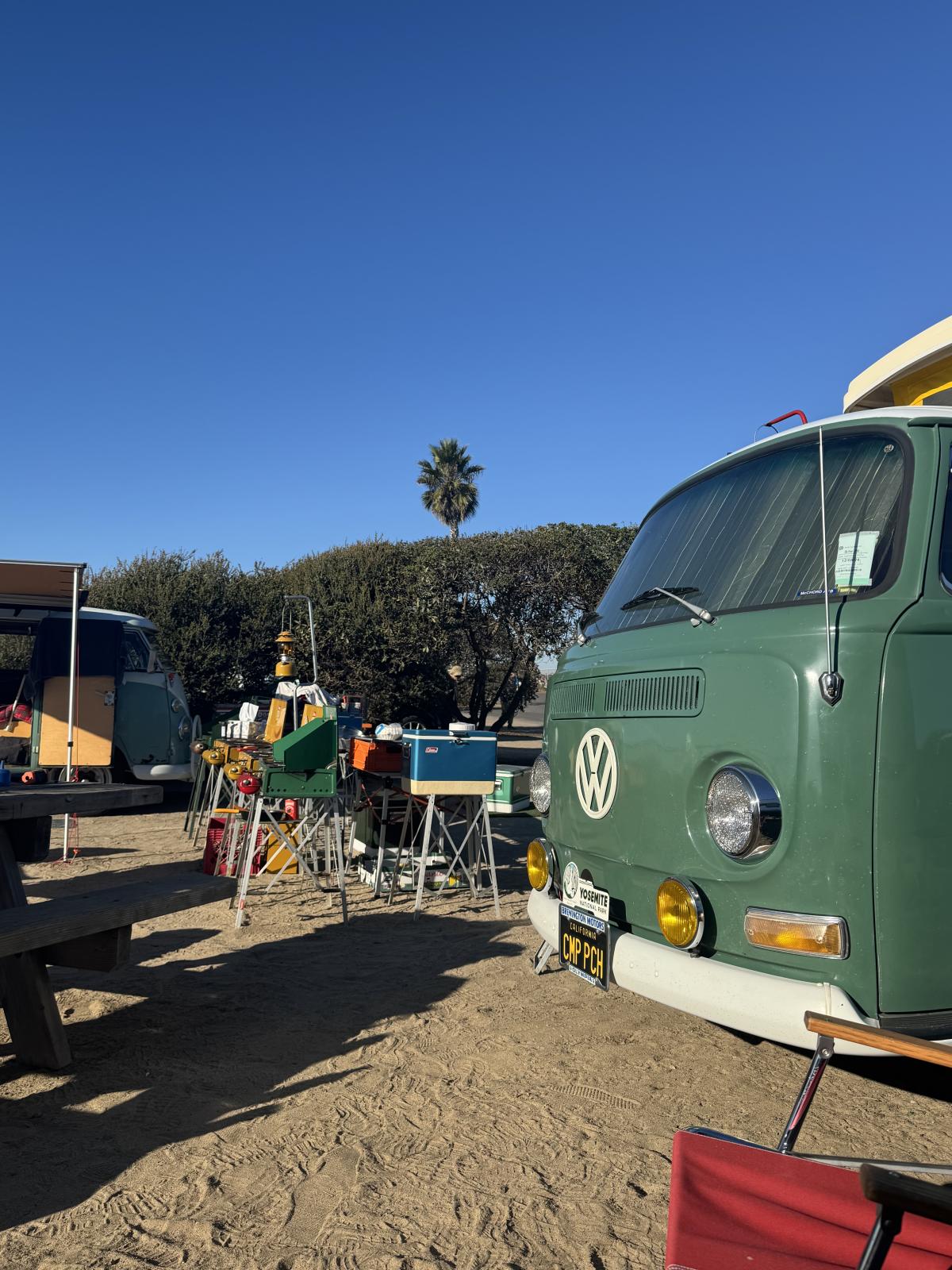

Doug Would Go Invitational at South Carlsbad State Beach. Perfect weather and lots of cool folks, barndoor buses and great food.

Very cool! Can I ask, why the yellow ramps?

Cheap leveling ramps from Harbor Freight. This way you don't wake up with a headache. Although the beers may be the real problem. Razz

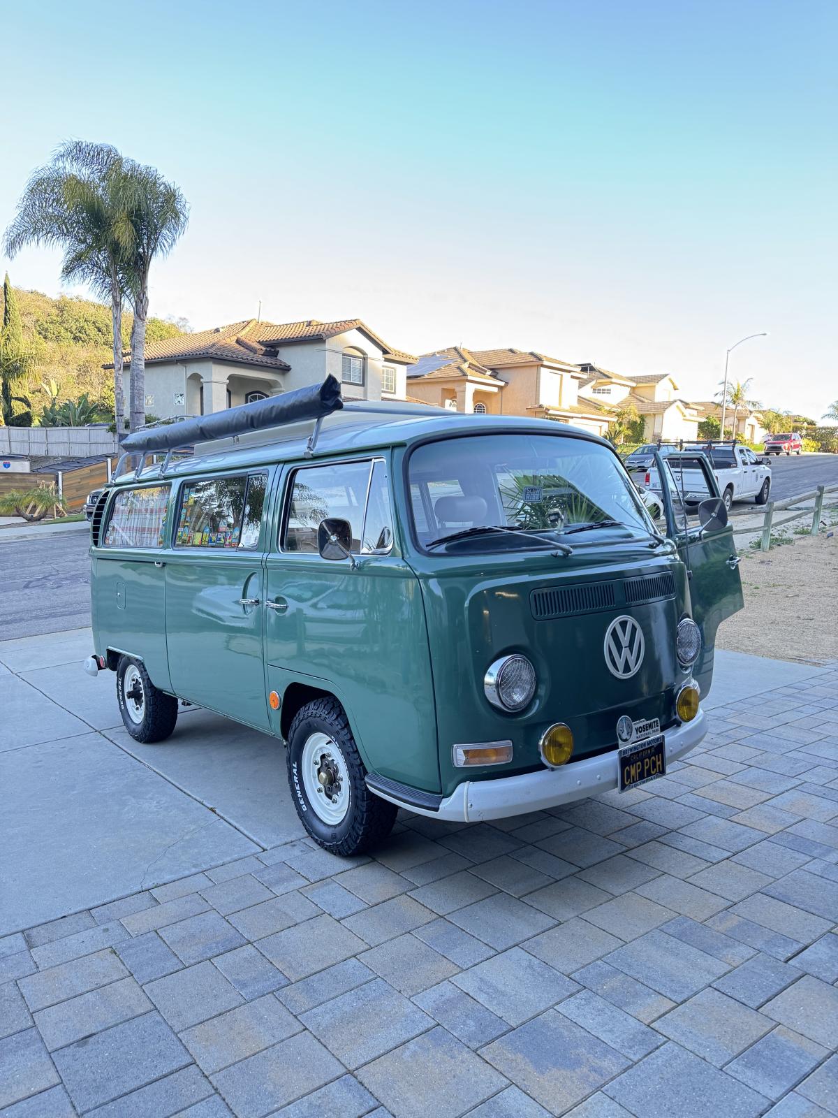

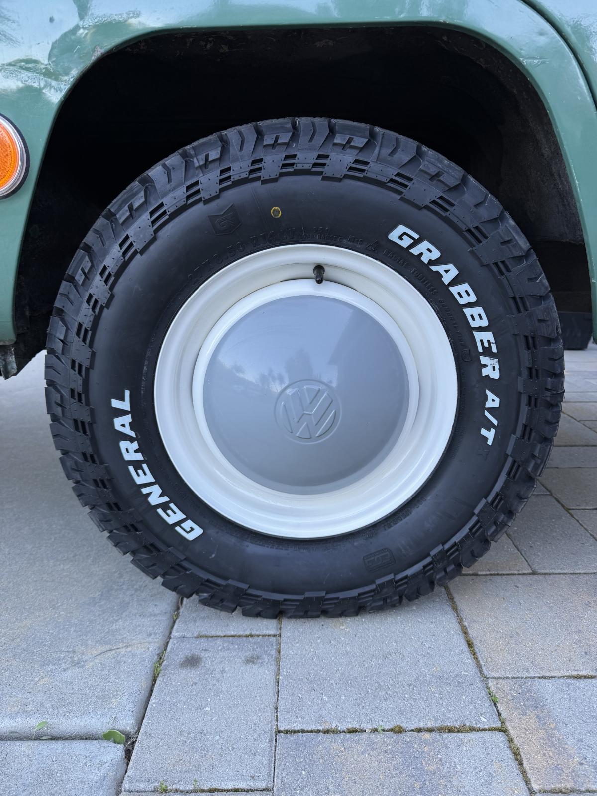

New shoes.
Powder coated the wheels and mounted General Grabbers. The first shop that mounted and balanced the wheels used the stick on weights on the inside of rims. The weights hit in the rear on the backing plates. I took it the wheels to an old school shop and they removed the first weights and used clip on weights on the inside lip. All set.
I like the ride quality. I sit about an inch taller now as compared to the Hankook 185 r14's. No rubbing.

Love your bus. I have those same tires on my truck, but maybe an older version. They've been great - both on and offroad. You'll be happy with them. Happy travels

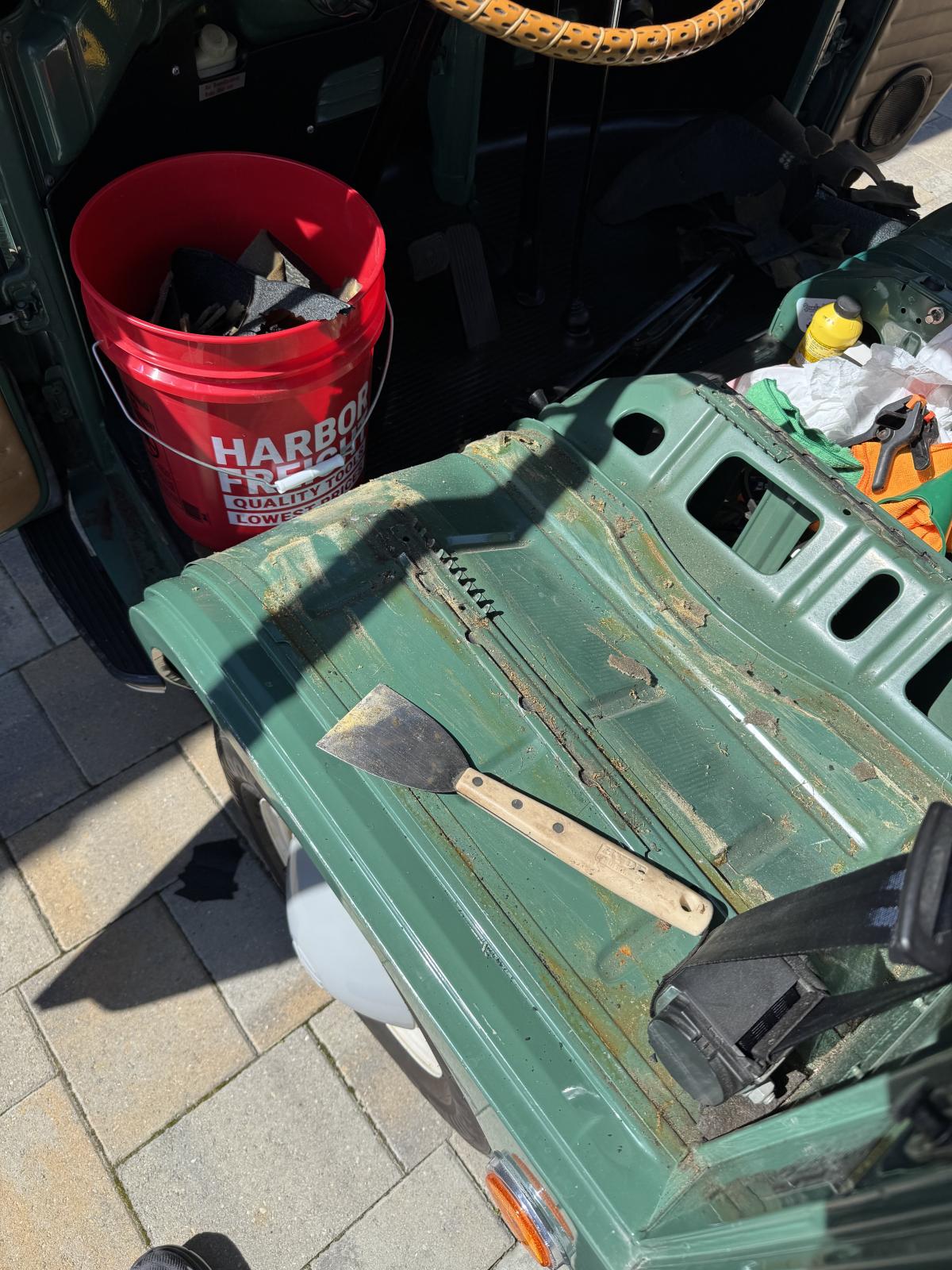

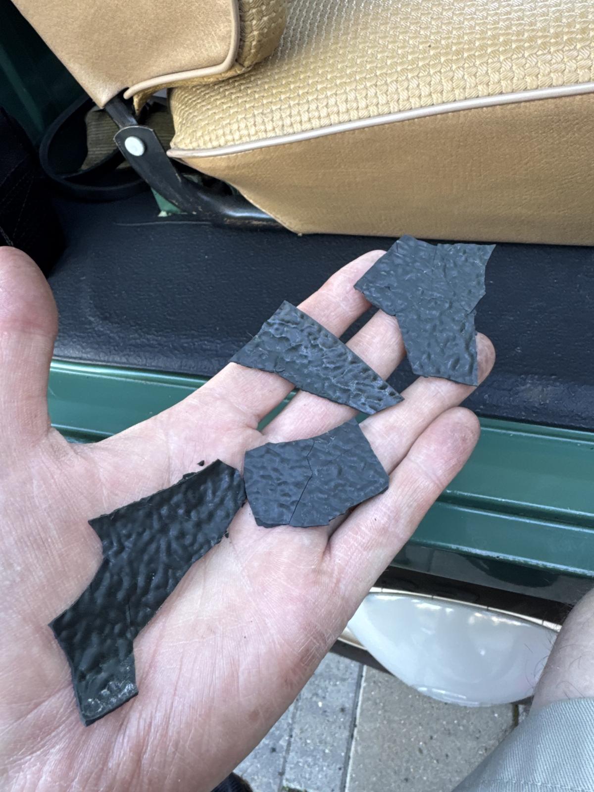

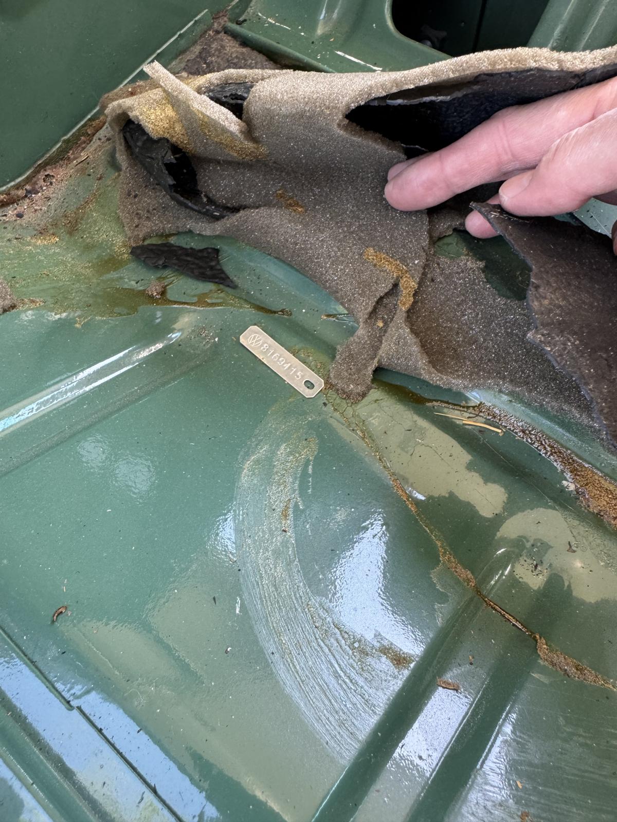

It finally came time to change out the original seat stand mats. They were so crunchy that they were chipping apart. On the passenger side I found the original key fob VIN tag. It was under the original stand mat so probably in there from Germany.

Looks good and great find! Where did you source replacements? I am in the same boat with my 68, the covers have fallen apart.

Wolfsburg West for the seat stand mats. They are a decent fit but the cut lines for the seat rails and seat belt hardware are not in the exact right place. Overall I give them a 7/10 but I don't know of any other options.

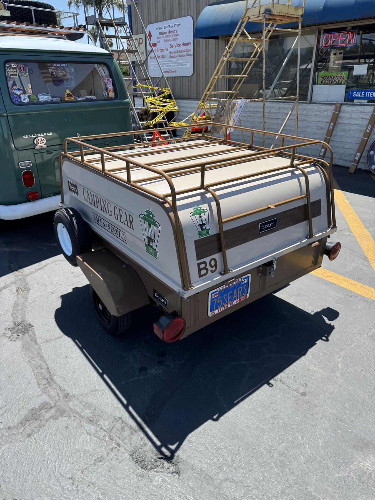

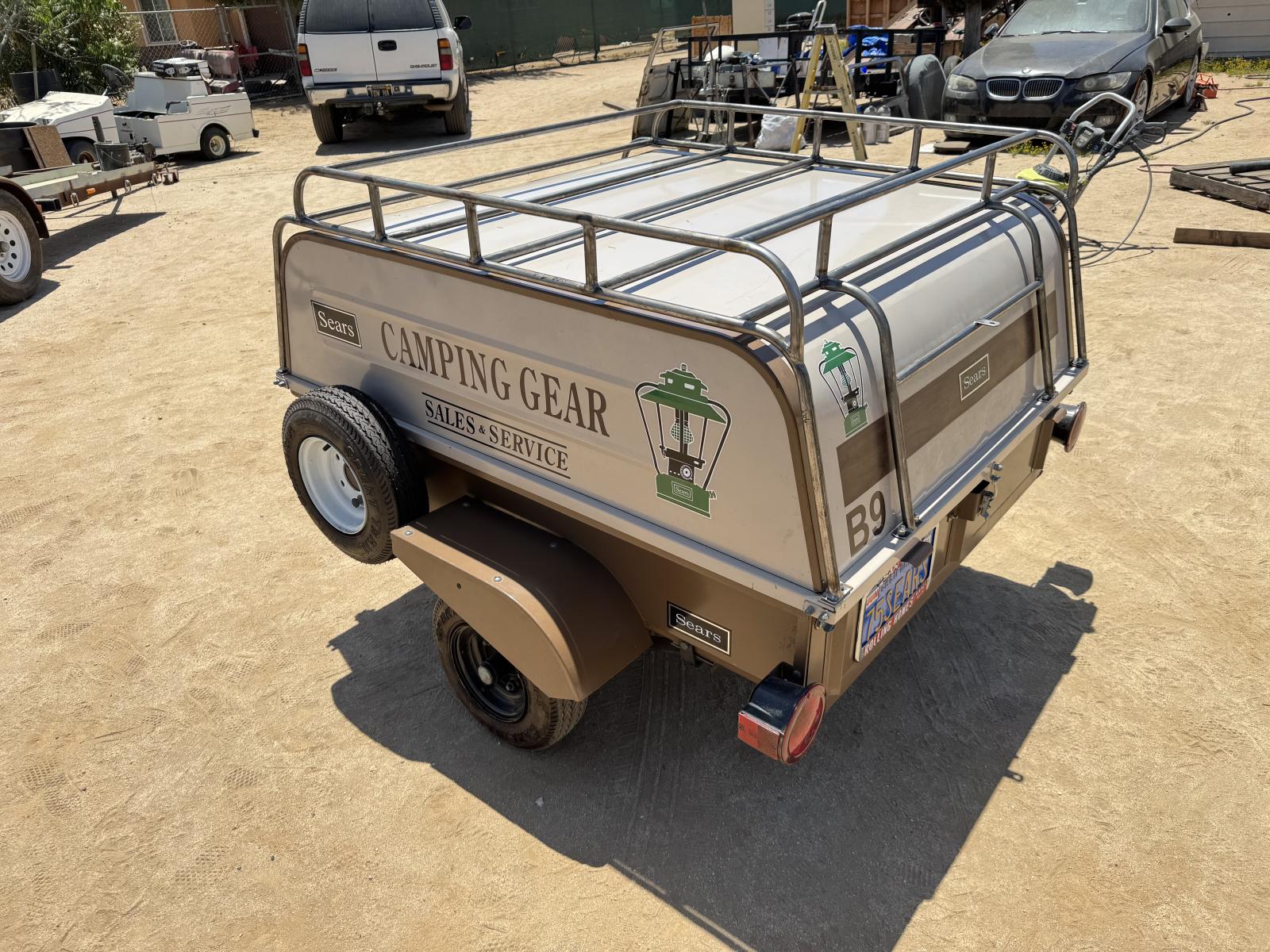

Had a roof rack made for the trailer. See it at OCTO this weekend.

That’s a fantastic bus. Really like the vintage camping gear. I have similar stuff. Always preferred low tech camping. Simple and lasts for ages.
I bought the same motorcycle carrier from HF to carry a vintage Vespa. I will probably have to modify it like you did.

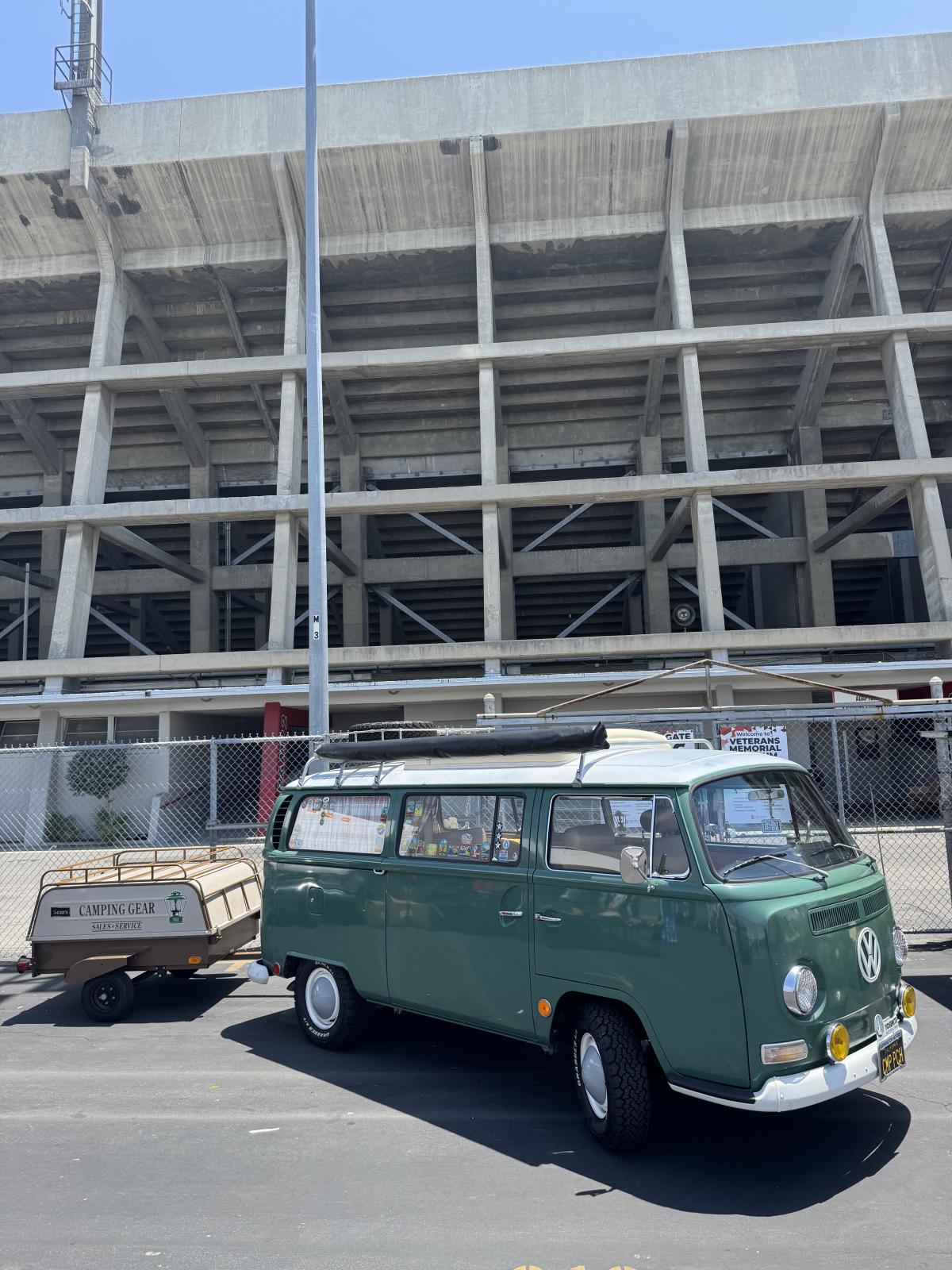

Thanks! It's pretty simple mod to make the HF carrier the right size. I bought some LED lights and will add them to the backside of the carrier and put a 4 pin plug on it since the tail lights are obstructed by the bike.
Here is my trailer with the rack powder coated. Maiden voyage to OCTO.

Your bus makes me Bay Curious…
Looking great with the trailer and those General Grabbers
