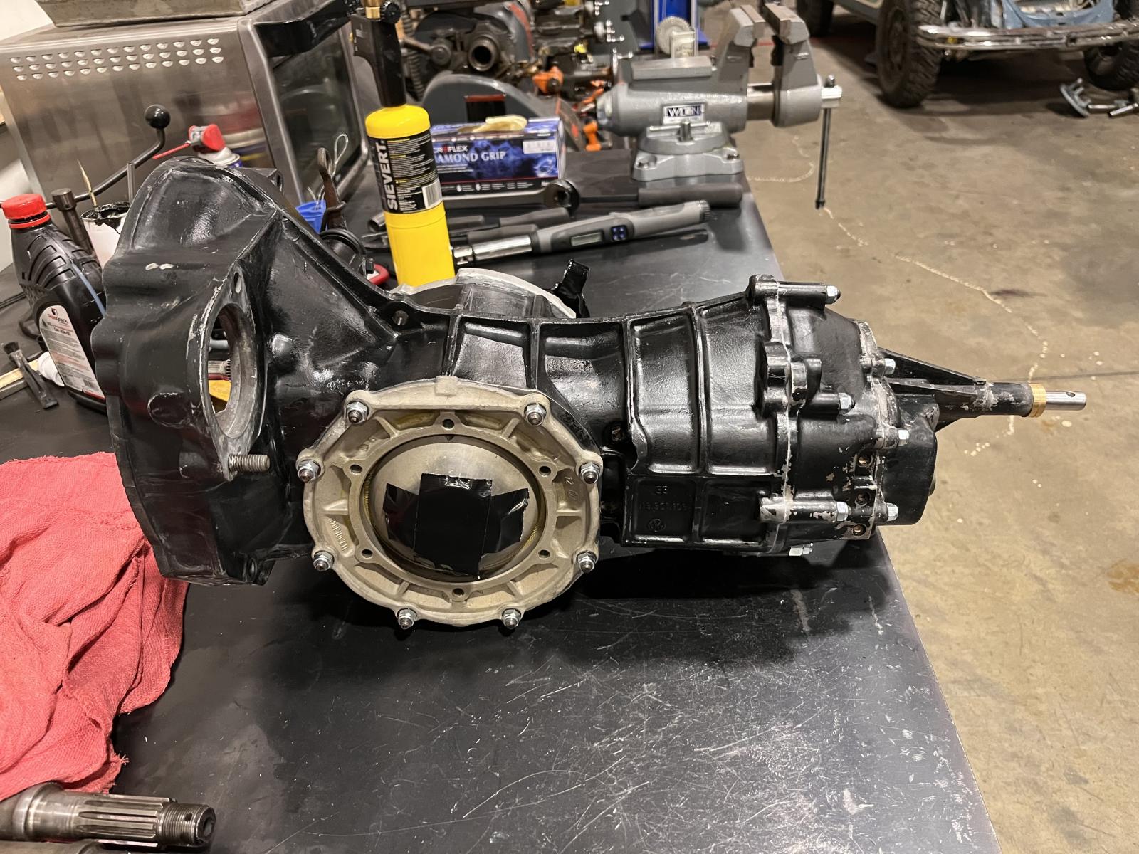

PostPosted: Thu May 15, 2025 11:33 am    Post subject: Re: Who's baja is getting a motor rebuild and trans rebuild? Me Reply with quote
The trans is being rebuilt Quaife LSD being added.

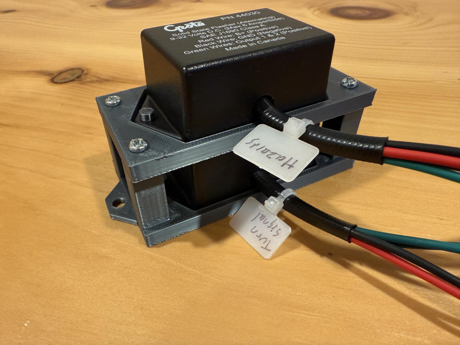

Yeah I’m stoked to check it out, hopefully by the end of the month.
In the meantime I settled on using two grote flasher modules, one for turn signals and one for hazards. These are neat, they have two outputs, so I can have the in dash indicator working.
I also got a cool. Watson Street Works C4 relay module and an Amazon fuse box to move my headlights off of the original switch(still going to use it, just to activate the relay) the new hella horn and still have a bit of expansion room left over.

PostPosted: Wed May 21, 2025 10:05 am    Post subject: Re: Who's baja is getting a motor rebuild and trans rebuild? Me Reply with quote
Getting closer, the trans is rebuilt new 1st and 2nd gear and a weddle reverse. Plus the Quaife and more.

PostPosted: Wed May 21, 2025 11:13 am    Post subject: Re: Who's baja is getting a motor rebuild and trans rebuild? Me Reply with quote
Its going to be a completely different animal after all this!
