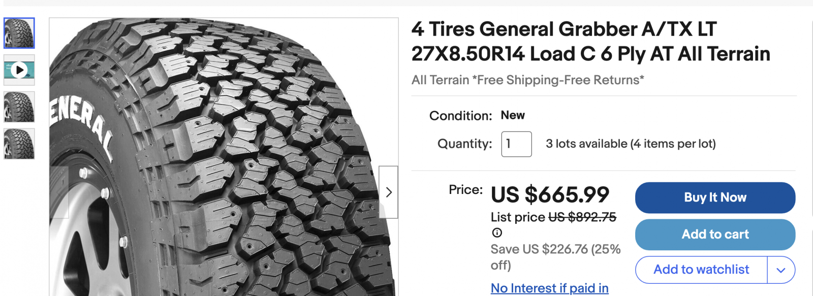

are these the right Grabbers for a 65 DC with 14's?
junichi
Joined: September 12, 2005
Posts: 781
Location: brentwood bay, bc
junichi is offline
PostPosted: Mon Sep 25, 2023 8:31 am    Post subject: Re: Split Bus 14" tires - modern equivalent to 7.00x14 Reply with quote
I have those exact ones on my 64 with 14’s and love them.
Are they super loud?

Who's ad is that above? Seems like a good deal @ $665.
Ebay deal
thats what im thinking, great deal especially when i need some new shoes

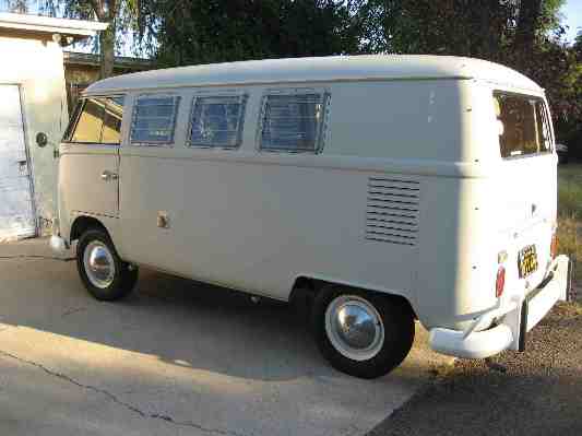

Anyone have pictures of their bus with Yokahama Y356 185R14 tires? Needing to replace my tires and those seem affordable and close to the bias ply stock tire diameter.
Found a few images in the gallery of the tire mounted but none of a bus far enough away to see the stance.
Image below from @barryL
1964 Original Owner build Thread. https://www.thesamba.com/vw/forum/viewtopic.php?t=702135&highlight=
Ambulance Fan's. https://www.thesamba.com/vw/forum/viewtopic.php?t=627707&highlight=
Parts i am looking for:
64 bug nice used front/rear Black LHD floor mat.
BarryL Premium Member
Joined: November 01, 2004
Posts: 15506
BarryL is online now
PostPosted: Wed May 14, 2025 6:15 pm    Post subject: Re: Split Bus 14" tires - modern equivalent to 7.00x14 Reply with quote
Here's a couple from farther away showing stance and size as you requested.
Basically stock.
Basically stock.
Barry 185/14 may be stock replacement, but they are definitely much smaller in diameter compared to a 7.00/14. I remember back when i worked for a tire manufacturer just how much smaller they are compared to 7.00/14s. same thing with the 6.40/15 or 5.60/15 on the beetles. huge difference in diameter.
people did like the radials, of course, because they last longer, and they make you think your bus is faster and uses less gas per mile indicated. it just takes longer to get places and distances are suddenly longer....
