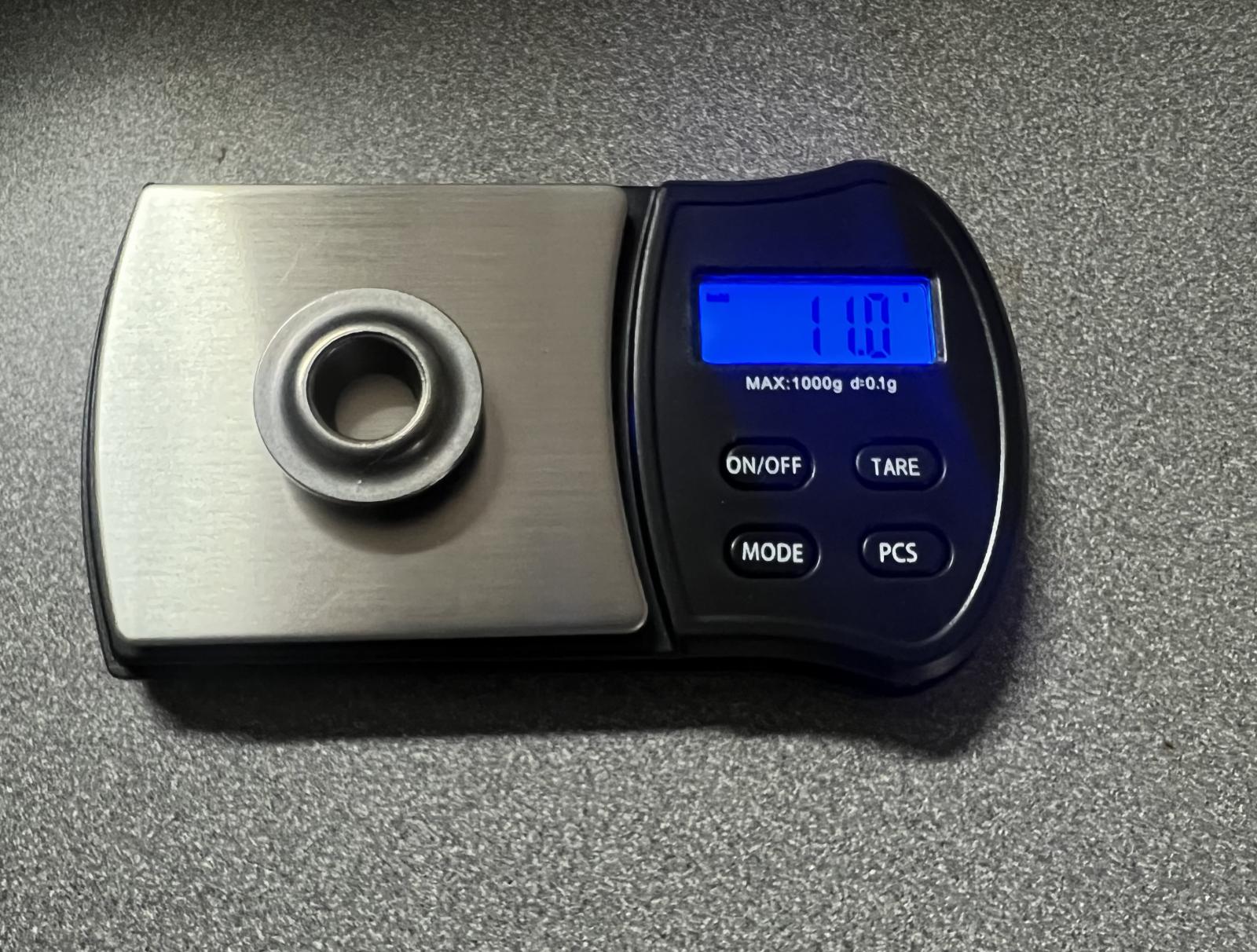

Is that a stock steel retainer?
Weights?
I bet it still weighs more than a Ti retainer.
Weights?
Hi Bruce,
i could not find an exact weight but here is the discription from the csp page:
"These special valve spring retainers are made of Saar steel - 42CrMo4 CNC and have a strength of 900 - 1200 N/mm² with a weight saving of approx. 5 grams per piece compared to the standard Type-4 valve spring retainer. The two-stage valve spring seat allows the use of an outer Type-4 valve spring, which can be combined with an inner waterboxer valve spring if required."

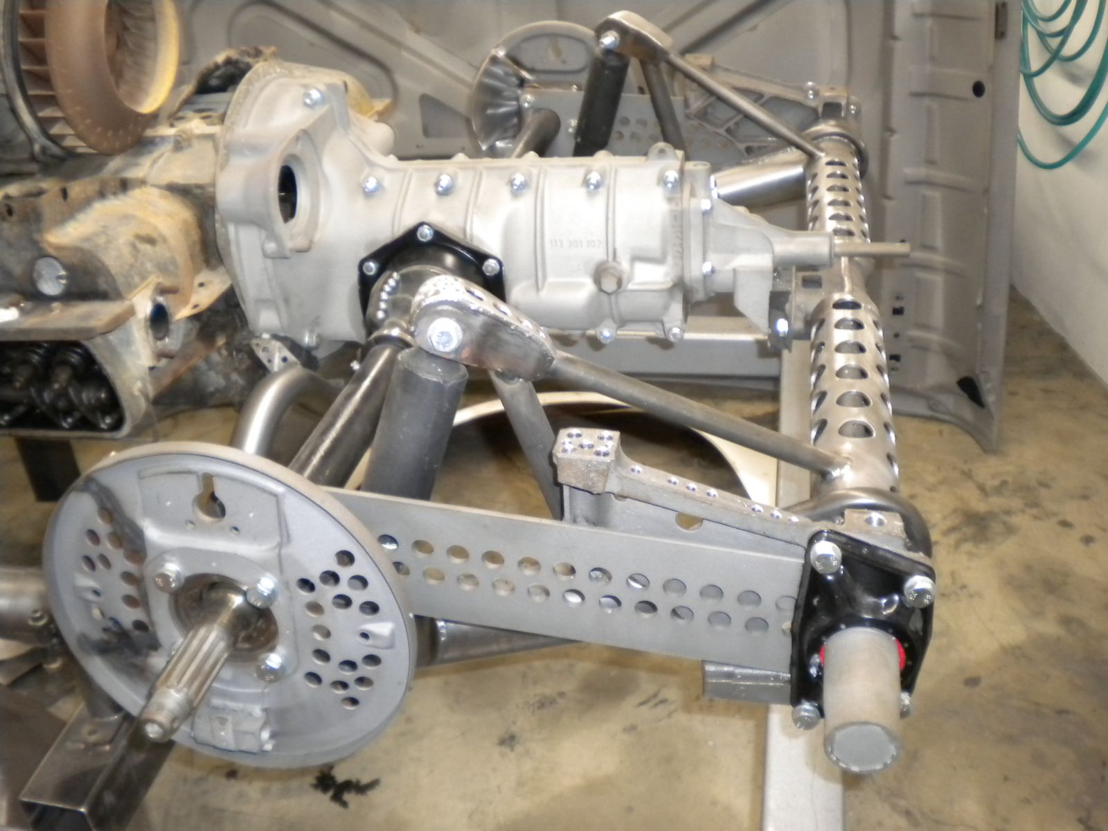

My '65-Subaru EJ20 Turbo conversion

Oh for crying out loud Laughing Laughing Laughing

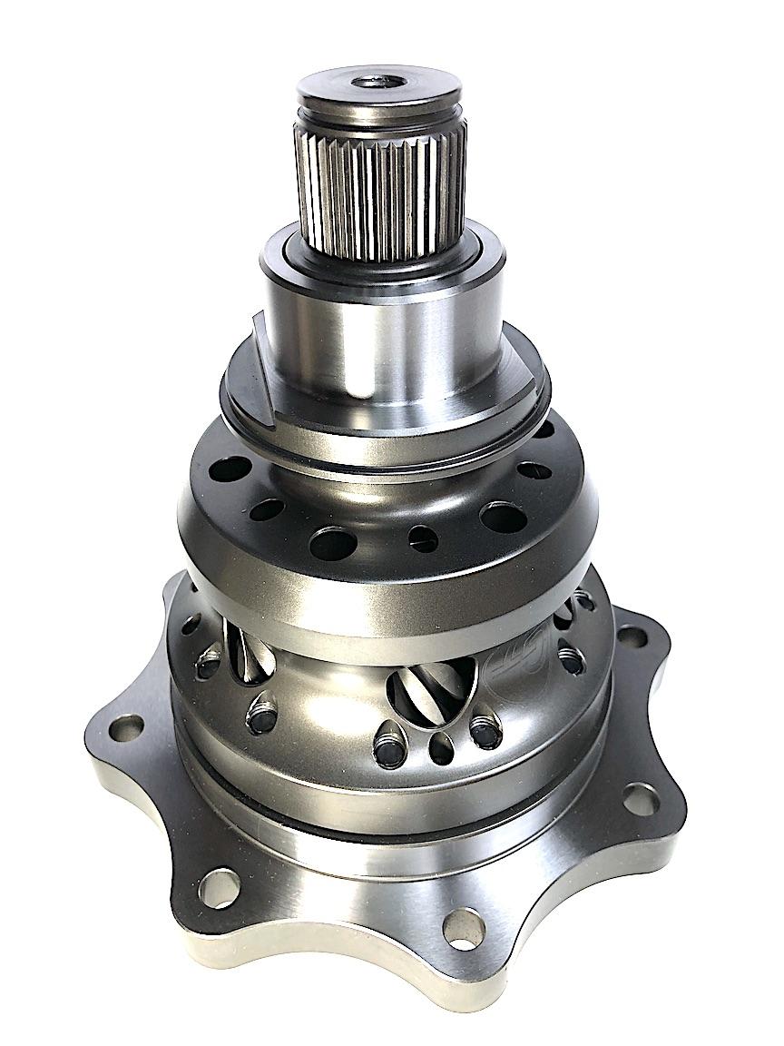

Quite a few years ago, I walked into Dave Folts' shop, and he was carving a few ounces from the backside of a customer's ring gear, end-milling neat little pockets between the bolt holes. Needless to say, Dave appreciates the 7 POUNDS we removed from the GT version 091 TBD .. https://www.thesamba.com/vw/gallery/pix/2270675.jpg
Weights?
Stock retainers are about 17g, I trimmed some down to 14g

Trimming a stock retainer down to 14 is pretty good, actually. Took off more than I thought you could.
These are stock steel retainers for a popular V8 engine (you can probably guess which one), but nobody said you can’t use other engine parts on a VW. Wink

from here : https://www.thesamba.com/vw/forum/viewtopic.php?t=792537

I had a Mazzone sandrail that had drums on it like that

That is completely wild! How much weight do you reckon you removed? Looks like about 30% and looks totally cool too. Like having a life size cut away learning tool.

Sorry, not mine, it was in the Samba photos.
