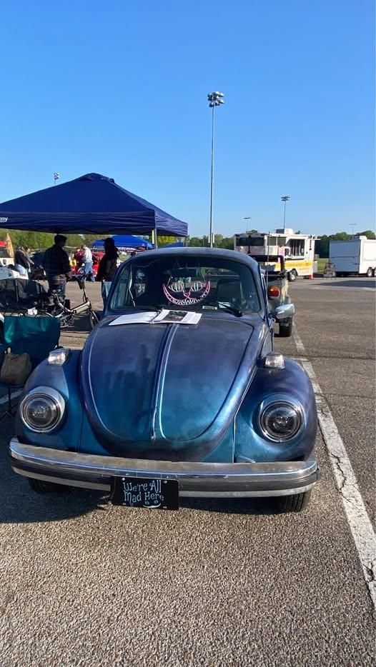

Bug-A-Paluza 2025 We Made it! My Fiance in her Bug-A-Paluza car themed outfit. All 5'3 90 lbs of her lol
https://www.youtube.com/shorts/m9a4AsYvv1M
Video of just getting it home

This is it now.
https://www.facebook.com/share/p/15F6N5QBKv/

as she sits today. Just after a drive. Waiting on the next one....
