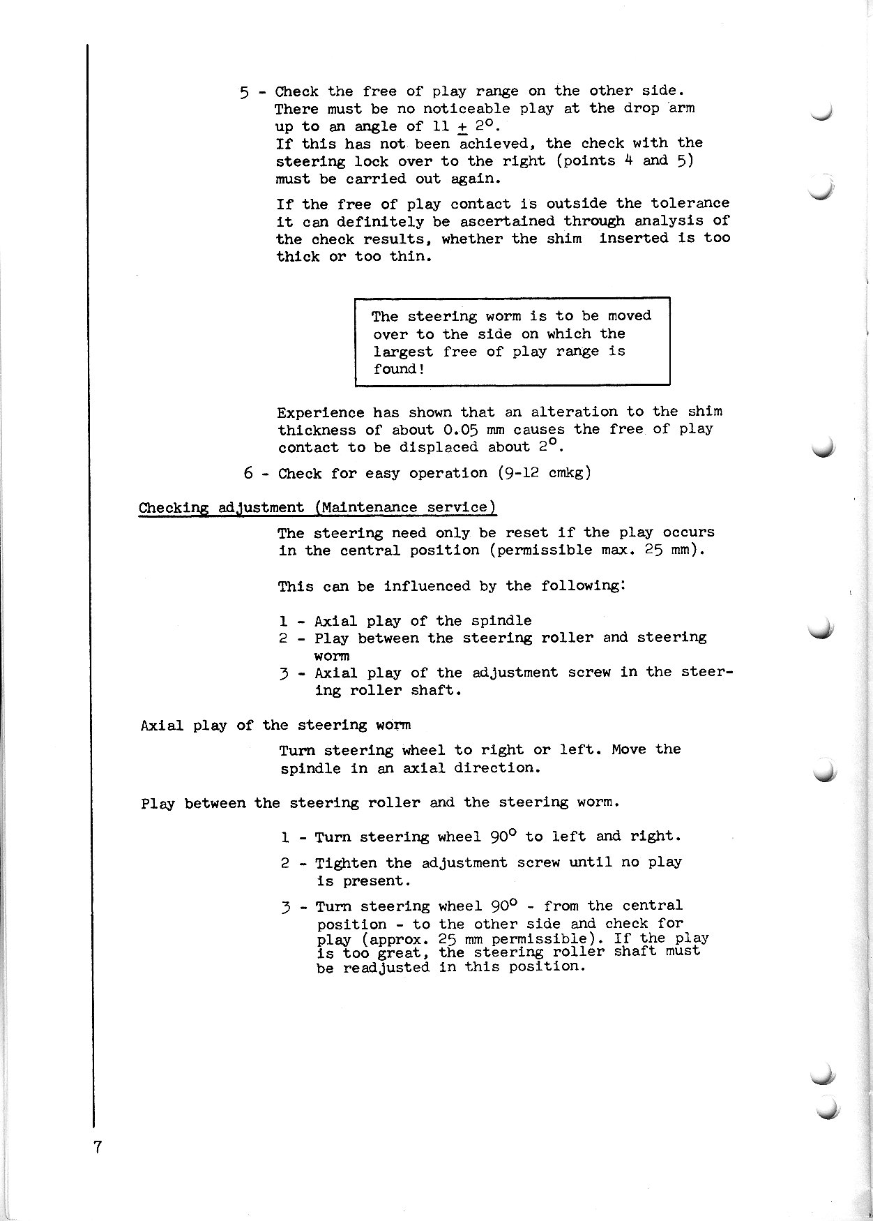

Note: Per the orange Bentley service manual, 1 inch of freeplay at the steering wheel OD is the maximum allowable amount — a brand new steering box should have considerably less freeplay than this.

No, the specified maximum freeplay of 1 inch for the steering box occurs before any of those other components and potential slop/looseness with them. You can easily see this by watching the pitman arm while an assistant moves the steering wheel — all initial play at the steering wheel (and thus the steering box) occurs in the range where there is no observable movement of the pitman arm.
And once again, the maximum allowable for that steering box freeplay is 1 inch at the outer circumference of the steering wheel. A brand new and in-spec steering box should have much less freeplay than that!

PostPosted: Sun May 18, 2025 4:28 pm    Post subject: Re: airkewld steering box Reply with quote
Sometimes you make it really difficult to have these conversations with you. I've never seen a steering wheel connected to a steering gearbox without a coupler.
Many people that buy a box from me are looking at the wheels.
From here: https://www.thesamba.com/vw/archives/manuals/practicalwork_steering.php
25MM = 1inch.

PostPosted: Mon May 19, 2025 6:54 am    Post subject: Re: airkewld steering box Reply with quote
Marcel, all I'm trying to do is clarify what the acceptable & desirable amount of freeplay is within the steering box itself. And once again, I don't think that it's all that hard to define and observe/check.
IIRC, the Bentley shop manual instructs you to gently grasp one of the steering wheel spokes between your thumb and forefinger, and lightly rock the steering wheel back and forth, to measure the freeplay at its outer circumference. And while doing so, if you or a helper can observe the steering box's input shaft and pitman arm, you can easily determine if the freeplay you're seeing is occurring at the steering box itself, or somewhere else.
I've rebuilt these steering boxes in the past, and my experience has been that while you can never completely get all the freeplay out of them, if they have good quality, in-spec components and are adjusted right, the freeplay you'll see at the steering wheel can easily come in at around 1/2", or even less. The trouble is, of course, finding good quality original or aftermarket components that aren't excessively worn, or otherwise outside acceptable tolerance limits (as we both well know - *sigh*).
So anyway, if you're selling steering boxes that are only holding around 1" or more of freeplay measured at the steering wheel, you may want to get with your parts suppliers and/or the folks who are assembling them to figure out what's going on. Same goes for the Airkewld supplier. Just a friendly suggestion -- no harm or foul intended...
