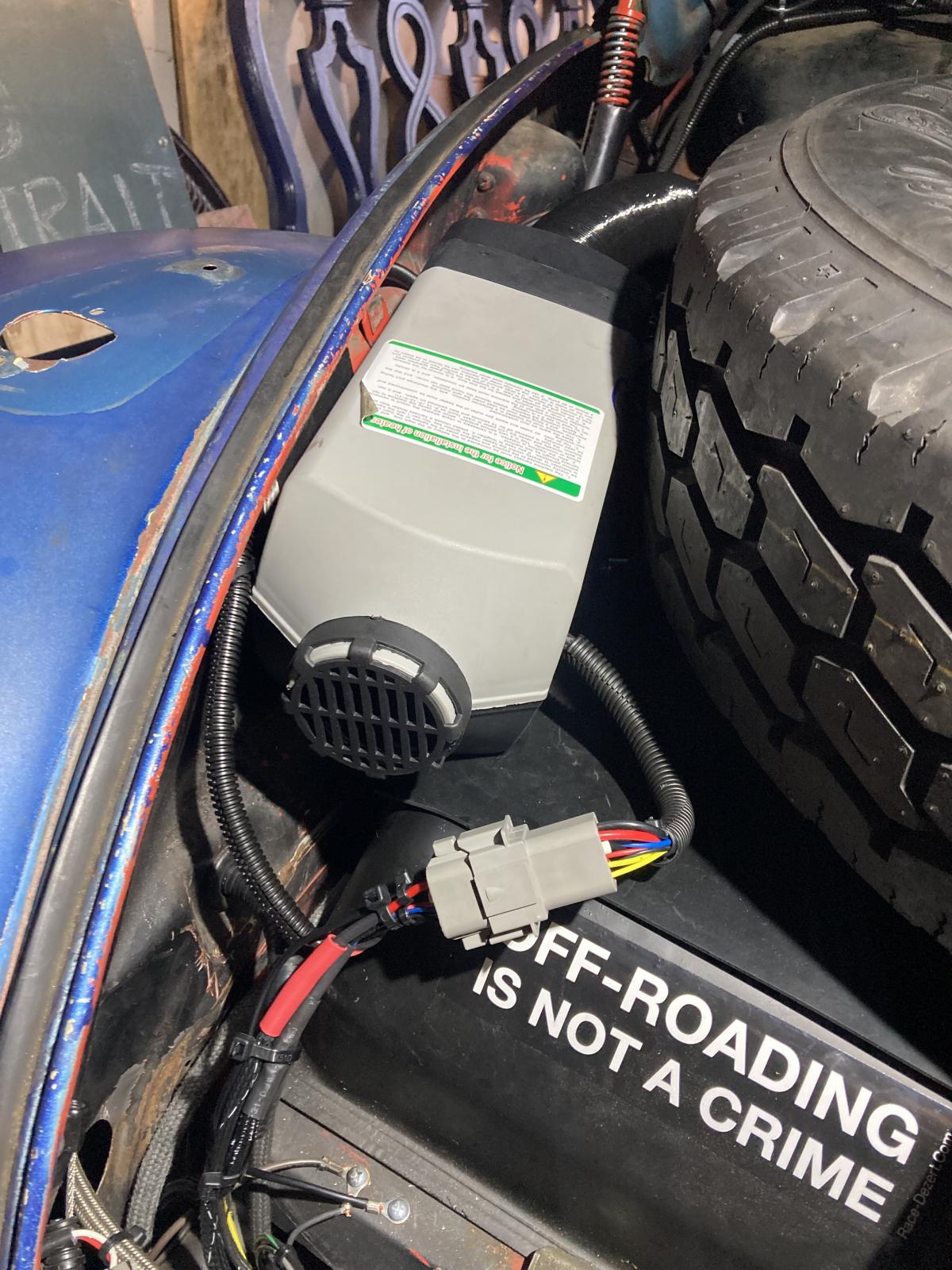

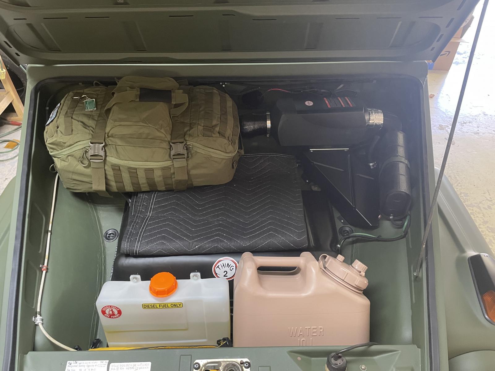

fastmc25
Joined: January 01, 2004
Posts: 1224
Location: East Tennessee
fastmc25 is offline
PostPosted: Tue May 13, 2025 2:17 pm    Post subject: Re: question from the mechanically challenged (heater) Reply with quote
8k unit
Works great.
