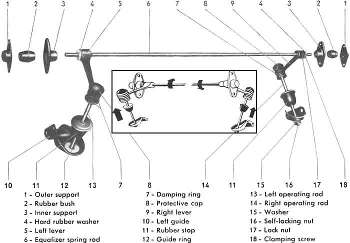

The Z-bar is the opposite of an anti-sway bar. The anti-sway bar fitted to the front of Bugs starting about 1960 tries to make both tire go in the same direction, when lifting one tire the bar tries to lift the other one too. The Z-bar is a pro-sway bar. When you lift one wheel it tries to drop the wheel on the opposite side. The stock VW version put a space in the action so it didn't act until the suspension had compressed some. GS guy was talking about shimming that out so the Z-bar works from the first suspension movement.
I think the EMPI camber compensator works the same way. The leaf spring can pivot in the middle, so when one tire goes up it will try and push the other down. You are right, neither of these devices can do anything about the camber change as the suspension moves up and down. That is fixed by the axle tubes and the height of the transaxle. The axle tubes are lower at the inboard end on Bug frames 1960 and newer.
There is no way to get a Z-bar in my Mini-T as the gas tank sits right over the transaxle. I'm pretty sure the Mini-T will never handle like well tuned Manx style buggy. The rearward weight shift is more drastic. The driver is close to sitting over the rear torsion housing, slightly rearward of the rear seat in a stock Bug. They are inclined to mild understeer with so little weight up front. I'm not so sure the normal idea of a front anti-sway bar up front and rear pro-sway bar (Z-bar or camber compensator) is the right answer. The Mini-T drives a lot different than a Manx clone or stock Bug. It is also a weird feeling to more or less twist in place, instead of being spun around, in turns. I've never really pushed it hard in the curves.
An image of the Z-bar setup from Glutamodo:

It's not quite just an overload spring. If you look at the image above you will see that if the rising suspension pushes the left lever (#5) up that will actually try to push the right lever (#9) down. So Z-bar (and the EMPI camber compensator) is doing exactly the opposite of what an anti-sway bar does. Stiffer torsion bars just make both sides firmer, it doesn't cause movement on one side to effect the other side.
In theory you install an anti-sway bar at the end you want to make slide sooner, so VW put one up front to shift help reduce over steer, and they did that at about the same time they lowered the transaxle in the frame to reduce rear camber. I guess that means you install a Z-bar or camber compensator to help make the other end slide sooner, and VW did that in 1967, along with lowering the rear a little to reduce camber more. They were taking steps to tame the oversteer inherent in a tail heavy car because drivers were mostly used to nose heavy cars that tended toward understeer.
Here is a website selling a modern version of the Bugpack flop stop. Poking around I don't see any US dollar sales info, tax information, or shipping options. The web site is also poorly configured, particularly if you find the English version. It shows the part and shows how it is installed, and yes it is a simple downward travel limiter.
To get back to the Turbopaul’s original question, by now it should be clear the front sway bar isn’t required. If the buggy ends up to tail happy an alternative to the front sway bar would be an EMPI camber compensator on the back. You can also stagger the tire sizes more (bigger rear and/or smaller front) to shift to less oversteer. I recommend you don’t get carried away with tiny front tires though, P135R15 tires gave my first buggy severe understeer even without a sway bar. Because a buggy is lighter than a stock Bug you effectively have a stiffer suspension than stock.
