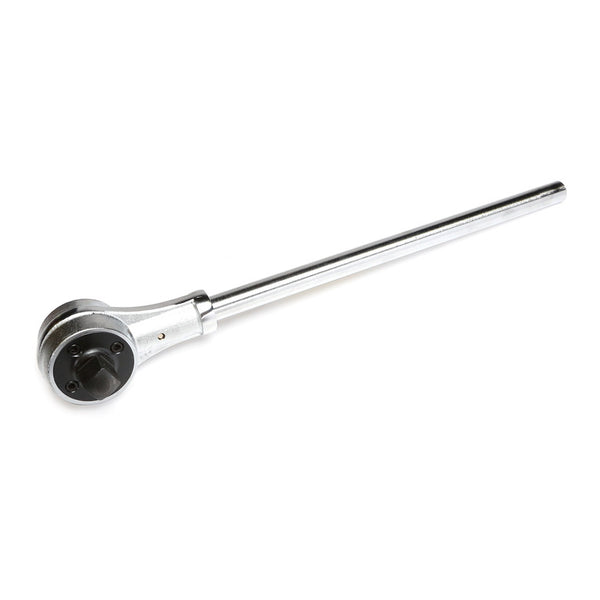

Easiest way to increase torque wrench range with extension would be to make extension "A" same length as dimension "L"... To get torque value you double value as to what torque wrench is set at IE:132.5 X 2 = 265...
Personally I have one of these, it can apply 4 times the torque at output as what is applied at input....IE:66.25 X 4 =265
