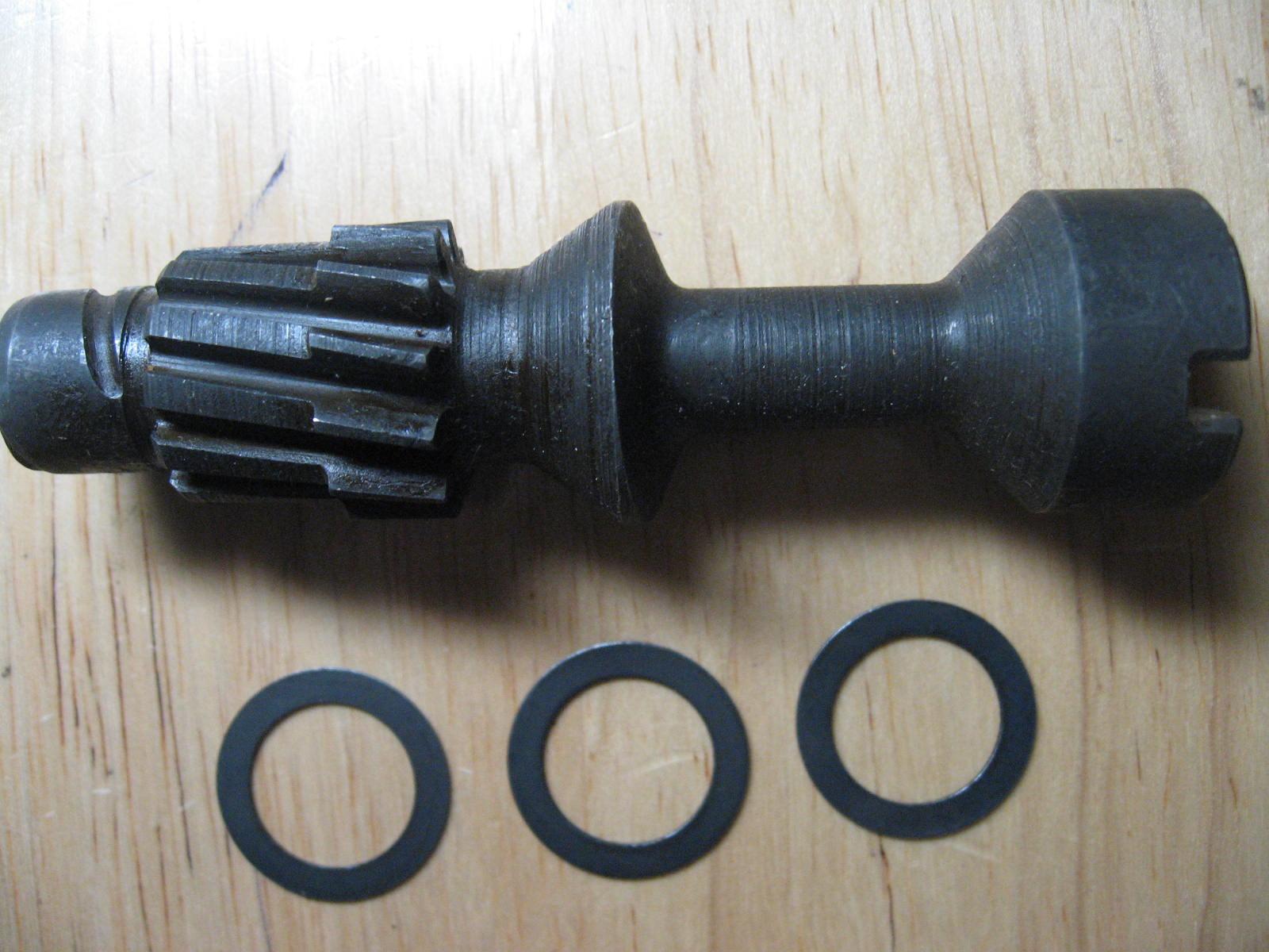

New question: I have this NOS distributor drive gear still covered in cosmoline from VW with the original washers in the kit.
Is it uncommon or one of billions?
Common design, but keep in mind it is still German quality.

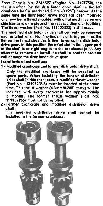

Less common would be these:

Golly Gee Willikers I had no idea. So there are cases out there that are entirely different just for that aspect. I wonder how many there were made? Did they go back to "no shoulder" later again?
In Beetle numbers it crosses to January 1961 for chassis and engine. For bus it is only engine January 1961.
Anyone know more about this?
