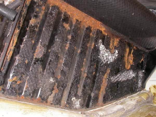

I think it depends on the condition of the tar boards--if they're really bonded to the pan or not. Luckily on mine, I was able to pull off a good portion of them by hand. I found it easiest to not heat them or use any kind of solvent. I used a heavy duty scraper tool to chip off the remaining pieces. It took a while, but I think the other way would be a lot messier.

about the same condition,most of it came up,just minor peices that will scrape off,just taking a long time,which solvent would you recommend if any is needed.very nice by the way and thanx

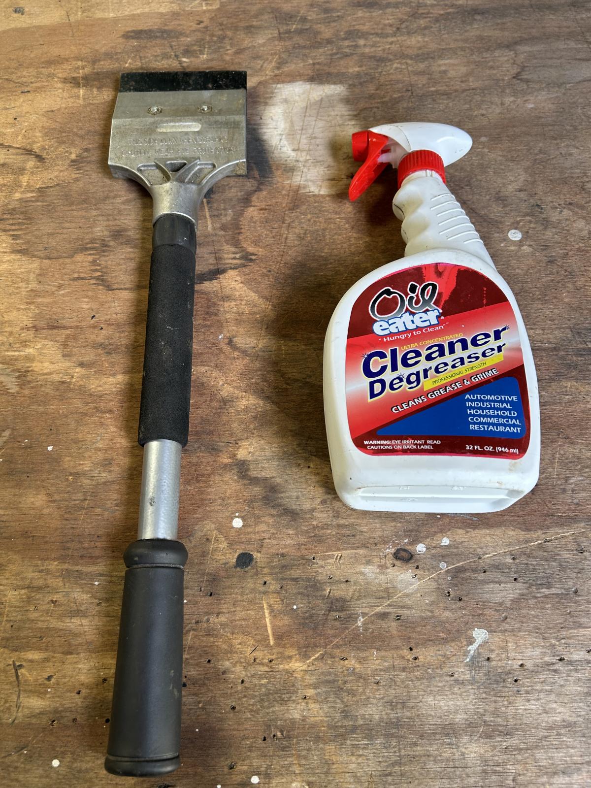

No heat, just makes a sticky mess. And using a wire wheel will generate heat and leave a sticky mess and a ruined wire wheel. Unless you don’t mind leaving tar residue on everything the wire wheel touches after you’re done with this job.
I found using a large scraper gets all the big stuff and for any sticky reside that is just smearing around Oil Eater worked great. Spray the residue, let it sit a minute, then scrape. It turned the tar residue into a consistency similar to that clear rubbery adhesive that holds the cardboard labels on plastic lunch meat containers. Scrapes right off and leaves a clean surface underneath. BTW Oil Eater is paint safe and works very well on the engine, trans, etc. as well.
