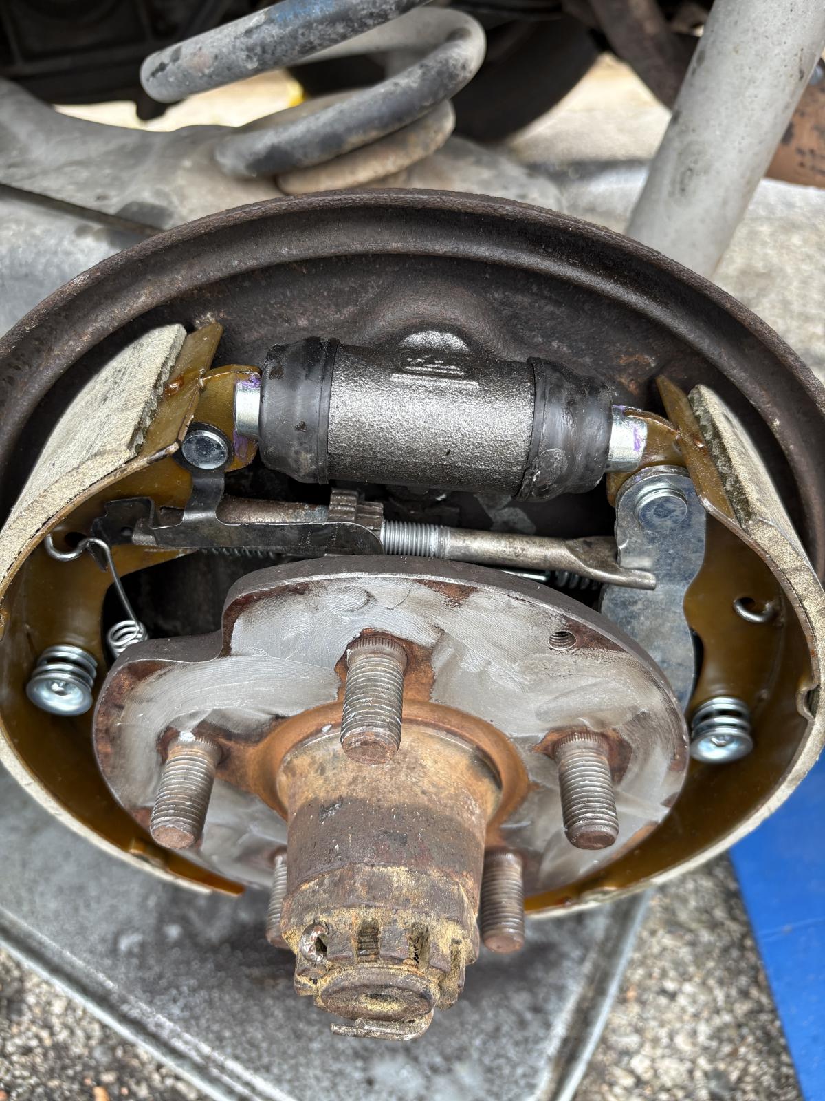

One question:
My rear brake adjuster seems too long. I am fairly certain that I assembled it correctly. Will this be an issue? I tried bending the adjuster plate a bit but I can do more if need be.

PostPosted: Sat May 17, 2025 5:34 pm    Post subject: Re: Brake Nightmares Reply with quote
What if I put some spacer washers on the adjusting arm?

PostPosted: Sat May 17, 2025 9:39 pm    Post subject: Re: Brake Nightmares Reply with quote
I just added the adjusters from a Bay Window bus to the block at the bottom of the shoes and adjusted the shoes up to minimal clearance just like I would do on a Bay when putting in new shoes. I used JB Weld on the threads so they wouldn't loosen up. So far I am happy with the improvement in the geometry.

PostPosted: Mon May 19, 2025 11:15 am    Post subject: Re: Brake Nightmares Reply with quote
I am still confused. Is it common to have this alignment issue? Can you see any issue if I just add some washers as shims?

PostPosted: Mon May 19, 2025 1:09 pm    Post subject: Re: Brake Nightmares Reply with quote
So, with brand new shoes (max outer diameter) and brand-new drums (minimum inner diameter) the adjuster needs to be that wide to get any resistance?
Doesn't make sense. Sum Ting Wong.

Chootrain470
Joined: March 01, 2023
Posts: 140
Location: Simi Valley, CA
Chootrain470 is offline
PostPosted: Mon May 19, 2025 1:26 pm    Post subject: Re: Brake Nightmares Reply with quote
BK
Yes, they are completely new drums and shoes. The other side doesnโ€™t have this issue. Iโ€™ll check again but Iโ€™m fairly certain all of the springs are assembled correctly.
