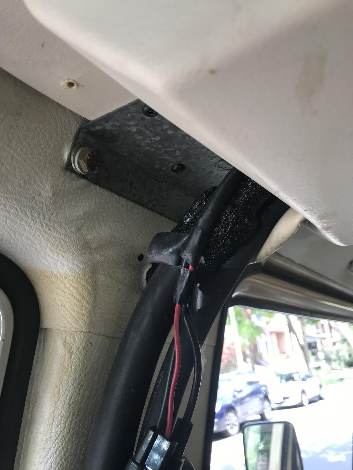

And once upon a time they ran up to the Ceiling like this.

Ding ding ding ding! We have a winner. Definitely AC hoses & wiring in the stock position for an 84 van.
