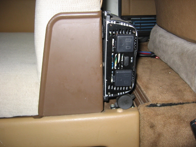

Here is mine, it had been the plan to plug in the fridge to it. The length of the fridge cable and that of the cig socket saw some voltage drop from my Aux fuse box to the fridge. I then hardwired (fused) the fridge to the battery and use my socket for the XM Boombox.

I installed the cigarette lighter type plug on kick panel of the bench seat. The cord from the fridge goes under the carpet and then up to the plug.
