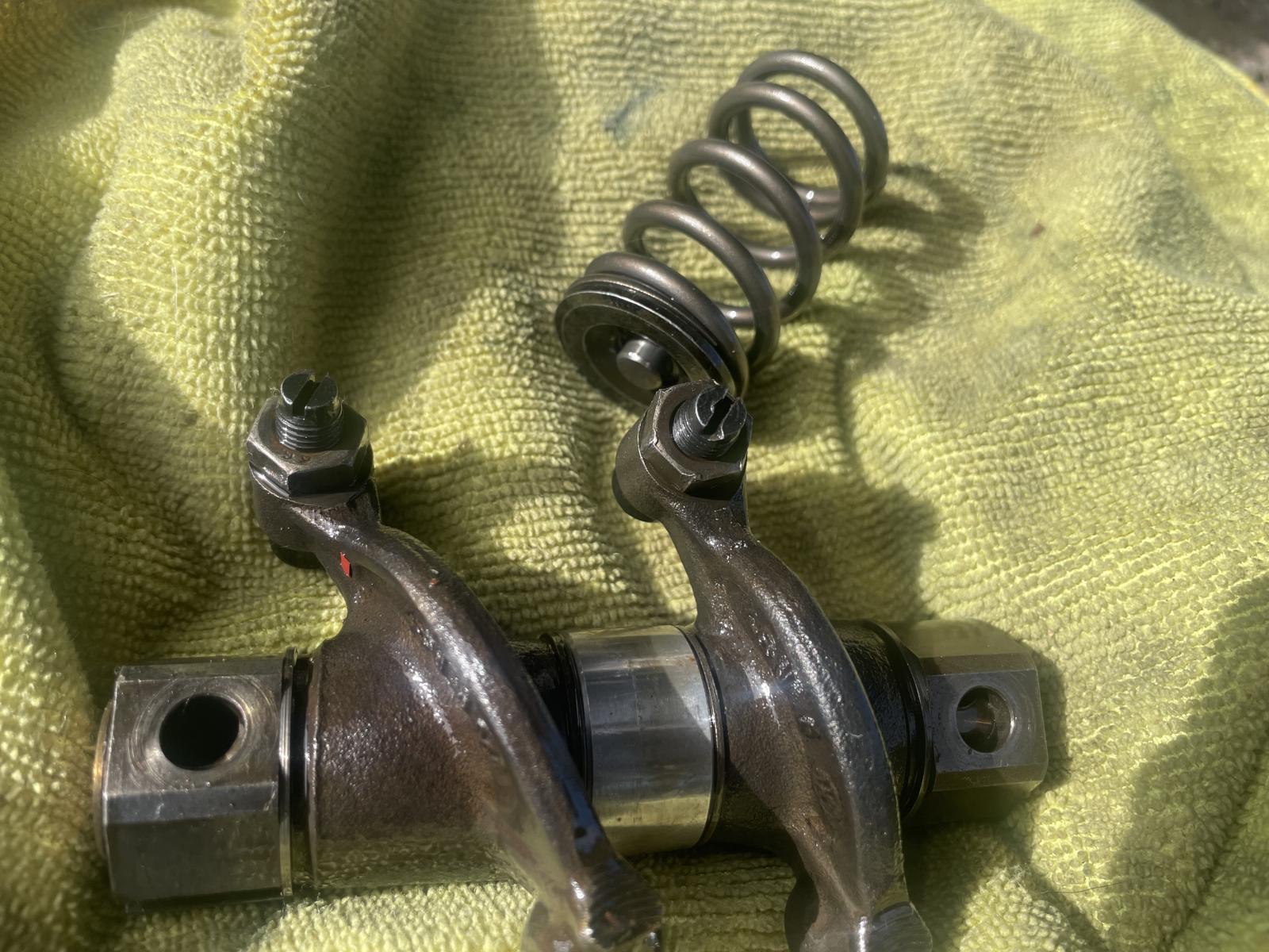

PostPosted: Tue May 20, 2025 9:53 am    Post subject: Re: Broken down in Tennessee - looking for help Reply with quote
Some great things to think about for the OP up above.
Again, your situation may not be the same as quoted below. But might be handy for future readers.
KentABQ wrote:
On the way back from BBB, I ran into a slight problem.
She had been running GREAT for 575 miles.
Then... she lost power and made a rattling noise.
With help-via-text from Robbie, we were able to find the problem...
The #3 exhaust value decided to take a break. Crying or Very sad
By removing the rocker assembly, pushrods, spark plug and injector plug, I was able to limp home on 3 cylinders.
Oh, and a couple guys in a splitty suggested wrapping a wire around the broken end of the valve to keep it from being sucked into the cylinder.
Time for some head work.
Big THANKS to Robbie for his support when I was stuck in the shoulder of I-40. Applause Applause Applause
Even with this problem happening, it was definitely worth the experience of getting to BBB again!

But, if these heads do not match your Heater Boxes, well, they're of no value to you.
Anyway, if you can use them, they are yours. However, I am not sure how would be the best way to get them to you. I live over 4 hours from Nashville.
Oh, and you should pop off the valve cover to take a look at the rockers as others have suggested... this could be a simple fix if the rockers are in fact the issue.

aatheoret wrote:
Also regarding the oil, I don’t think it is a leak but the motor is burning oil. I have this nasty blueish smoke coming out of the exhaust when it is revved - probably because of the faulty cylinder? I always had a similar issue, just not to this extent…
What can happen with air-cooled engines when they start to burn too much oil is that the burnt oil doesn't fully burn, it turns into a sticky tar sludge that cakes up in the piston ring grooves keeping them stuck, no longer able to follow the cylinder wall, it then makes its way into the small bearing lube hole, via the oil scrapper groove holes and then bungging up the oil scrapper piston ring oiler holes .

At 100 miles per quart/liter of oil you need to stop running that motor so you have something rebuildable left. Price out used short blocks and it will be 10X cheaper to Uhaul/flatbed it to the repair spot.
