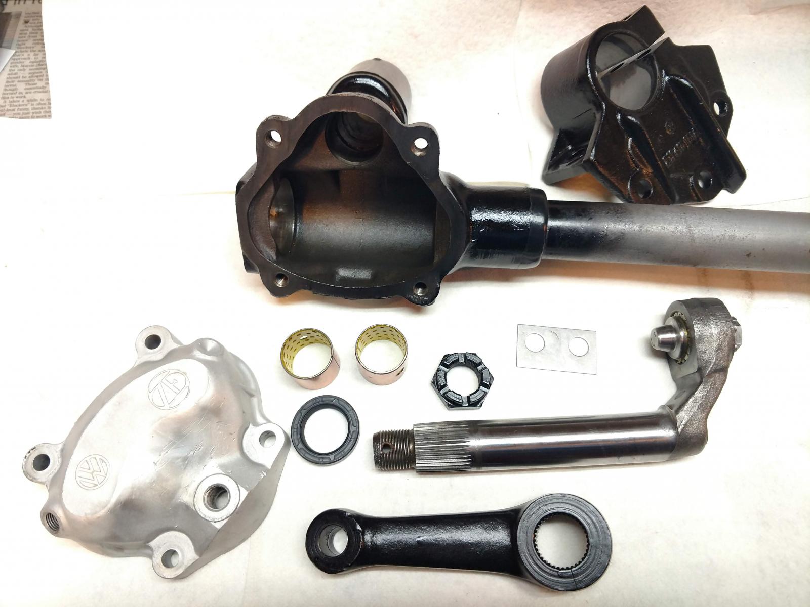

The slotted adjuster screw is threaded directly into the Aluminium cover plate, and kept in place with a single lock nut.
You are describing two nuts - I'm pretty certain this is not usual....
It sounds very much like the soft aluminium box cover threads are stripped to me... or someone has attempted to booger in a new 'nut' into the box cover to try and fix the previously stripped aluminium threads... and you are left picking up the pieces.
It may be easier to unbolt the box side cover and attack from within, you may be able to get some pressure on the internal side of the adjuster screw to help push it out whilst turning.
Pic here, if it helps.... (stolen off The Samba!)
