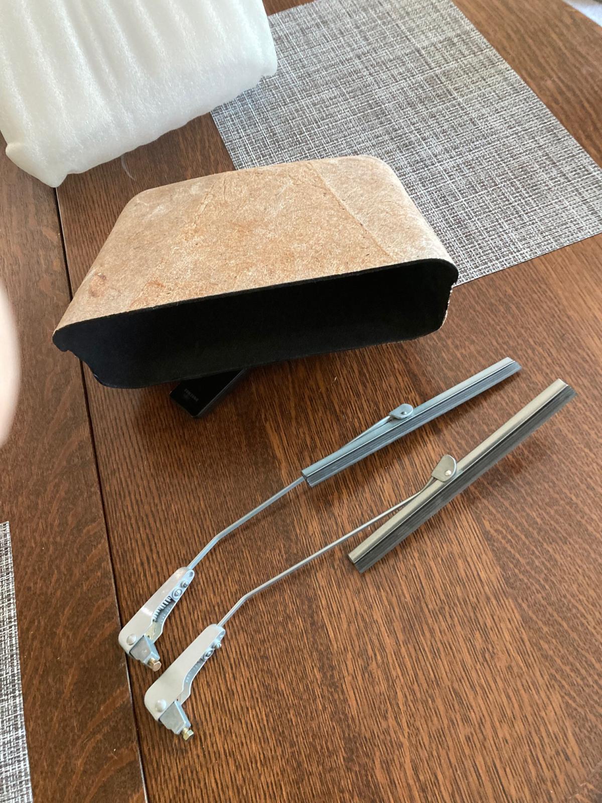

Went on a shopping spree at Kaefer Nostalgie. Fastest deliver to Canada with FedEx and standard shipping in 48 hours or less.
Door seal @ $68 US for both doors!

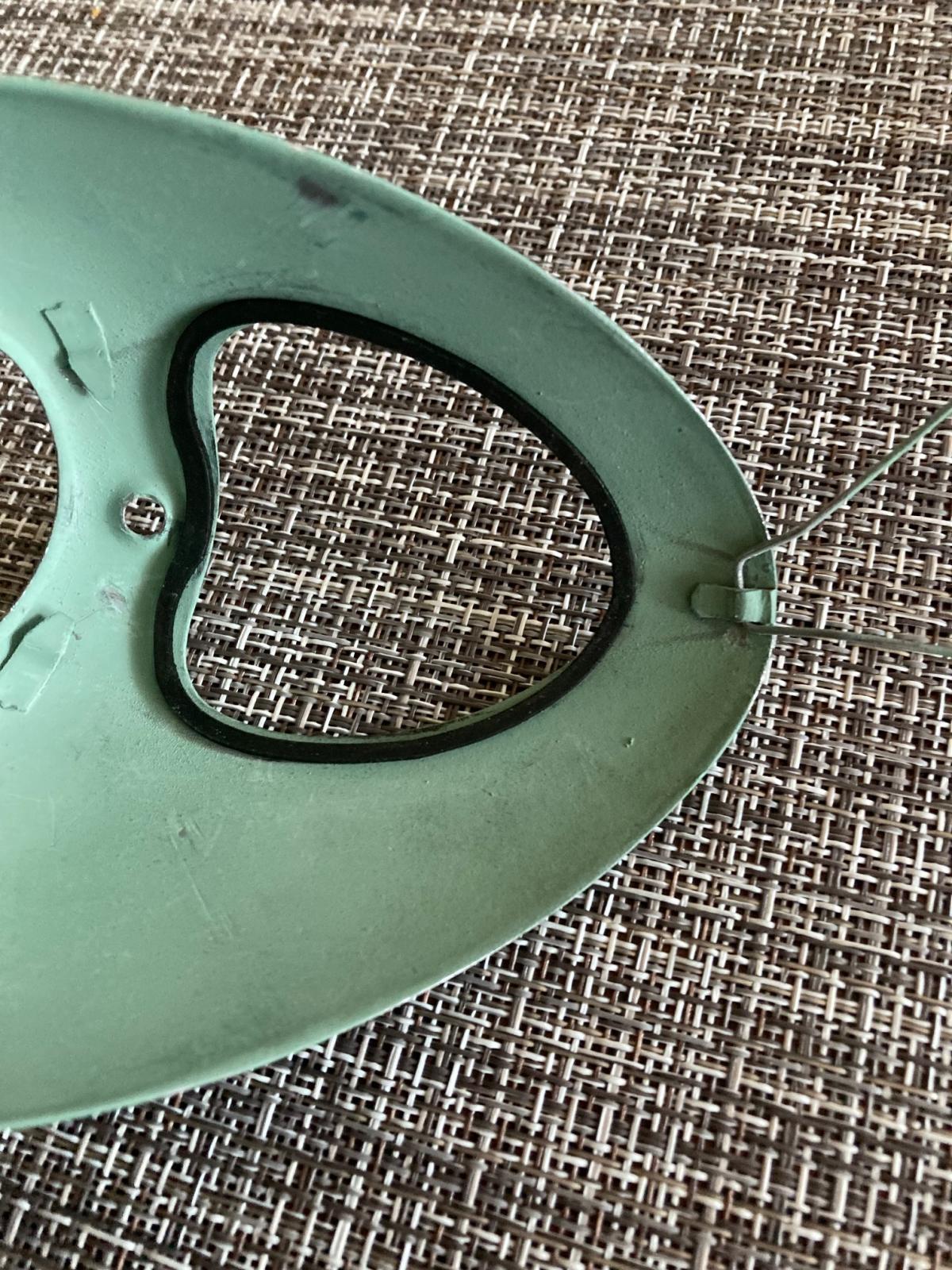

Heart tail light gasket. Thought I would try it.
Could not get myself to buy ABS glove box. This "paper" composites comes with interior flocked in black
Since swapping wiper bases with Don also ordered silver wiper arms and wipers!
Did that come from Kaefer Nostalgie, too? I may need some myself!

PostPosted: Thu May 22, 2025 2:30 pm    Post subject: Re: New project - 1954 VW Beetle Deluxe w/ VW Canada prodn plate Reply with quote
All items and pics in my last post are from Kaefer Nostalgie.

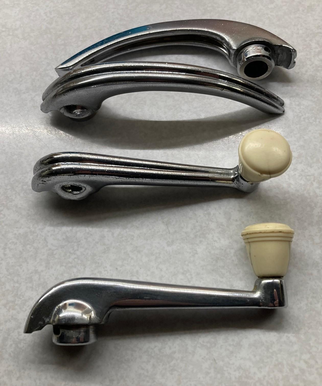

Decided to polish up the door hardware with Autosol and 0000 steel wool. Came out not too bad and retains some patina so will use.
The chrome on this car is pretty bad with the pot metal in particular being beyond repair.....door handles and factory installed locking deck-lid t-handle.
I will be using the repro Wolfsburg West handles in this build.

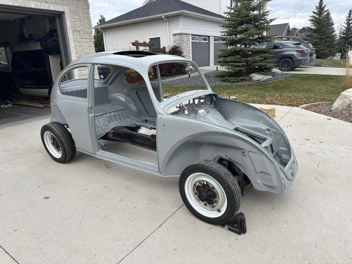

Got fantastic news when Cam texted me recently and said he will be taking the car in September to start the body work!!! So looking forward to the start
A photo of his recent work for another VW club member here. Heater channel replaced and both front and back clips replaced due to rust and collision damage.
