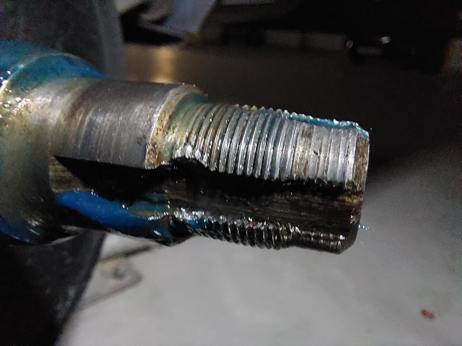

I disassembled and measured the right side. Spindle is not perfect, but seems not to be worn.
Inner bearing shaft size is 40.90 mm for the 41.00 mm bearing ID outer shaft size is 21.9 mm for the 22.02 bearing ID. Measured with my cheap digital caliper.
The washer measures flat and even around, but the nut grabs it first where the tab is.
I did tighten the nut fully to where I cannot turn the hub, loosened the nut and hand tightened it with a socket in hand. There the washer cannot be moved only by levering the screwdiver tip on the edge of the hub, but it has the same small play as the other side where the washer can be pushed with the screwdriver.

spindle threads are really chowdered up. in addition to stripped threads i can see thread stretch too. no wonder the nut doesn't tighten! it'll be a delicate operation to get it started correctly but i'd run a die over those threads to clean them up. it WILL remove some precious material that you don't have a lot of to spare but it'll also allow you to thread the nut down more better.

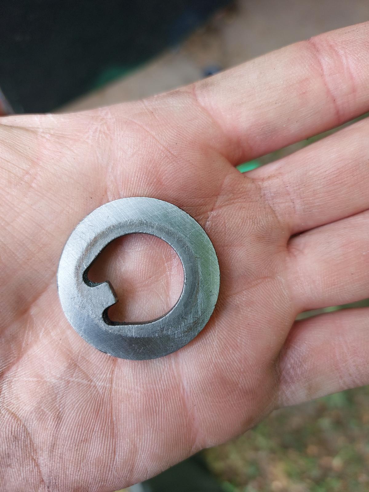

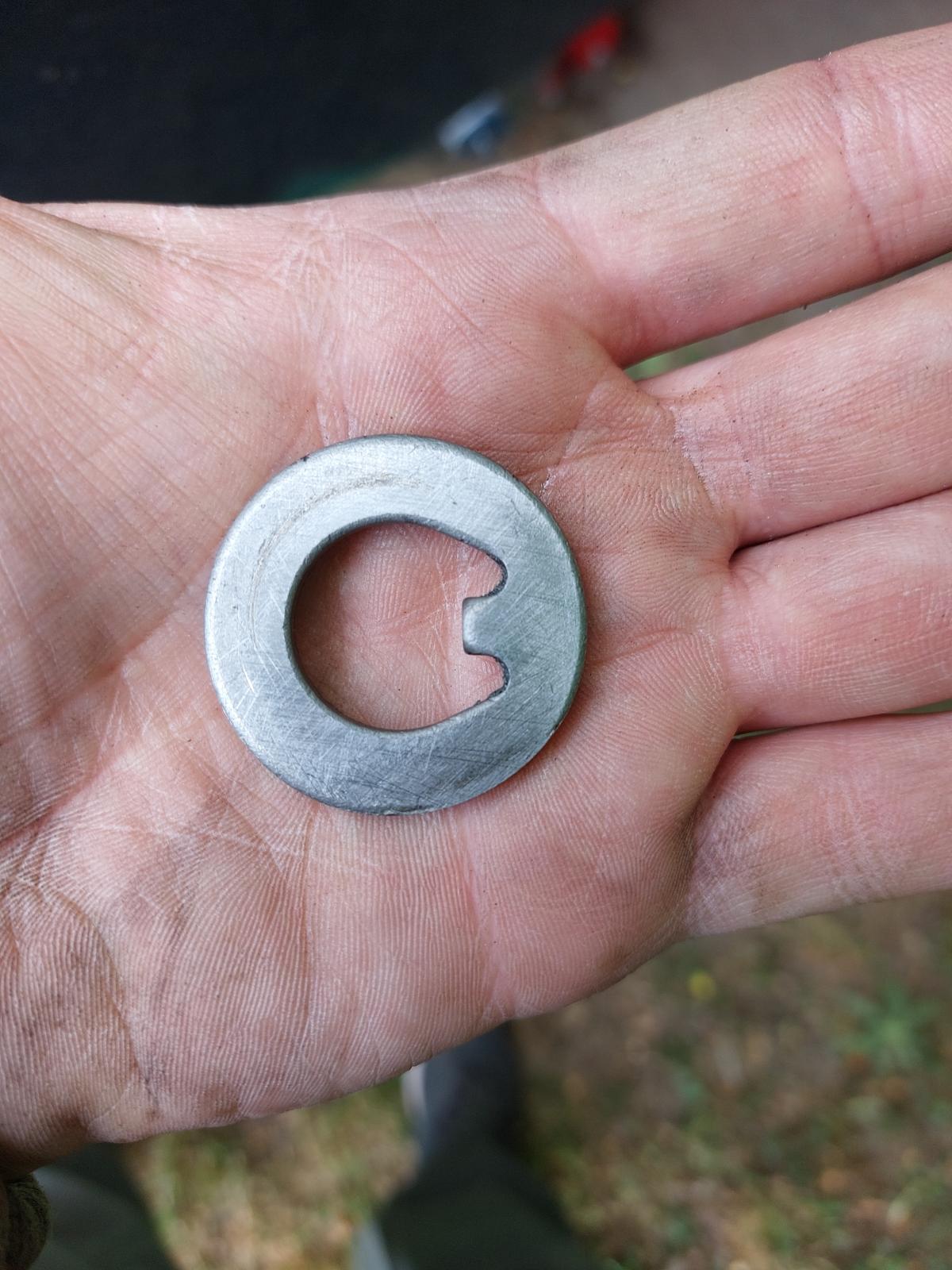

one more thing... with the Mercedes nut, you can eliminate the washer and gain a few more good threads.

That spindle is T-H-Rough, aka through. My only thought of saving it would be by mowing down the rest of the threads to about the same diameter as the, "full retard" section than running a die down it with a smaller diameter. New hardware would need to be sourced along with a custom washer. If it fails, it no big deal, you can street race your wheel that fell off. Don't touch the brakes!!
BK
PS the proper torque is after it settled in, snug it up so you can still move the washer behind the nut with some resistance using a flat head screwdriver. Can't move the washer? Too tight...loosy goosy? Needs more. (Preformed without the weight of the van on it)
Are you sure you don't need the washer with the Mercedes pinch nut?
I kinda think I still used the washer with the Mercedes pinch nut?
it's a great question. i went down the rabbit hole trying to find the definitive answer and concluded that Mercedes didn't use the washer, proof positive on my 1983 300SD Turbo Diesel, and so i don't believe it is necessary. i didn't use the washer on my '87 Westy and everything is just fine after miles and miles. the face of the Mercedes nut is nicely machined and has a large surface area that contacts the bearing well, in addition to being thick and strong. i've no problem going without the washer but ain't tellin' anyone else what they should do. actually, i am. you don't need it.

DanHoug wrote:
THANK YOU!!

IMHO the washer is also a safety device.
Look at the very deep key way groove in the spindle.
Look at the very stout key in the washer.
The key keeps the washer from spinning on the spindle.
If the washer could spin it could unscrew the axle nut and that would be bad.
The washer separates the turning parts from contacting the nut.
Of course the nut should be locked in place but things happen.

Unfortunately an M18x1 die is not a thing that I cran grab from my drawer, so that needs some time.
For SOS repar I am thinking about filing down the burr on the thread with some small precision file and replacing the washer with a new/good used one.
Do you know if the new aftermarket ones (possibly JPGroup) that are available are good enough?
That is what I can get quickly.
Or just search for an original?

You can make a die, by cutting a stock nut down one side. Run it on and off multiple times and it should straighten the usable threads.
I’d suggest looking out for a replacement. After all it does keep the brakes and wheel on the van. That the grease is already burnt, indicates something is not right.
