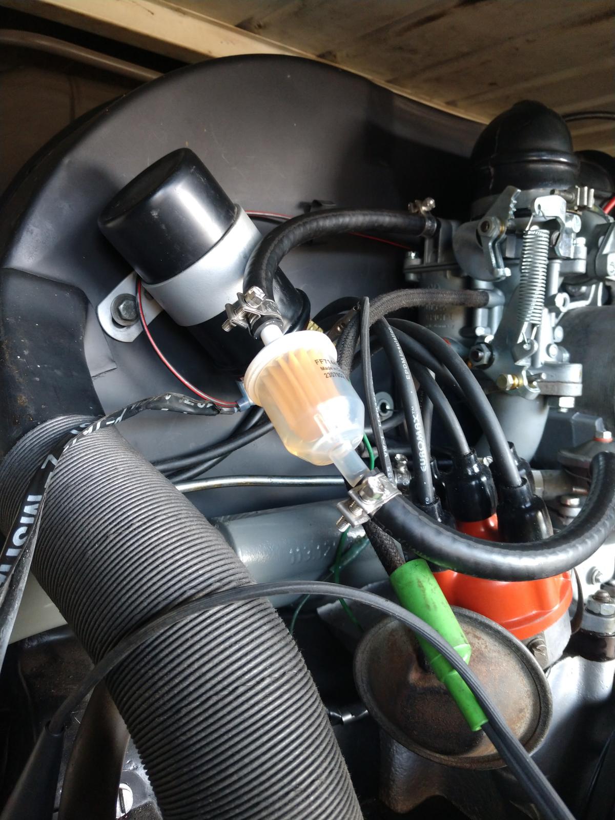

I found some time to get the stock fuel pump installed, and it appears that fuel pressure (or volume) is back to what I am used to seeing. The bus starts right back up after sitting a few minutes, so it leads me to believe that it was flooding a bit before. I just need to verify no fuel starvation at sustained higher RPMs. (And get some true 6mm braided fuel line, as this 1/4" flaps fuel line makes me nervous that it is going to slip off under pressure!
Oh, and my generator is not charging again...

I have been driving the bus around some to further break in the engine. Even with the stock fuel pump, I am somewhat plagued with a difficult start once I have driven 10 or 15 minutes and turn the bus off. It is no matter if don't touch the pedal, flick the pedal, pump once, pump twice, etc, I almost always have to hold the pedal to the floor while cranking for it to eventually start. I was thinking that may be a flooding condition?
I am running a rebuilt 30PICT1 and a rebuilt 205K distributor. Dwell is right at 46 degrees, timing is, right now, 30 BTDC at 3k rpm (full advance). I was around 28 BTDC and it seemed a little bit gutless so I bumped it up and it did make a bit of a difference in the guts department. It is single port 1600 with stock exhaust.
This carb does not have the idle cut off solenoid, would that make a difference?
Does anyone have any ideas on other things to check? I was thinking about this : drive some and then park it. Look inside the carb throat to see if any gas is visible coming through the carb when turned off. That might show a needle valve problem?
Any other ideas would be appreciated.

Regarding your earlier question on the Idle solenoid/Cut off Solenoid- That was primarily to stop engine run on after you shut it off with a hot engine.
And happy that things seem to be going better for you. Maybe there was some gunk in the Carb that's gotten cleaned up a bit with more driving.
If you ARE possibly losing fuel down the throat of the Carb from a needle valve, check your engine oil level and smell every few days. If you are getting gas into the engine, you'll soon know it with an increase in oil level and smell of gas in the oil too.

I stumbled on a thread on here with someone having the same problem (in a beetle, I believe). His owners manual stated something to the effect of "when starting a warm engine, slowly depress the gas pedal once you turn the key". So that is what I have been trying and it has been working great! I originally was blipping the pedal, turning the key, and flooring it (when starting warm engine) and it would crank forever.
I have kept an eye on oil level and smell, and all seems well there.
I am thinking of picking up a different distributor. I am currently running a rebuilt 205K (which is stock on a beetle), and I am thinking of picking up a rebuilt 205M, as the advance kicks in a little bit sooner if I am not mistaken? The 205M is the stock dist for the 68 bus. Any thoughts?
