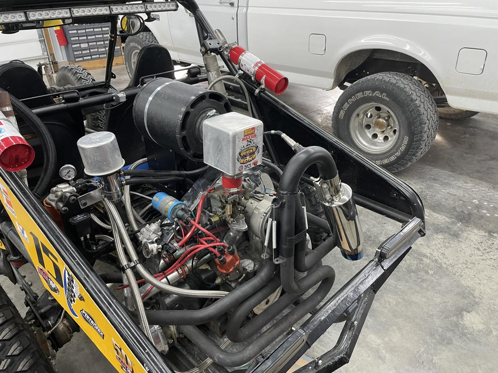

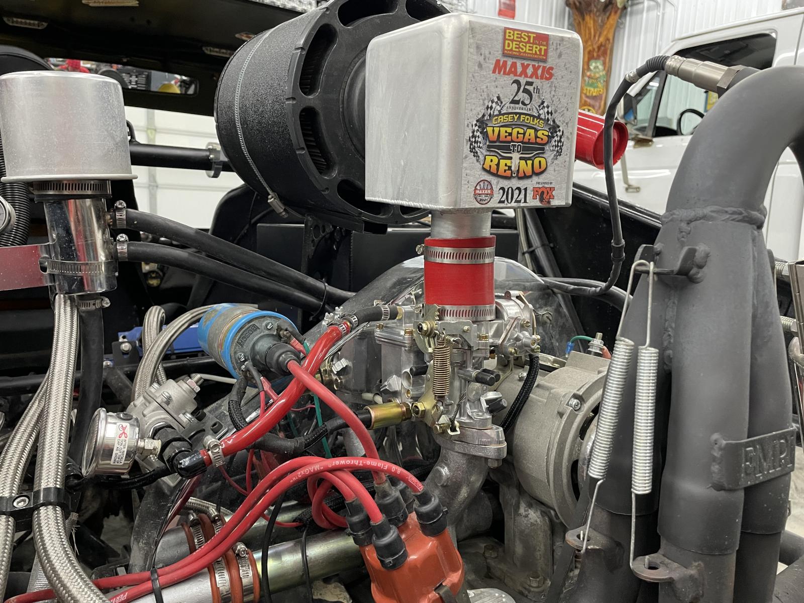

PostPosted: Wed May 21, 2025 6:18 am    Post subject: Re: Rod's Chenowth 4LWD Build Reply with quote
Snapped these last night while installing shocks on another vehicle.
DesertSasquatchXploration
Joined: April 16, 2021
Posts: 924
DesertSasquatchXploration is offline
PostPosted: Thu May 22, 2025 11:49 am    Post subject: Re: Rod's Chenowth 4LWD Build Reply with quote
That header is way overkill for a SP 1600. What kills me is why you want to fight what works your clearly a talented guy with a good shop fab up the heat risers and build a simple intake using hot air from under the cylinder's plastic flex tubing is 15$ on ebay. If it doesn't work Ill eat my shorts.
Key is to have downward travel Preload keep both wheels on the ground at all times once you lift a tire your DONE. Guys worry about clearance instead think of the opposite you want the suspension to drop that tire in the hole and keep you going. A spider for example they keep their body low but their legs can reach pretty far so they don't (bottom out)
racecougar
Joined: July 31, 2023
Posts: 242
Location: Imperial, MO
racecougar is offline
PostPosted: Thu May 22, 2025 12:02 pm    Post subject: Re: Rod's Chenowth 4LWD Build Reply with quote
There is plenty that the PO did that is overkill for a 1600 SP. I'm not spending money to step backwards though. The goal for now is to get it running properly, then decide if it's good enough, if it needs to be swapped, or if it needs to be sold.
What am I fighting exactly? If I end up keeping the single carb, I will likely install heat risers. I wanted to go dual carb to eliminate the need for all of that and pick up some power, but I flat out cannot justify spending $1500 on carbs for a 1600 SP.
Available time to mess with this thing is exceptionally limited; I have a number of other cars/projects to work on. Honestly, as it sits now, if I pulled the WBO2 off of it, I expect most folks would think the carb is dialed in well. I'm shooting for more accurate fueling than that though.

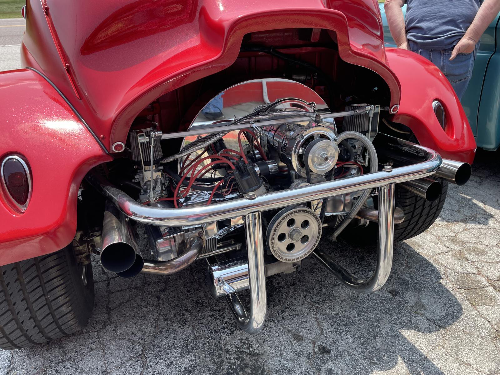

Ended up taking the Top Banana and the '65 C10 out to a car show, then lunch, today. It was about a 20 mile trip, including a little highway time, and it did great.
Saw this guy at the show:
