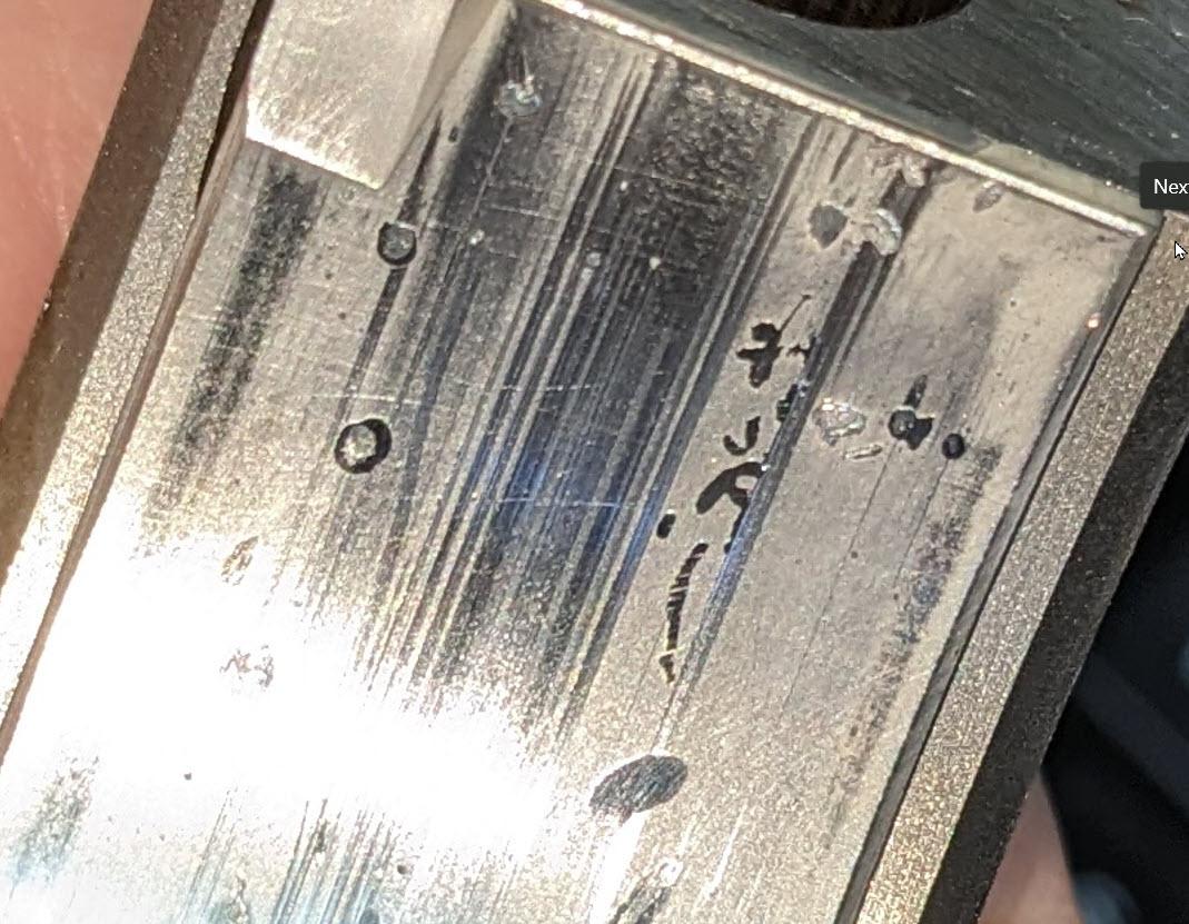

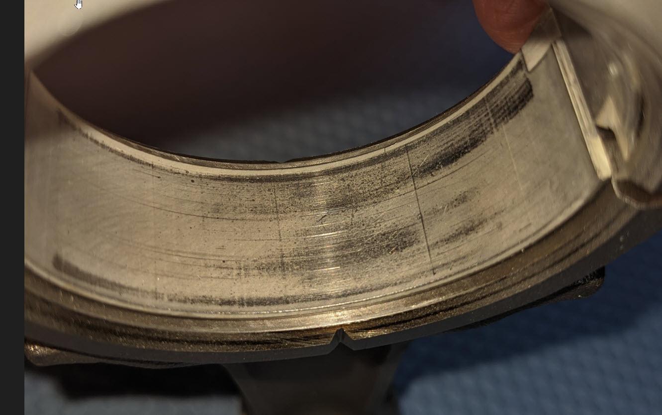

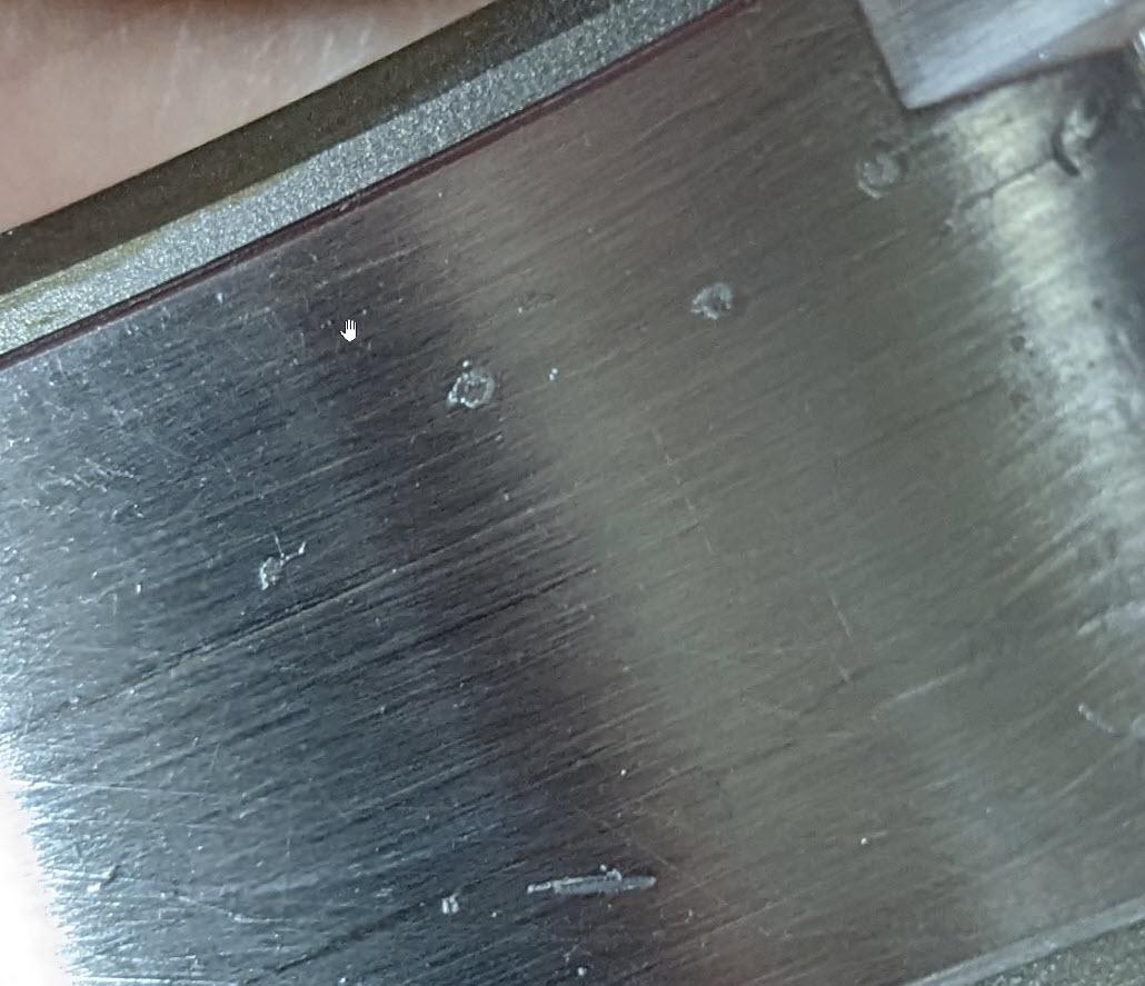

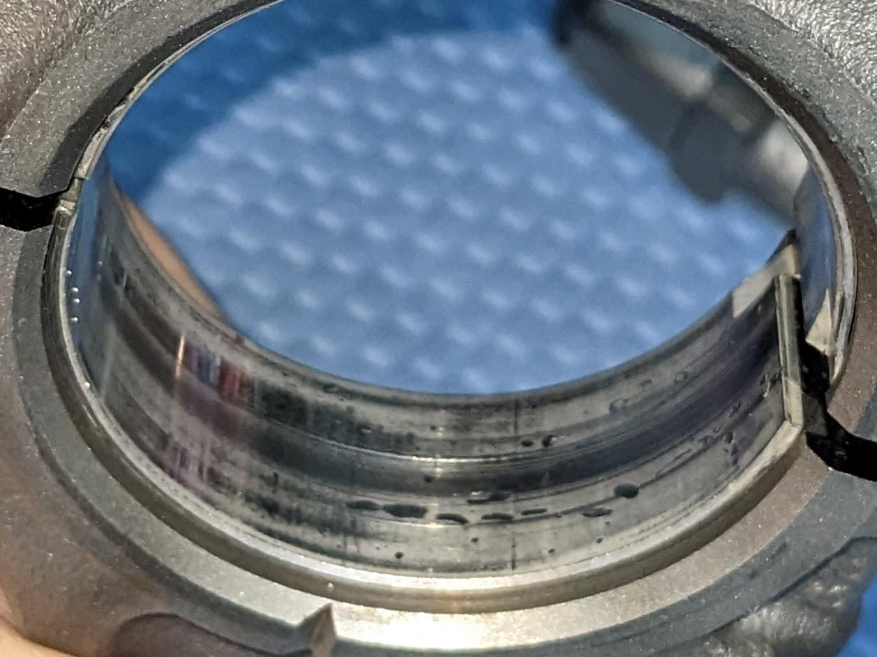

Mike - you are more than welcome to my old oil when I get time to check the production dates. Just pay for the shipping. I don't want an oxidized oil that froths up and sends a soup of air and oil to the bearings. We tossed enough connecting rods racing to know how expensive it is when it happens. Back in those days I was lucky to be able to afford an oil change for my bus, let alone buy a case and store the excess, so it never occurred to me oil had a finite shelf life - other than using it as bar chain oil or for squeaky hinges etc.. I bought it and used it right away. I just don't want something that is going to cause a bearing failure.
I kept asking myself when I tore this engine down in 2022 - what caused the spalling in new low mile bearings? It did not happen back with the 2010 engine and same components. It never happened on the type 1 motors - and I pushed that engine far harder than this type 4. Got my answer in Lake's video. Old frothy oil left over from the case I bought in 2009 - 2010. Those craters are hot spots where the froth did not properly lubricate. #3 rod was the worst. #2 and #3 rod journals are always where the air collects and ejects out in most crankshafts. By the time it gets to number 4 the air is usually gone. #2 is the worst but the oil is cooler. Some of the tiny pieces then carried down line to #4. I also don't want my lifters and cam lobes to wear excessively faster than they already do either.
These bearing had a 20 minute break in on them, and maybe 10 miles. I got my answer - they got hot from the frothy oil. Stupid ass me also tried your advice to overfill the sump to get better cooling but that would have made it worse because it churns the oil more. Must have looked like whipped egg whites in that case when the engine was running with 11 - 12 year old oil. I do not want any oil that is more than 3 - 5 years old and most of what I have is probably 8 - 12 years old.
#3 rod
#4 rod
