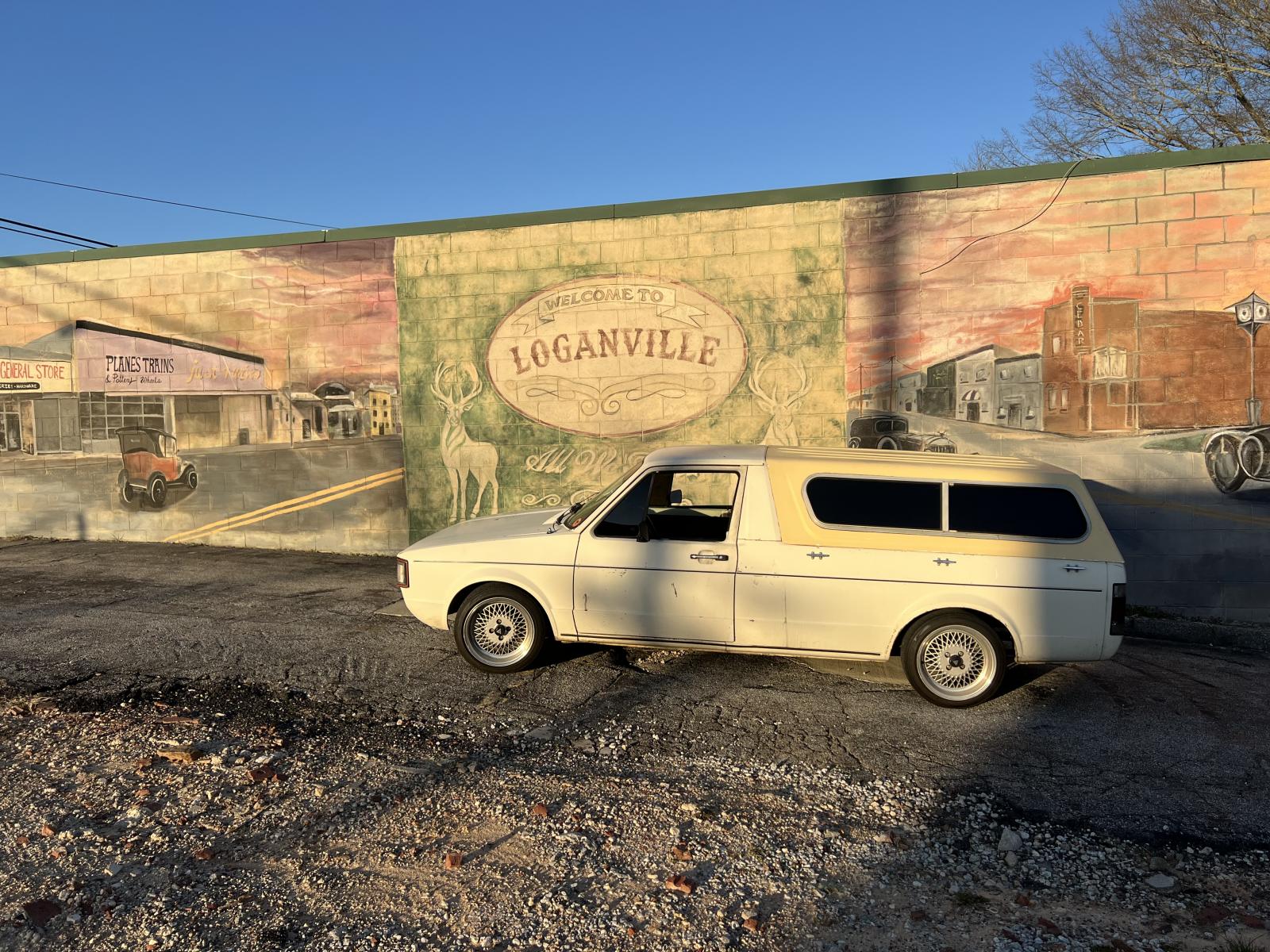

Picked up a little gem last night. An '81 Mk1 Pickup
1.6l turbo diesel with a host of mods already done to it. Ran great for the trip home, only complaint is that it is a little too low (for Atlanta highways)

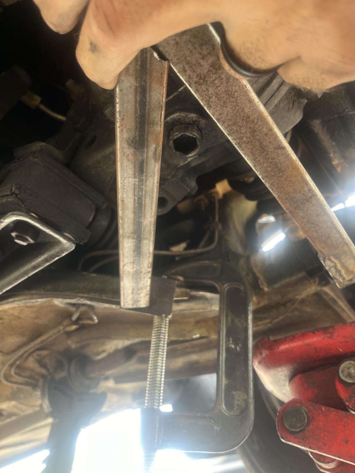

Start off by making a lower tie bar, mk1 chassis will eventually fracture the frame horns.
TDCTDI wrote:
I rubbed a couple minutes together & cut up a few more pieces of angle iron & clamped them to the chassis.
And then tacked the remainder of the square tubing in place.
After scrounging up another piece, I repeated the process on the other side & fused them together.
Once fully welded, I drilled holes through the chassis & brace & bolted it back in.
Once this is done, you could easily attach some tabs to accept a skid plate.
All you would need to do is get a piece of cardboard to bend into shape to go from the bottom of the bumper to the tie bar. Once you have determined where it needs to be bent, & what angles it needs to be bent at, you can take the cardboard to a sheet metal fabricator & have it bent up. Probably for around $100.

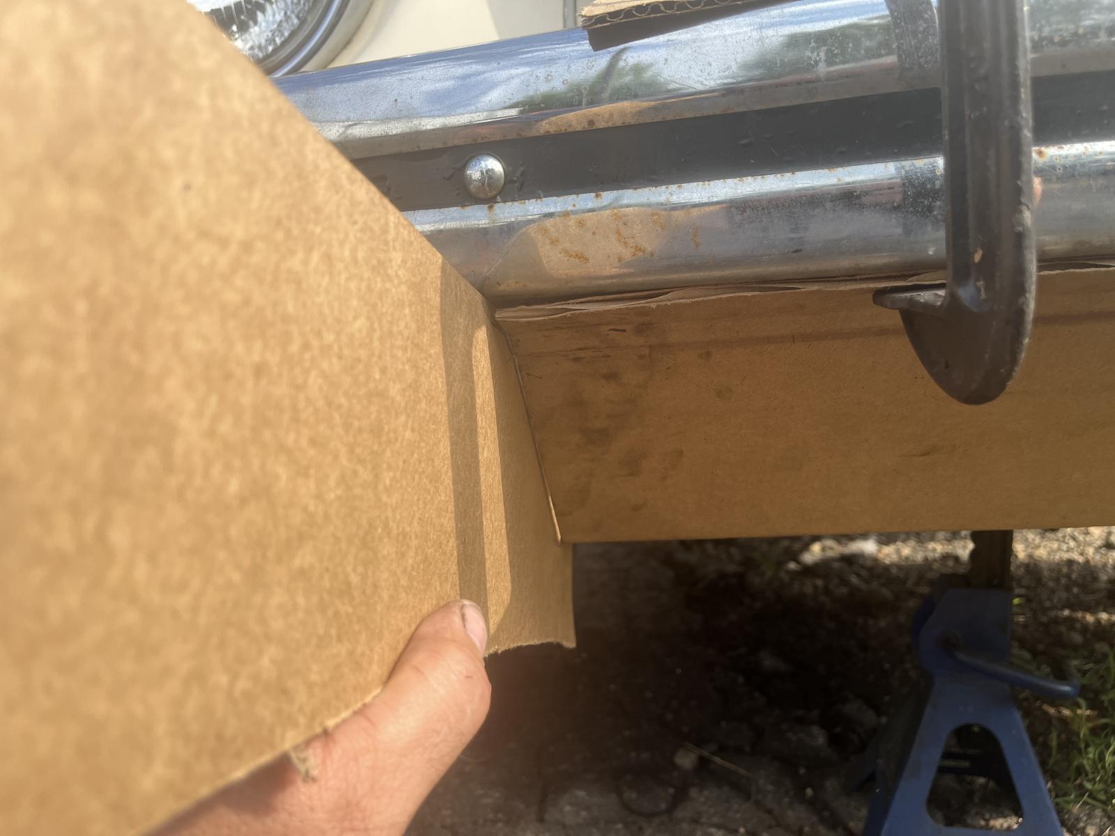

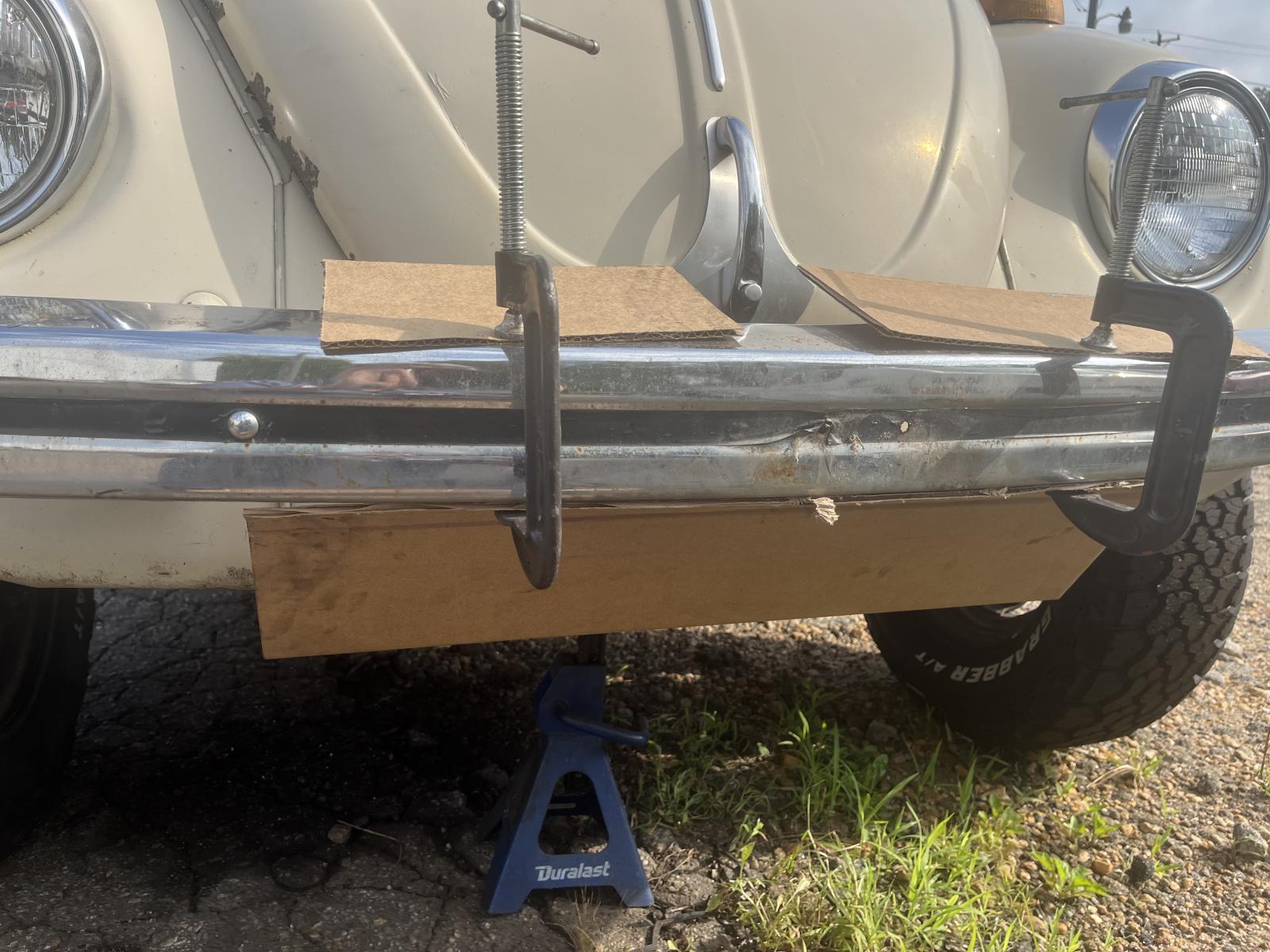

TDCTDI wrote:
Since I was at the front of the car, I decided to have some fun & design a skid plate.
I grabbed a box, whittled it down to an acceptable shape & began mapping out a final shape.
Once I got it to fit the way I wanted, I repositioned the clamps so I could make a template to measure the ideal angles in which to bend the skid plate.
After tracing the profile, I can now use my phone to determine the angles in which the skid plate needs to be bent.
Unfortunately, my local go-to fab shop is closed today.

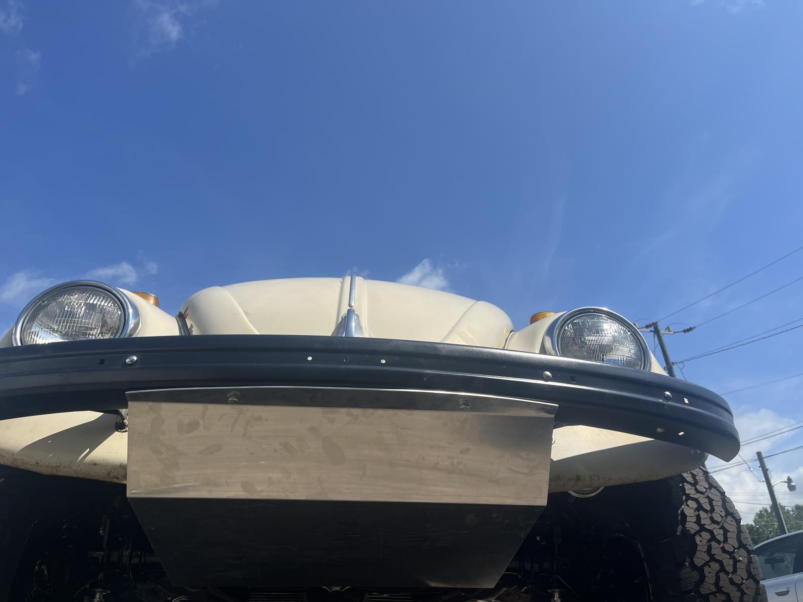

TDCTDI wrote:
…Nope, a for-reals chonk of al-yoo-min-i-yum.
Looking at the existing bumper, it was obviously showing it’s age with some dings, dents, & flaking chrome plating. Having previously owned a few of those ‘74 base beetles, you know, the bright colored ones with black trim, I decided to dig out a pair of bumpers that I had laying around from another project that a previous owner had prepped for paint.
After digging them out, I had to evict a few stowaways.
I then shot the front one with some satin black to begin it’s transformation into the automotive equivalent of a Goth kid. With the bumper in place, I clamped the new skid plate on & began punching holes.
And here it is bolted up…
