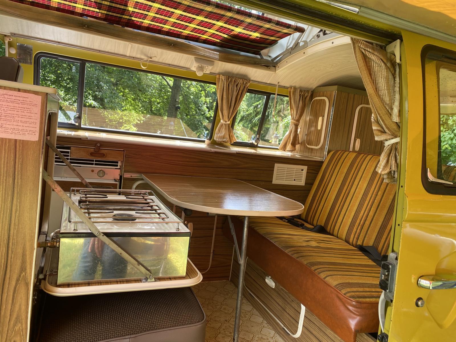

I’ve found another job to occupy me: recommissioning the Dometic 3-way fridge.
It has never (for us) worked with gas. When I did connect up a gas bottle there was an almighty stink and I discovered the gas line is disconnected from the fridge, but couldn’t see the end of the pipe.
The 12v input had a household mains cable attached to it but nothing on the end. When we were in Aus I wired on a cigarette lighter plug and ran it off the 12v socket at the dash. We had to disconnect manually every time we stopped and the plug melted after 11 weeks on the road!
On the plus side, the fridge did work on 240v. Yay!
I have found the fridge relay in the engine compartment, with no trigger wire and partially connected: to earth and a wire that disappeared into a bodywork channel along the side of the van.
I manhandled the fridge out of its slot and discovered two interesting things:
The hot wire and an earth cable that must have been the original 12v supply, cut and lying behind the fridge. Hopefully I can splice in enough cable to function.
Also, there is a steel braided gas line with a tapered thread end that will attach to the gas inlet. Unfortunately it looks very elderly and twisted, but hopefully I can get a replacement and maybe get it running on gas again. Our experience with our other Dormobile suggests gas power is effective and efficient when it works. We’ll see! I might have to post on an Aussie VW forum to find out their gas connector standards.
So, a work in progress!

I also wanted to check the gas supply of the stove, which uses a separate cylinder. It runs off direct high pressure LPG from a Primus cylinder. The cylinder connection seems to be Australia specific and the valve connects via a BSP fitting to high pressure hose. I’m not sure what the connection is called that connects to the stove itself, with the knurled collar, so I have asked on an Aussie FB forum (the Kombi club). I think it might be called a companion fitting, but I’m not sure!
The stove works fine, the hose is about 8 years old and looks in good condition, so I think I will leave it.

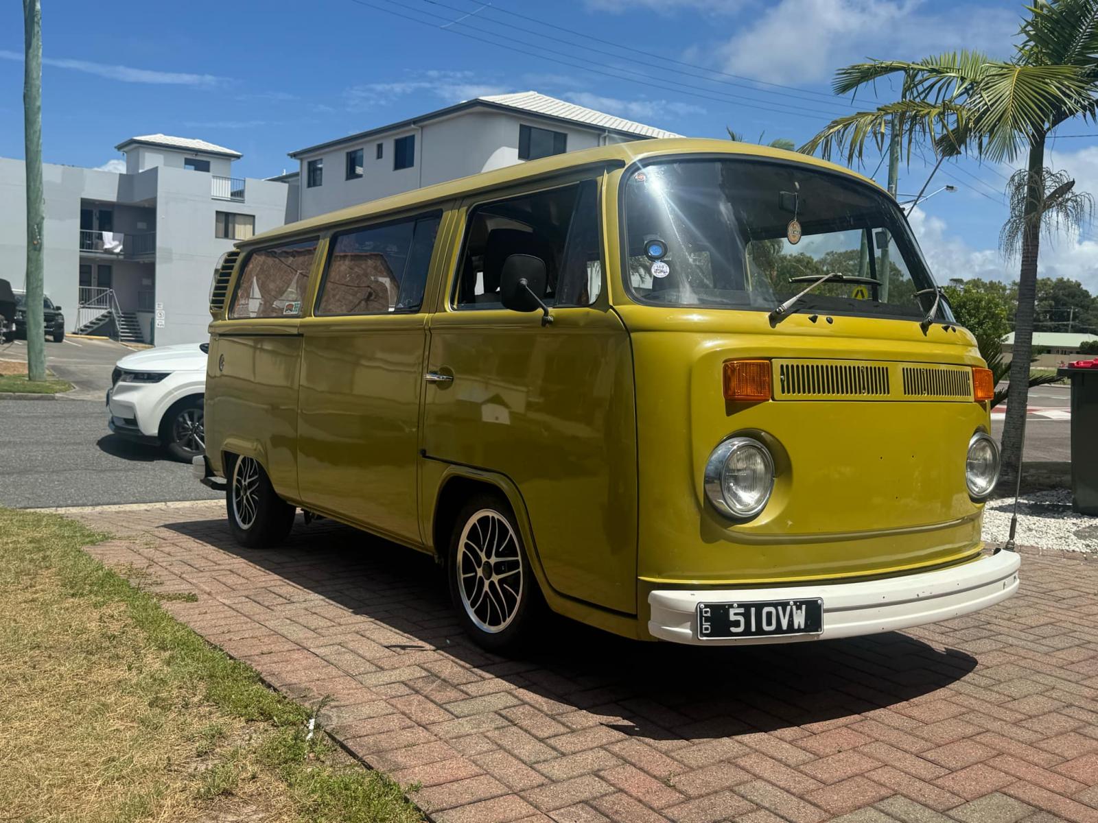

Ive recently aquired a 76 tintop in Martini olive, I wonder how far apart they are off the production line

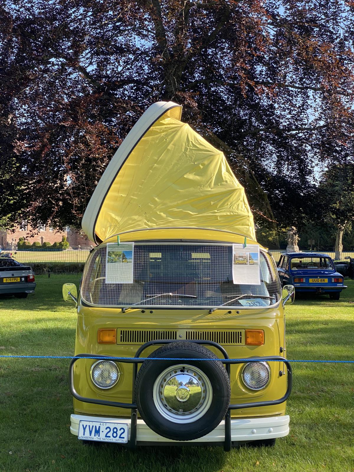

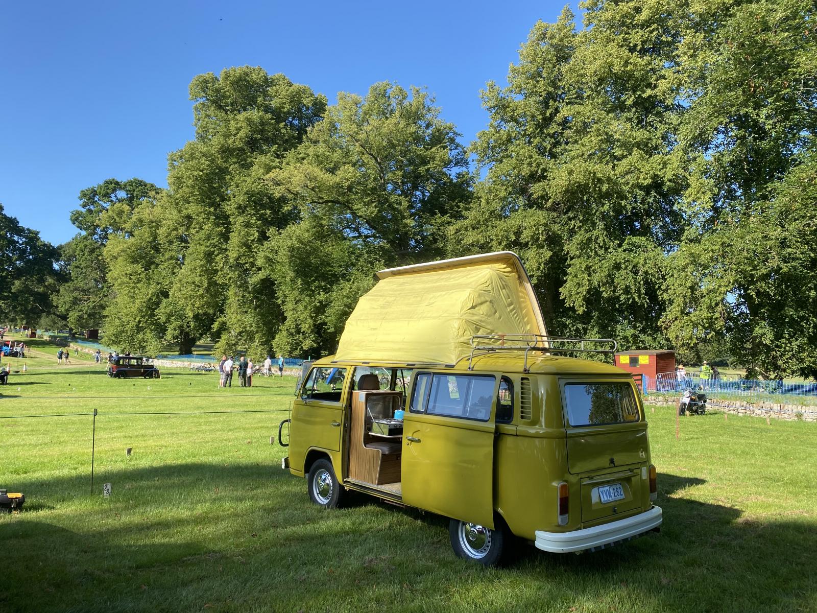

We have had a great summer of weather so far here in Scotland. We are making the most of it and taking Olive to various classic car and VW gatherings.
One local one is an all day scenic drive, with a car show at the end. I wanted to take Olive and the Karmann Ghia and so we enlisted Shona’s brother to drive Olive for the day and had a happy jaunt around the countryside, finishing at the stately home of ‘His Grace the Earl of Hamilton’ (no less!), Lennoxlove House.
The good news was that the Ghia and Olive won ‘Best in Class’ and the unexpected surprise was that Olive won ‘Best in Show’ which was amazing! Everyone had been very interested to hear the stories of her previous owner, the Australian road trip and the restoration to a preserved ‘patinated’ original state.
Delighted!
(Now we have the trophy in our kitchen again for the year-the Ghia won it two years ago, very proud of them both).
